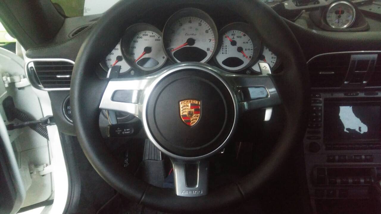

997.2 on 997.1

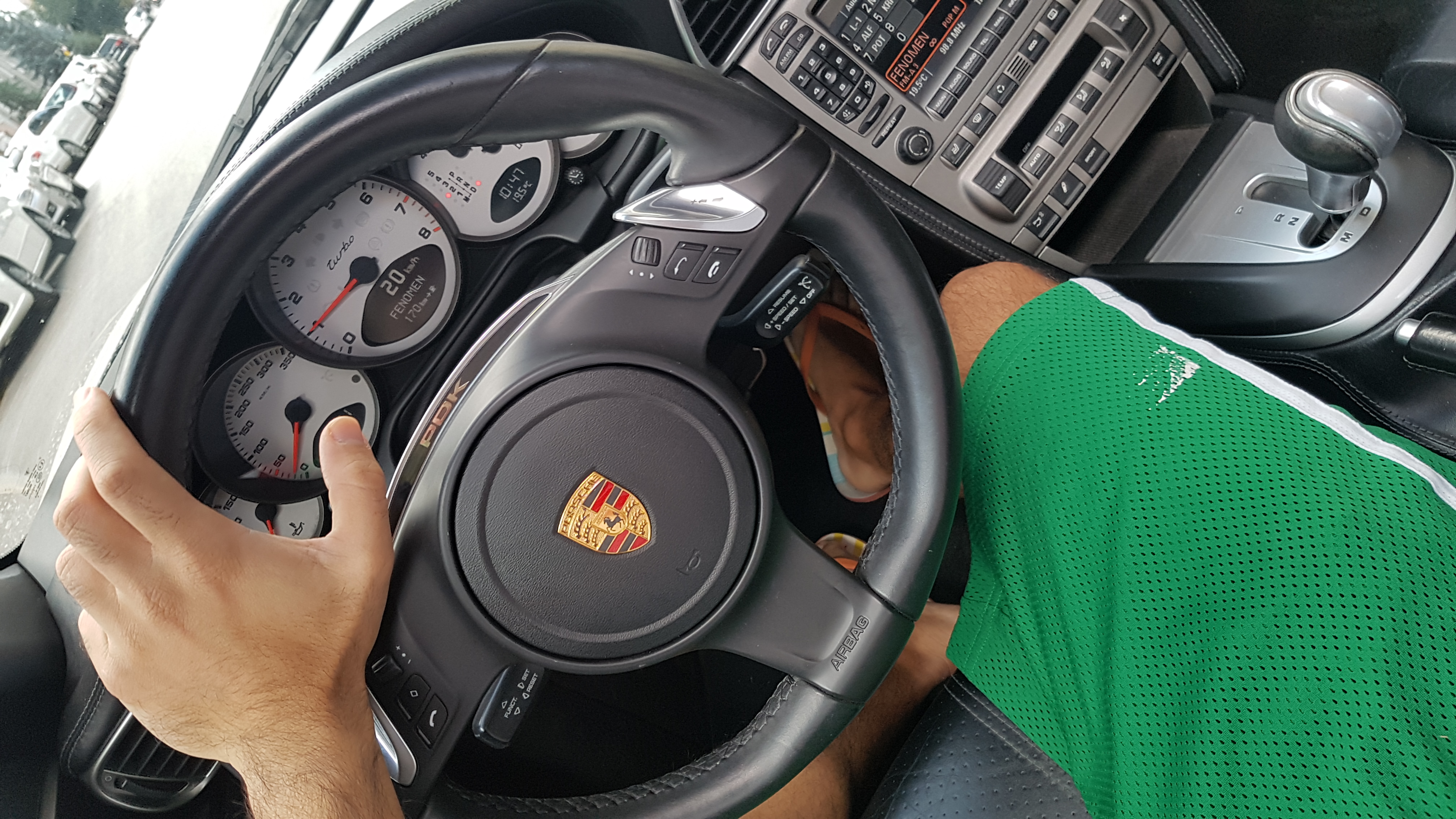

im planning to change to thia design...
https://www.6speedonline.com/forums/...1&d=1506762920

Its plug and play. Only the steering controller needs to be programmed by the dealer

Question.
I switched from the standard triangle wheel with multi-function to a 997.1 Sport wheel a couple years ago (manual trans car),.. and everything was just plug and play.
Then yesterday I switched to a 997.2 Sport manual wheel like in the pic above from Derrick,... The horn works,.. but I have a red airbag light on the dash.
What's the solution?
