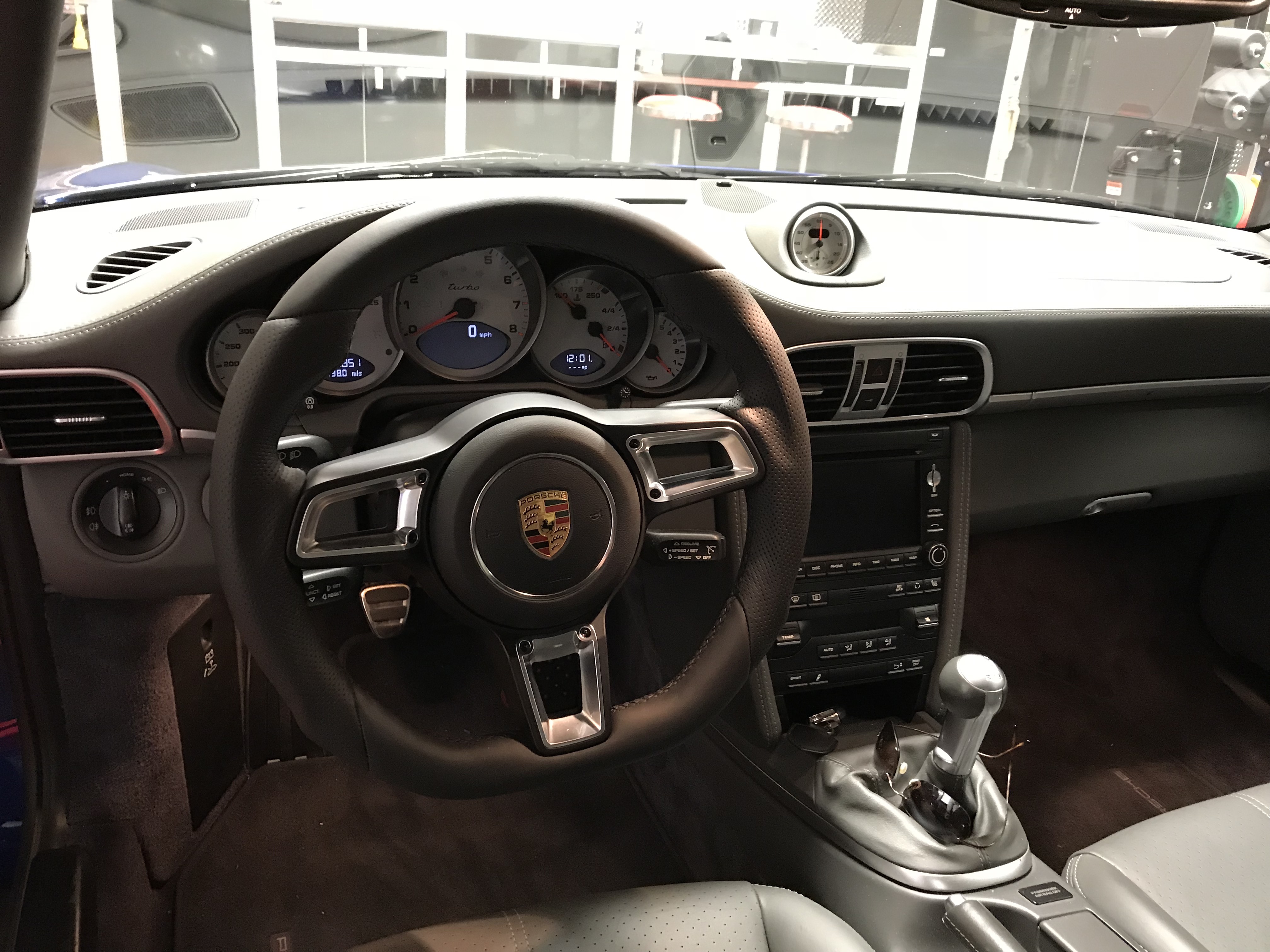

For you guys that are wondering if the new 991 steering wheels will work on our 997s the answer is plug and play without the steering wheel controls and on mine an 09' the horn works as well. I have this same wheel in my other vehicles and I like it.

I concur. Mine was plug and play...
