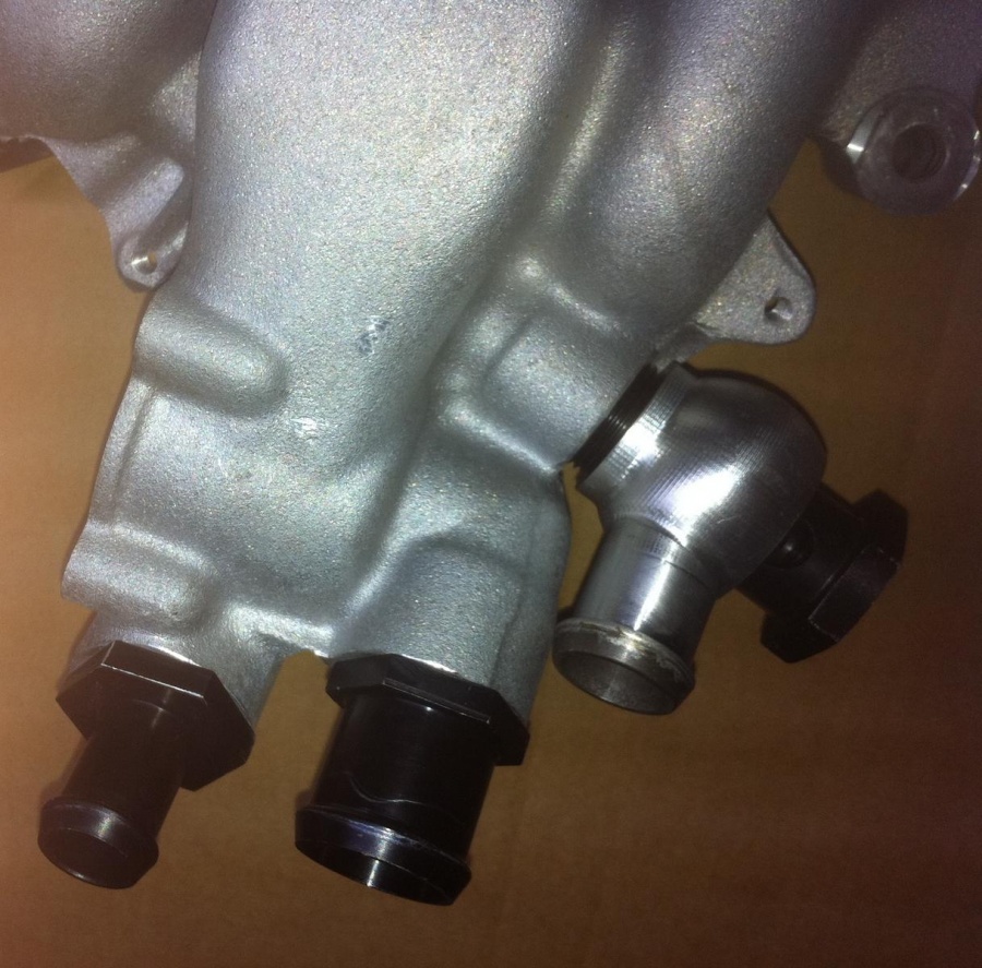

Does your tech have photos of the component that failed? Is it the hose or the metal adapter? If it is the hose itself, this may be the first reported case of the problem. If it is the adapter that has worked free from weakened adhesive, replacing it with another OEM part will not solve the problem as it will happen again.
This is a problem with the adhesive that Porsche chose to use to hold the adapter to the hose.
There are two solutions - either pin the adapter (ie Sharkwerks solution)
or weld it:
I also understand the GT3R/RS and RSRs use threaded pipes:
Any solution that only addresses the adapter that has worked itself out is inadequate. There are multiple sites where this could happen. Likewise, replacing the part with another OEM unit is also inadequate - the design is flawed. If you have a good relationship with your dealership, ask them to help cover the costs...this is a very well known problem and has been documented in the past by hundreds of owners. I'm actually surprised no one has challenged Porsche in litigation. A coolant dump on the freeway or track could lead to a fatal accident.
I would take photos of the adapter that has popped out - send it to the company that covers your extended warranty. As I stated earlier - if this is a true hose failure, it would be the first that I have heard of. If this is similar to other events - it is an adhesive failure, and may be covered by your extended warranty (and should not be fixed with replacing the OEM part - having it welded or pinned will permanently fix the problem.)
Read this thread completely - it is very informative and links other threads and sites on solutions.
