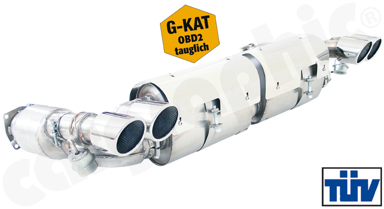

porscheboy997 we are the North American Distributor for Cargraphics Exhaust. We offer Mufflers with Flaps, Racing Manifolds, Cat Pipes with 200Cell or 100Cell or No Cats. PM me in you want Special 6speed Pricing. This picture below is for a 997TT
