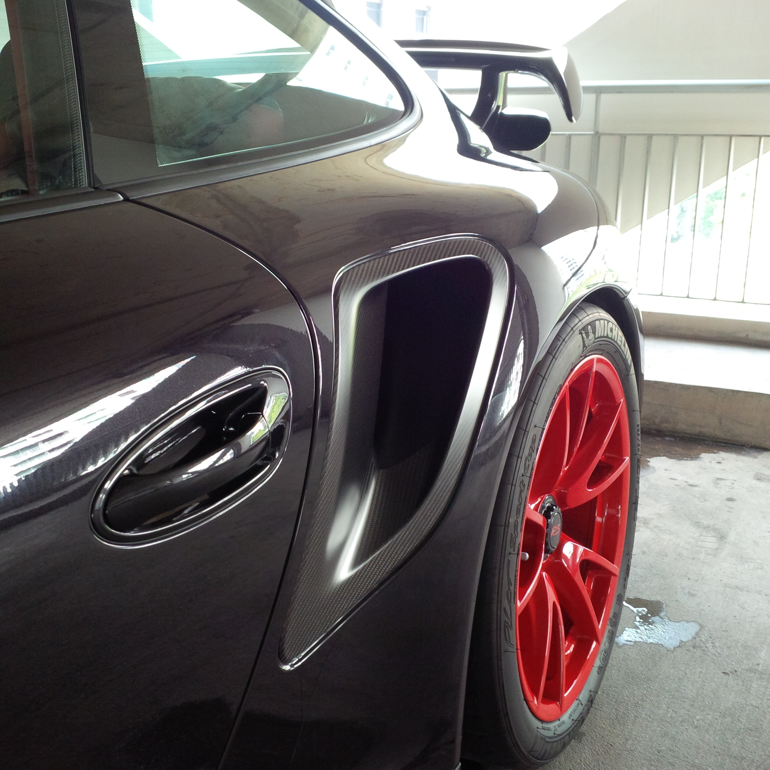

Problem please help, GT2RS conversion - SpecG 997.2 Turbo S

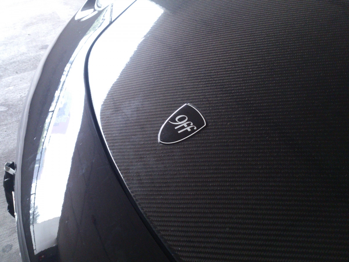

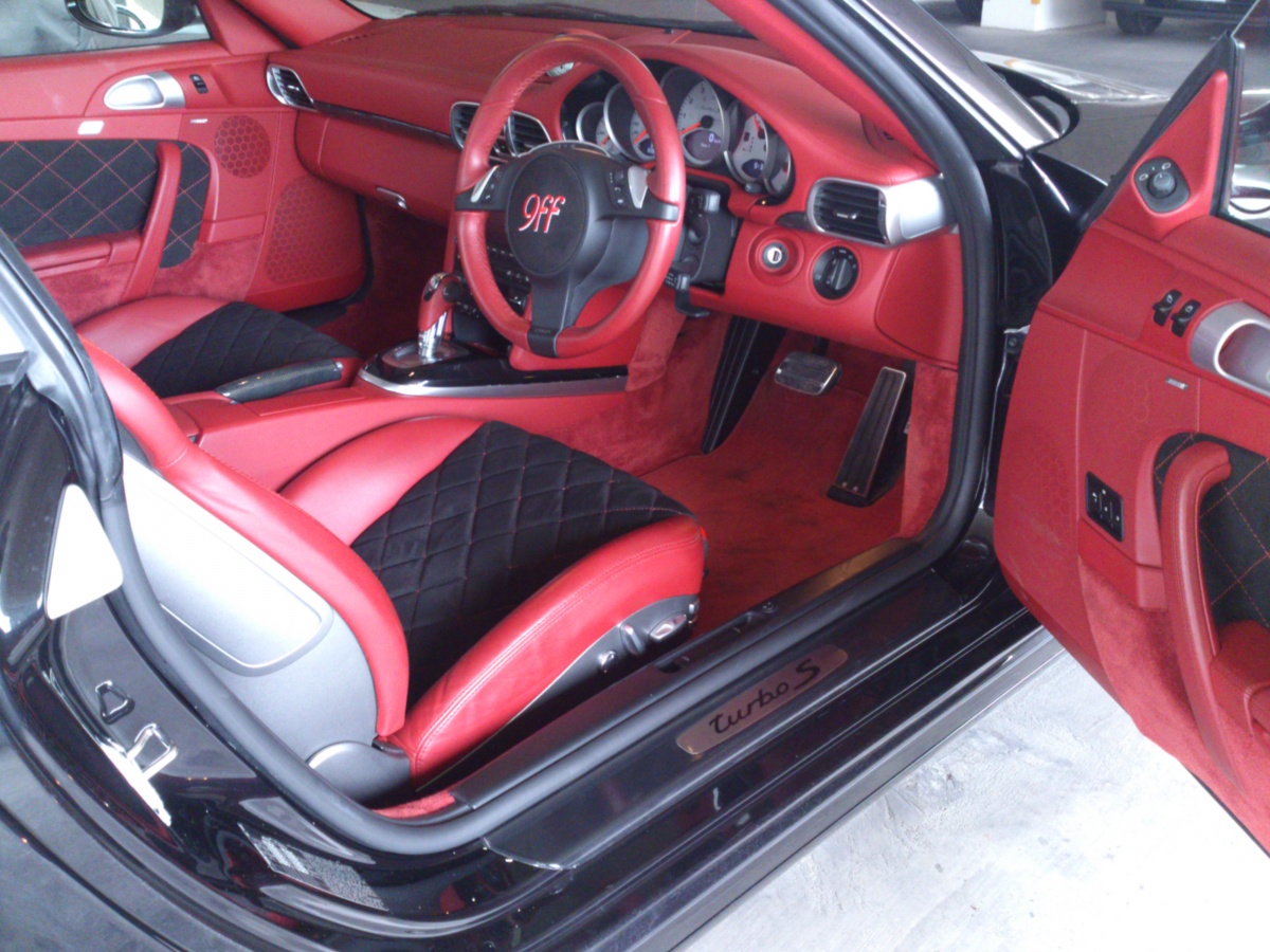

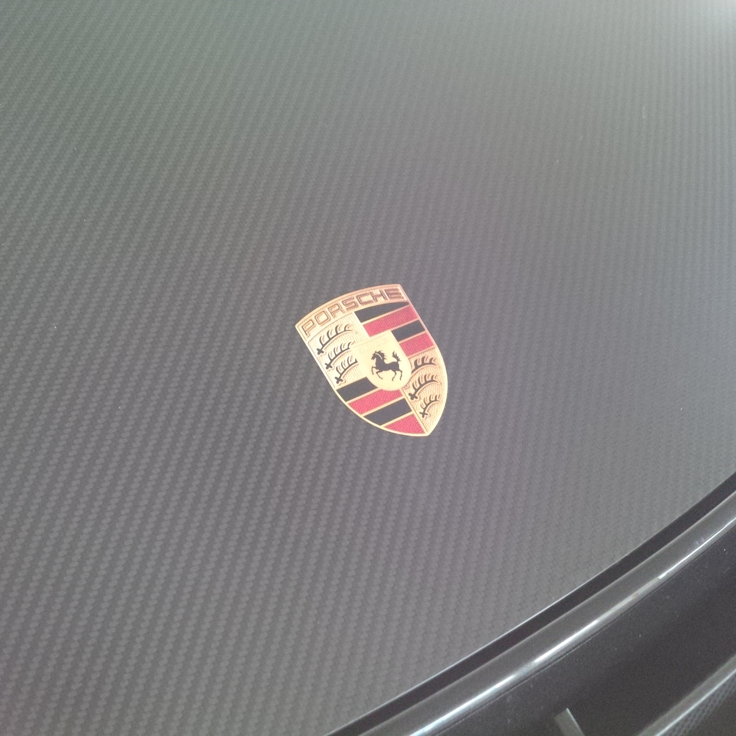

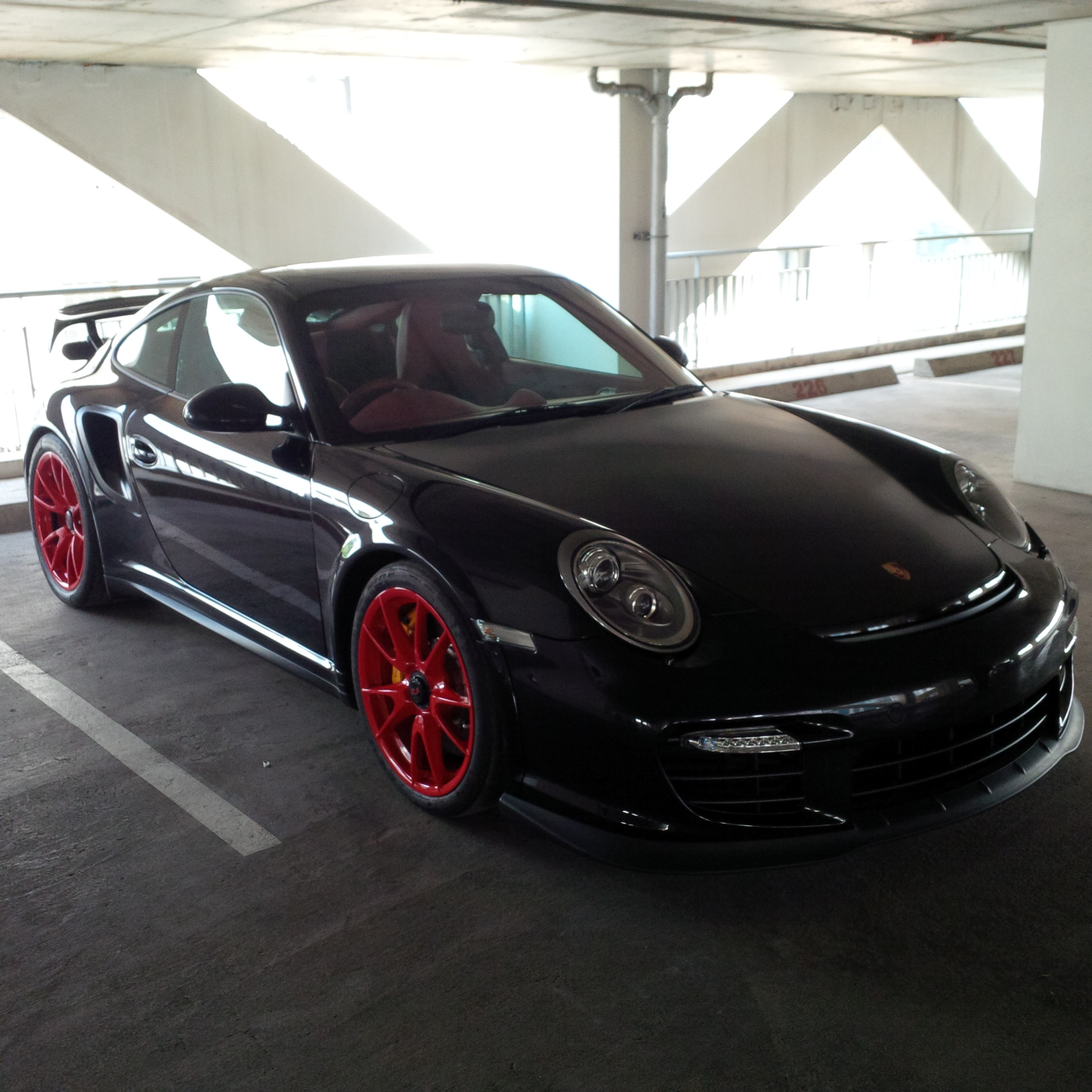

Hi guys,
Just joined the community
Also just picked up a 997.2 Turbo S with 9ff mods..1800miles. She was all wrapped in matt white before and I just stripped her naked to her skin, washed her and..she so smooth and fresh.
For now, I'm planning to put the stock front and rear bumpers back on..and also center lock RS wheels I think.
Here some photos of her

Gorgeous interior. More pics please.

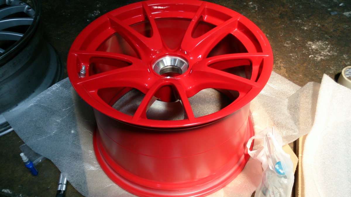

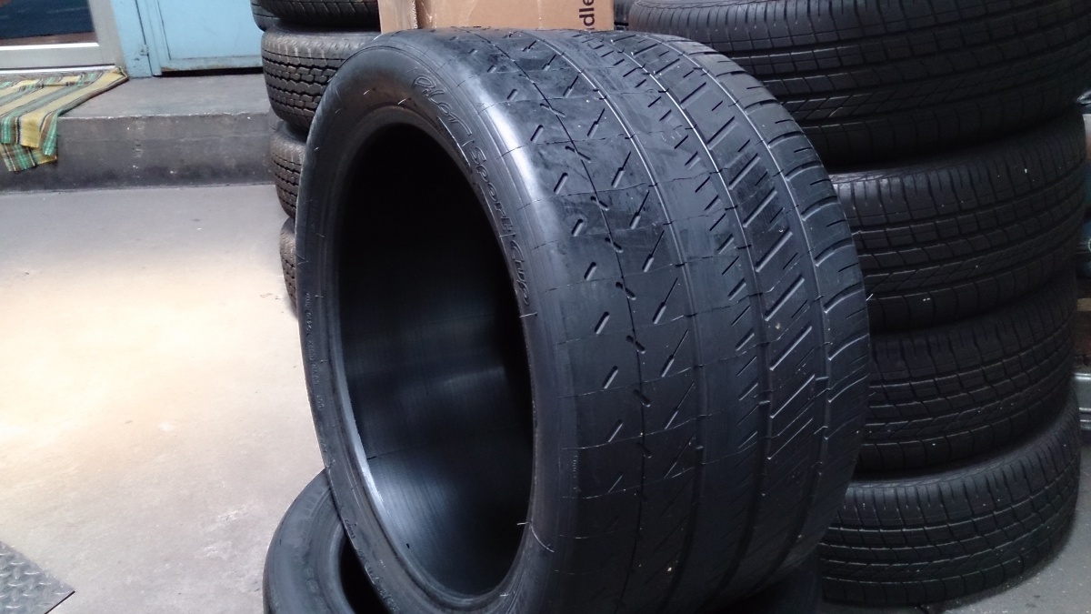

Got the wheels, center lock kit (black), and the tires.. these are GT2RS wheels and tires specification. I am doing the complete GT2RS conversion with all factory parts.
The tires are Michelin Pilot Sport Cup
245/35 19 25.8in
325/30 19 26.7in
I am not sure if the tire diameter from the GT2RS will cause any problems to the turbo 4wd system.. if anyone has any experience please lend me a hand.
EDIT -
Ok i just found out that the stock Turbo tires are
235/35 19 25.5in and 305/30 19 26.3in which makes them 0.8in diff. and the GT2RS has 0.9in diff.. so I think I might get away with it.

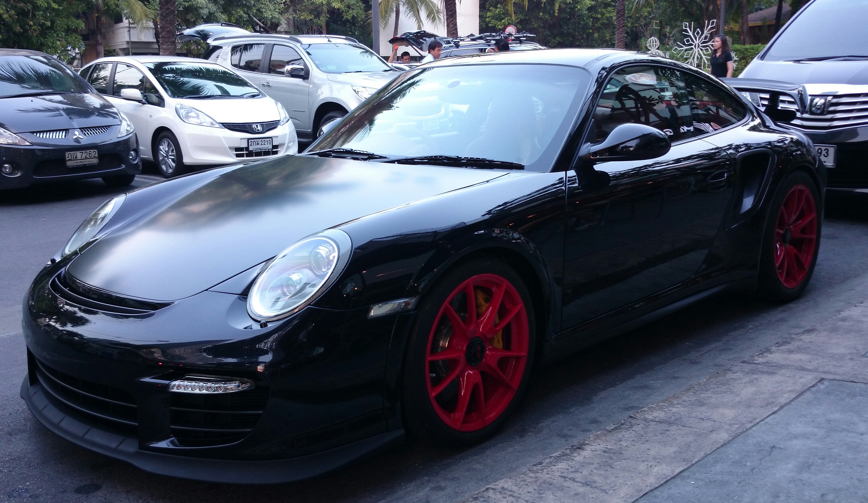

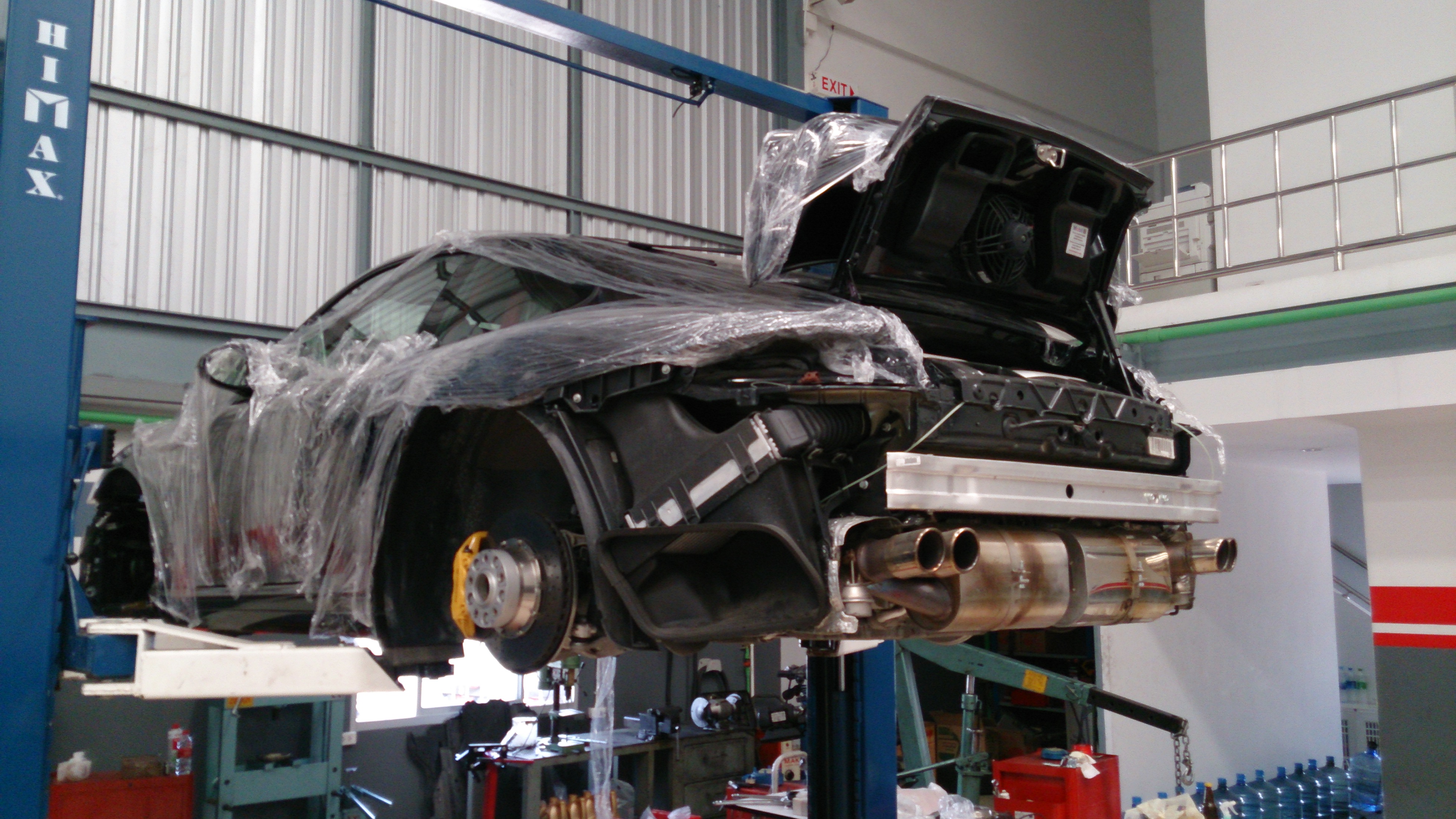

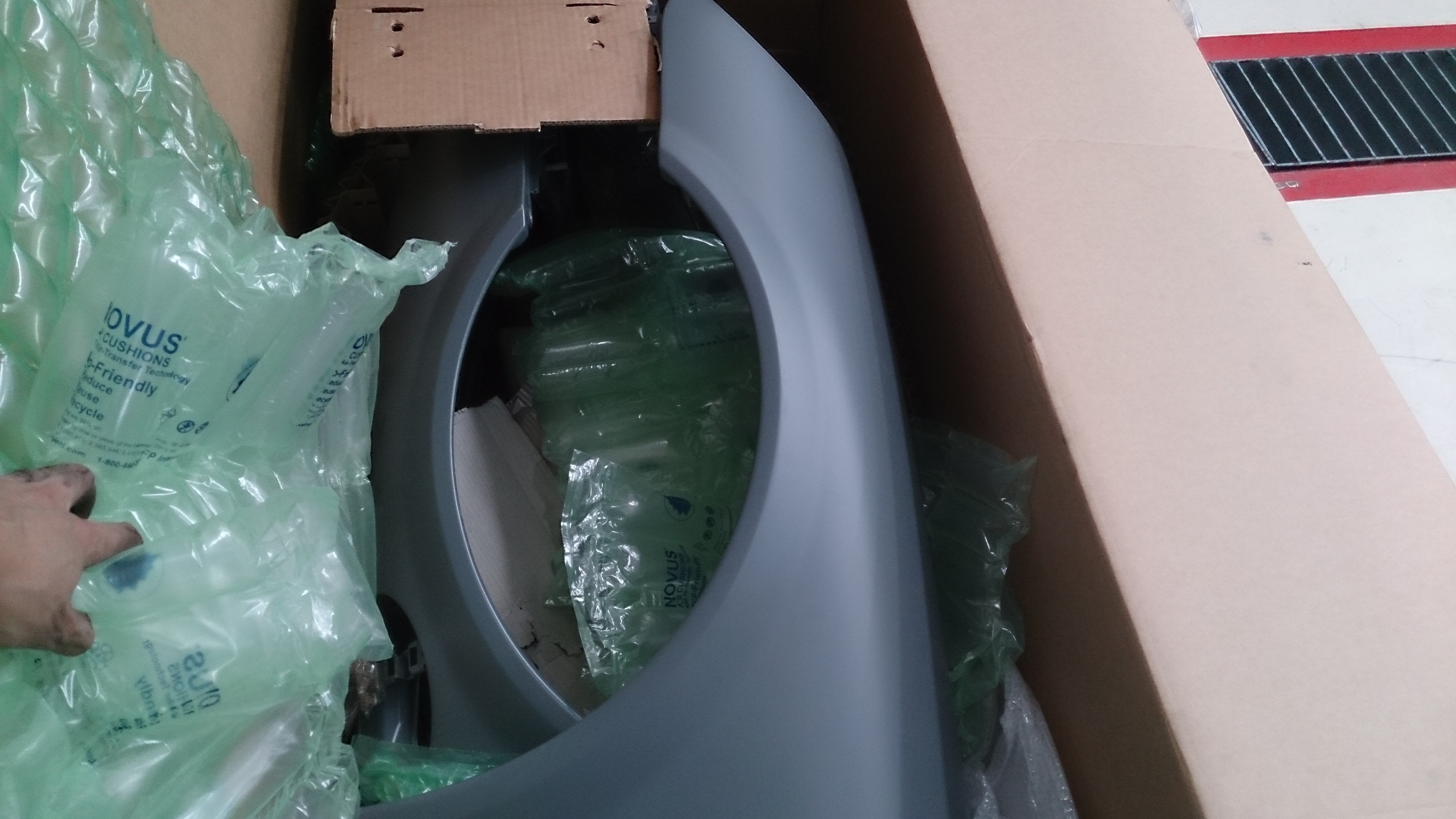

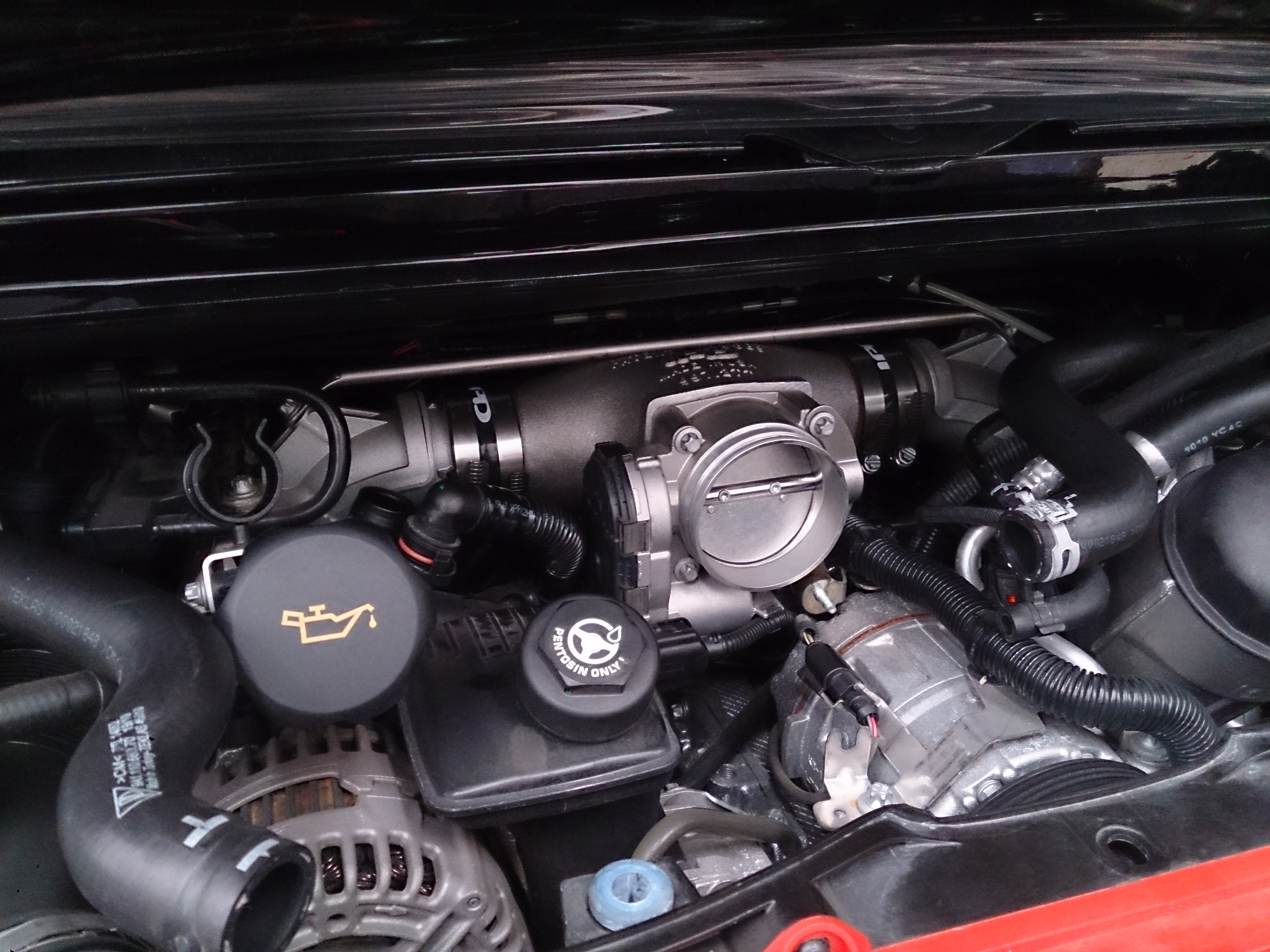

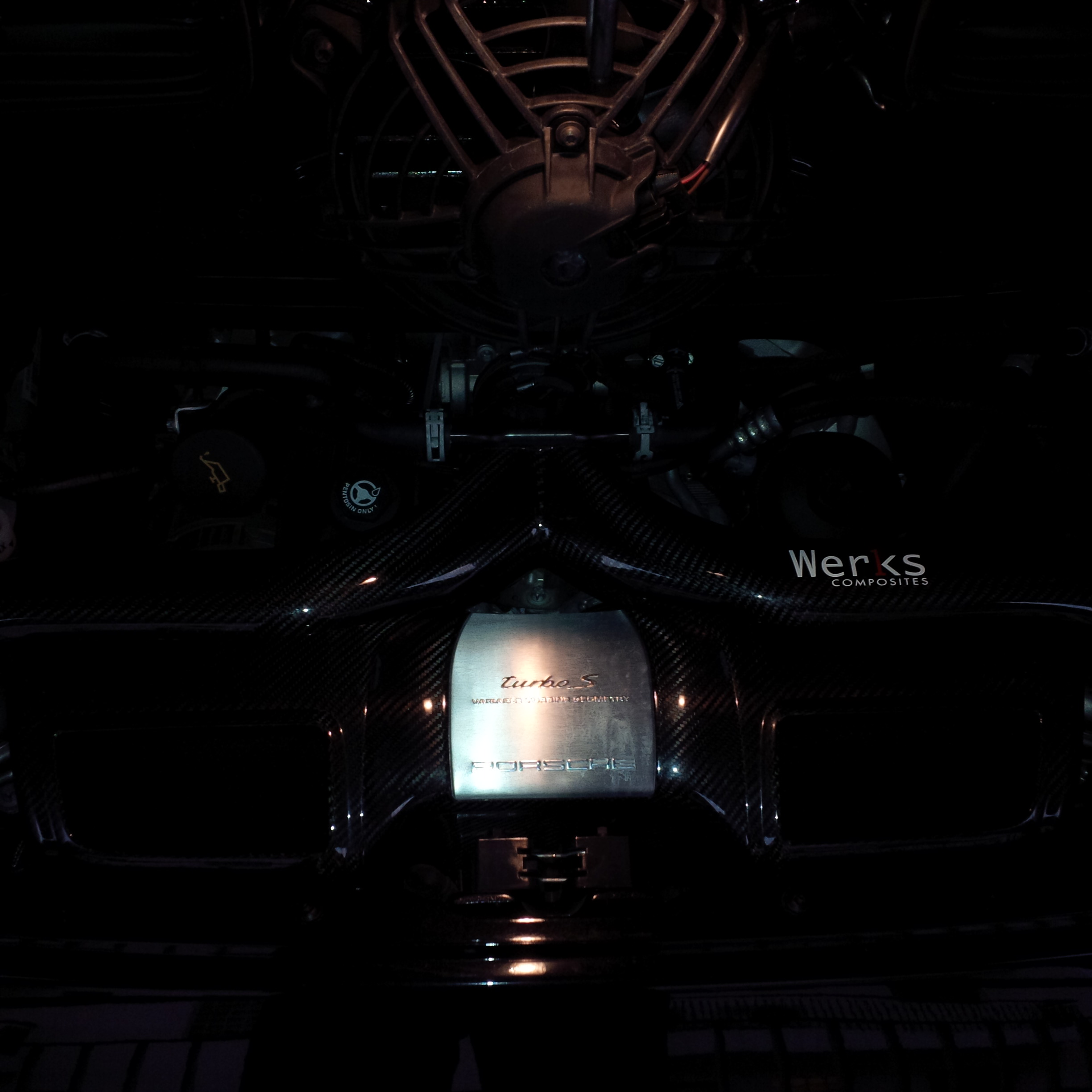

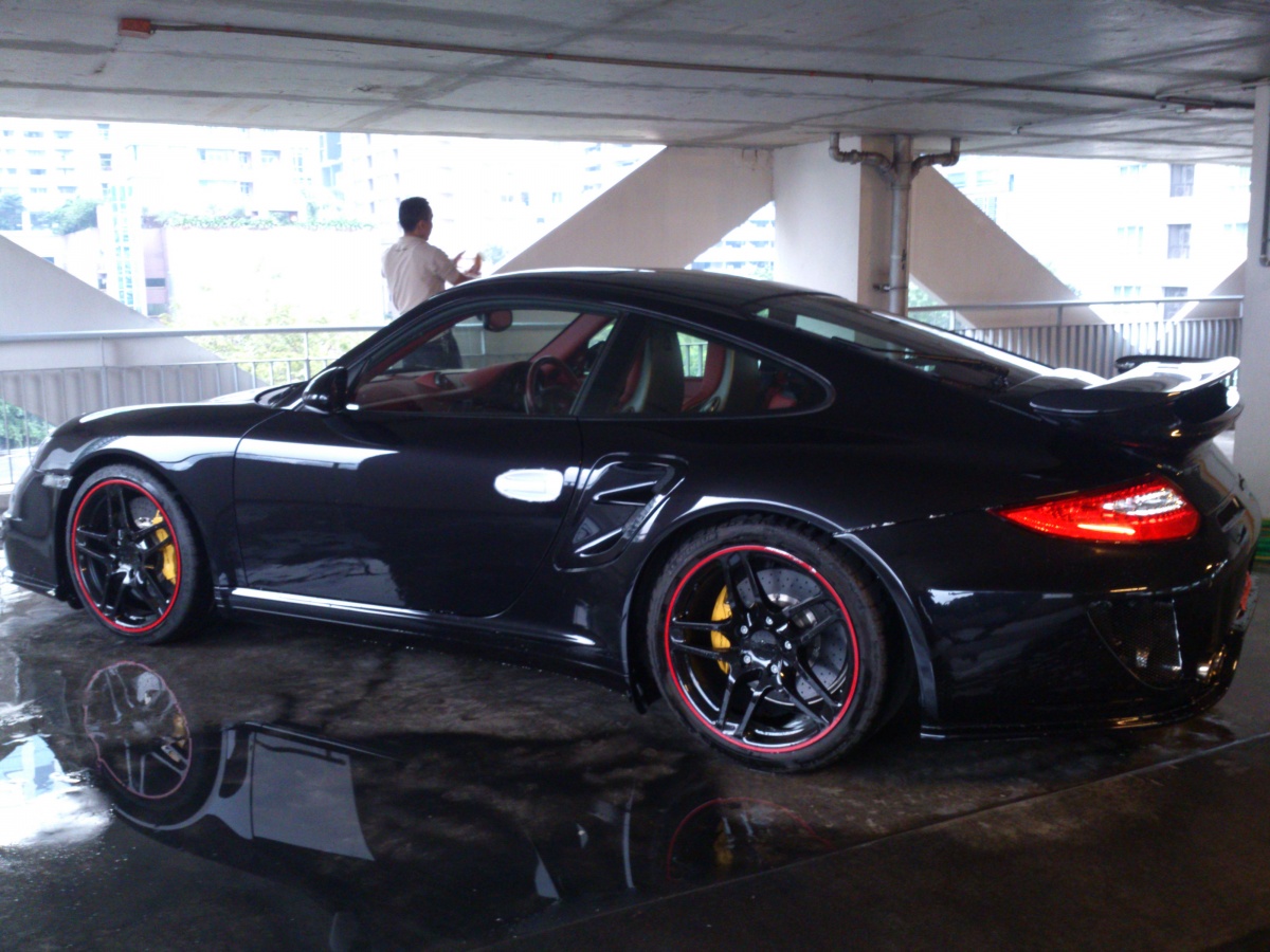

Sorry for no updates on this thread as I have been busy with real life work. I am glad to say that the project has been completed.
I just wanted to share the journey and the outcome.
Final Spec (weight reduction -30kg) -
997.2 Turbo S PDK
9ff ECU 640hp
9ff Exhaust Manifold
9ff Turbos
9ff Suspension with Lift System (+3kg)
Akrapovic Exhaust 100cell Cat (-17kg)
IPD Plenum
IPD Y Pipe (previous Werks Carbon pipe broke up at seam) (+1kg)
GT2RS Carbon Front Fenders (-10kg)
GT2RS Carbon Rear Deck and Wing (-3kg)
GT2RS Carbon Bonnet (-4kg)
GT2RS F/R Bumper
GT2RS Front Radiator and Ducts
GT2RS Wheels and Tires

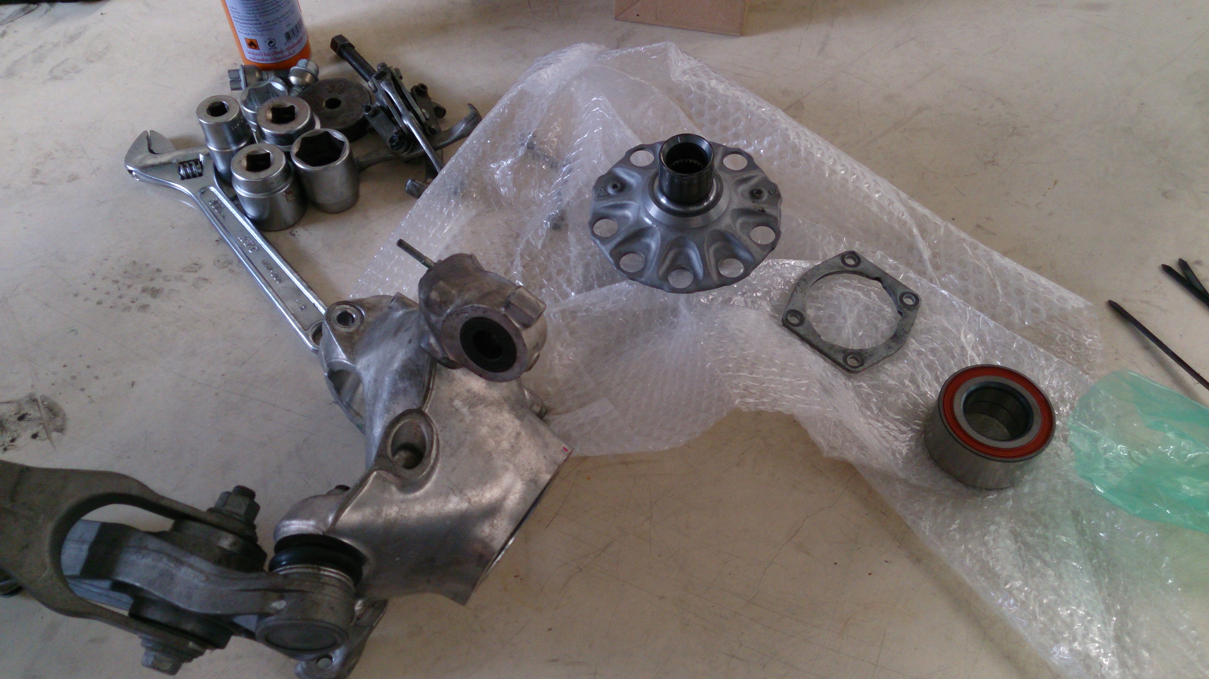

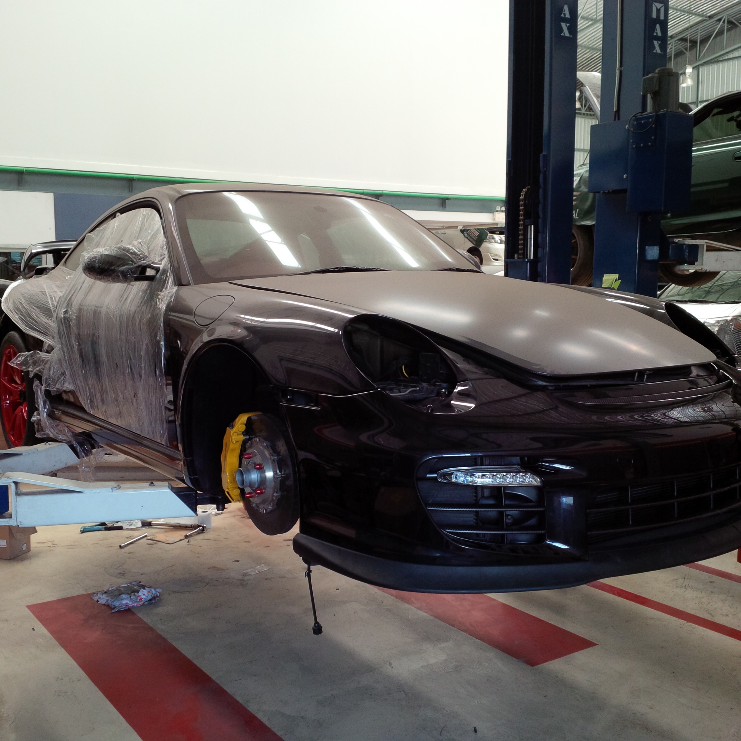

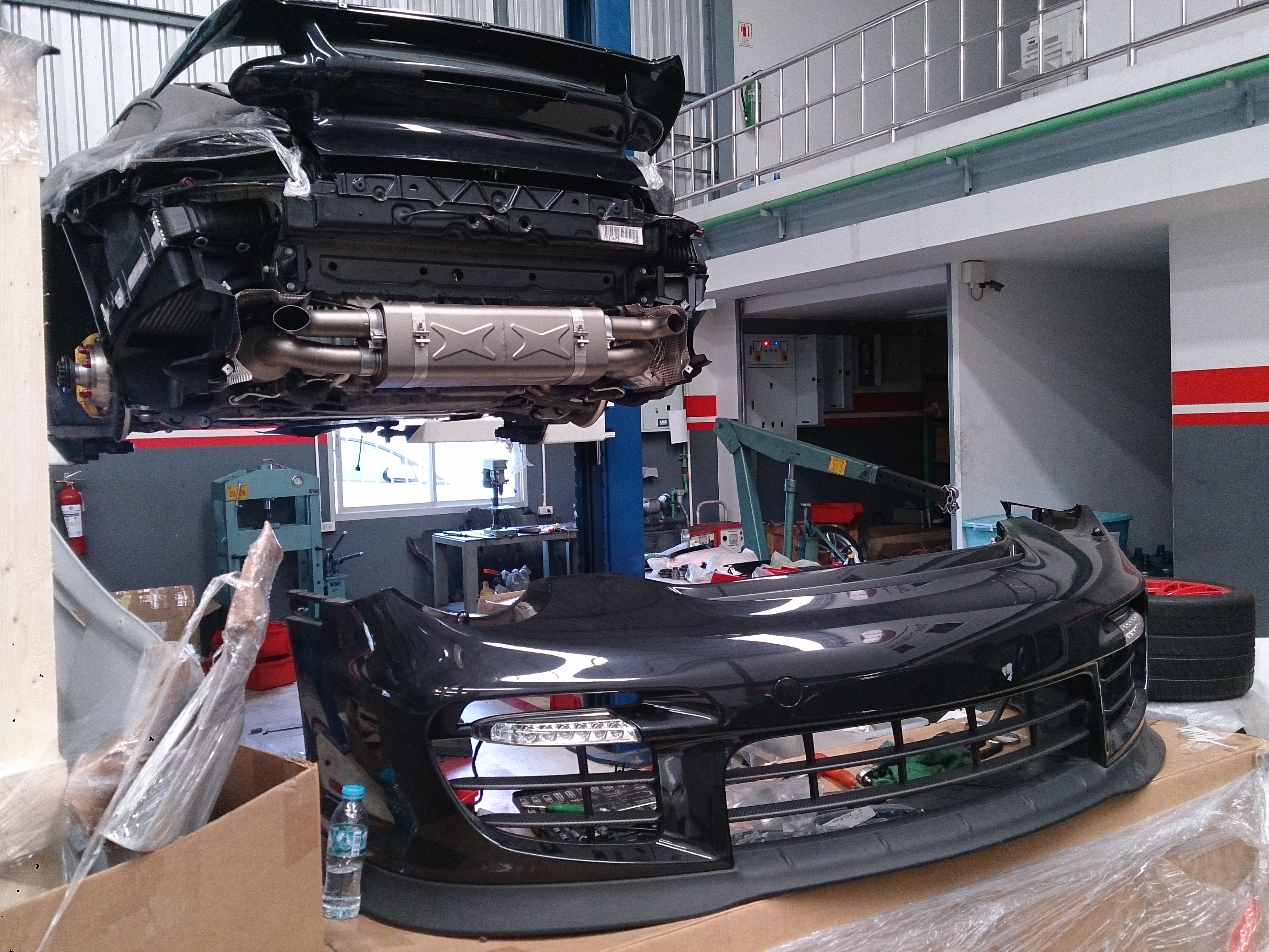

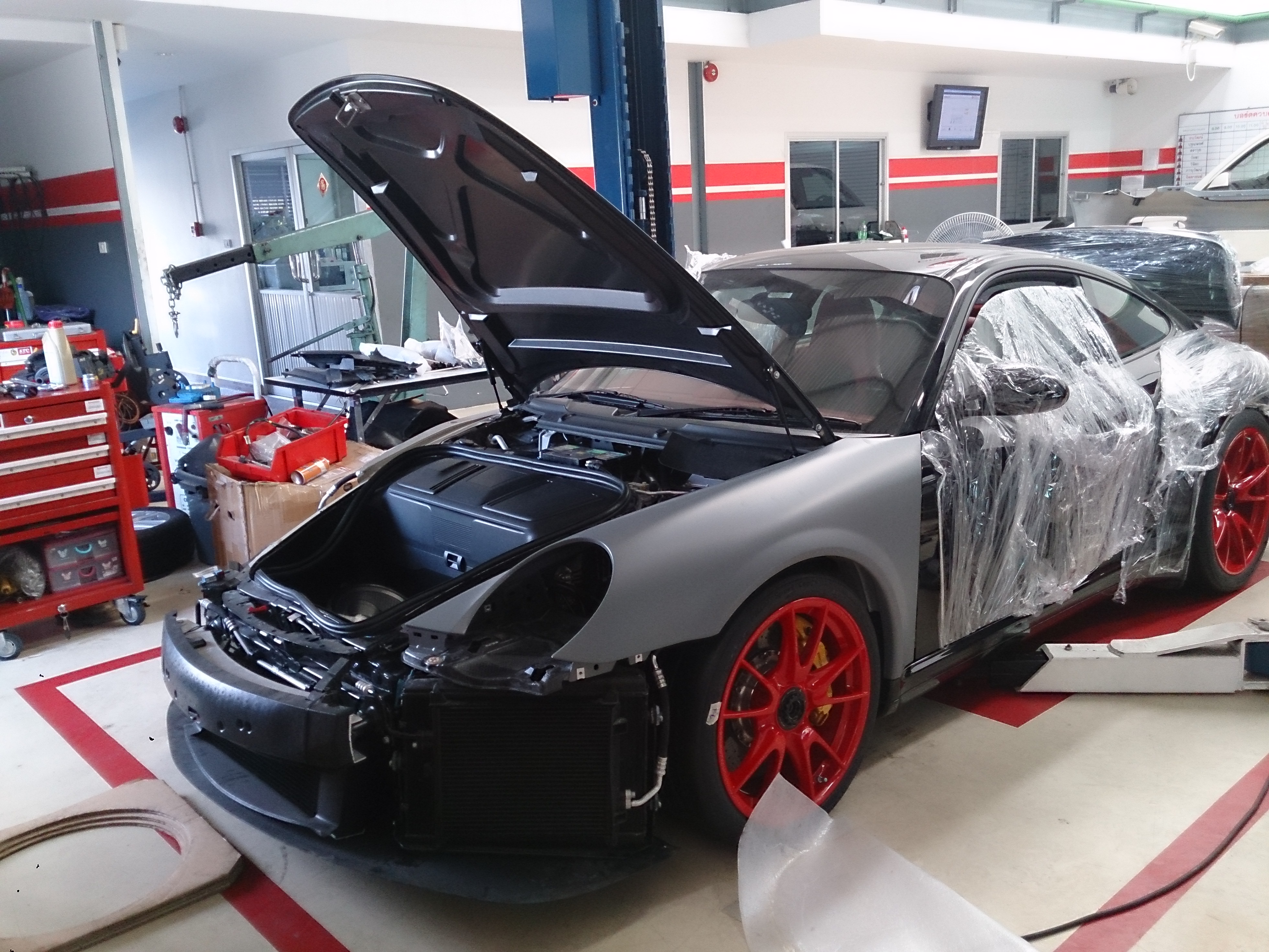

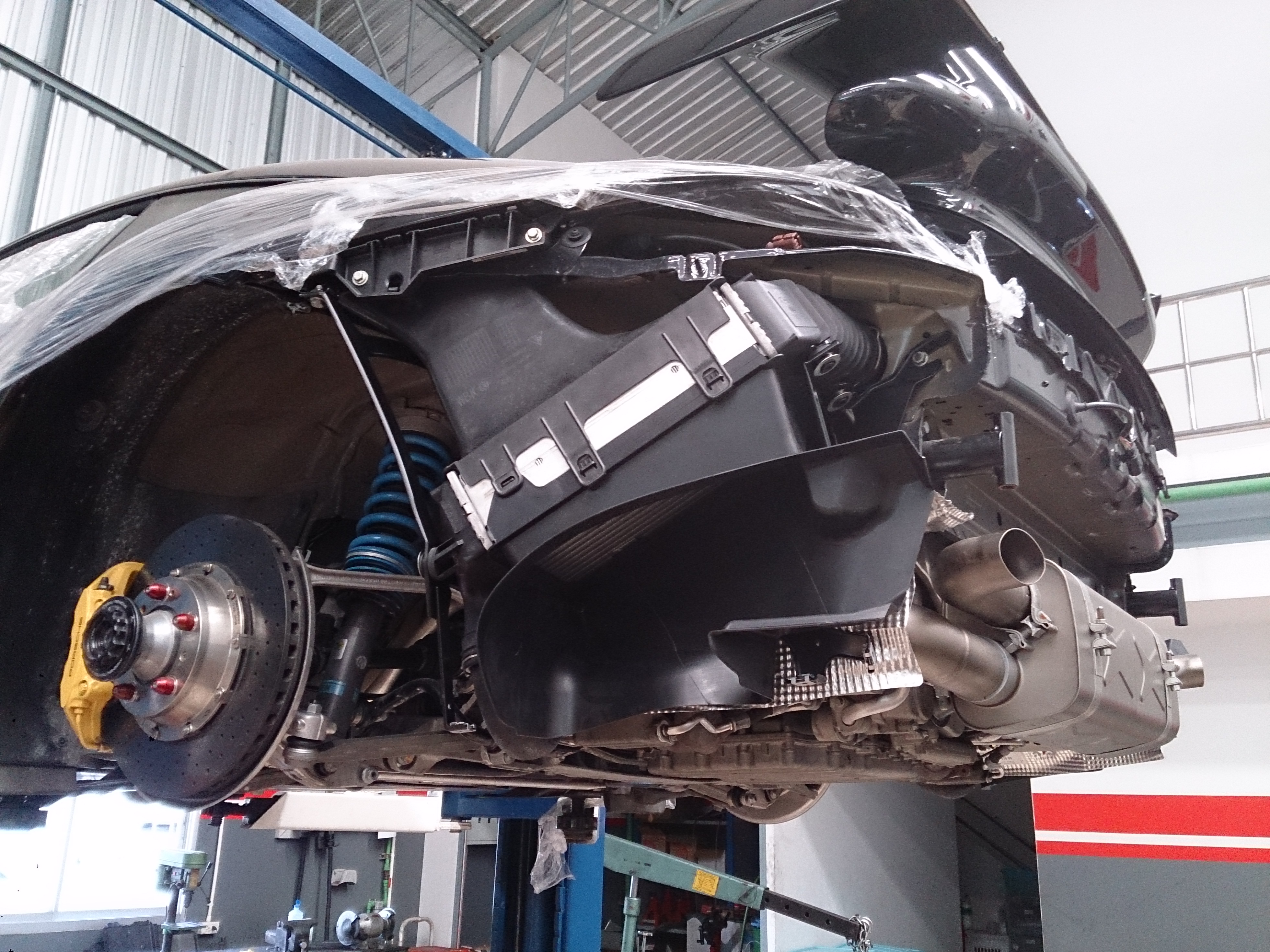

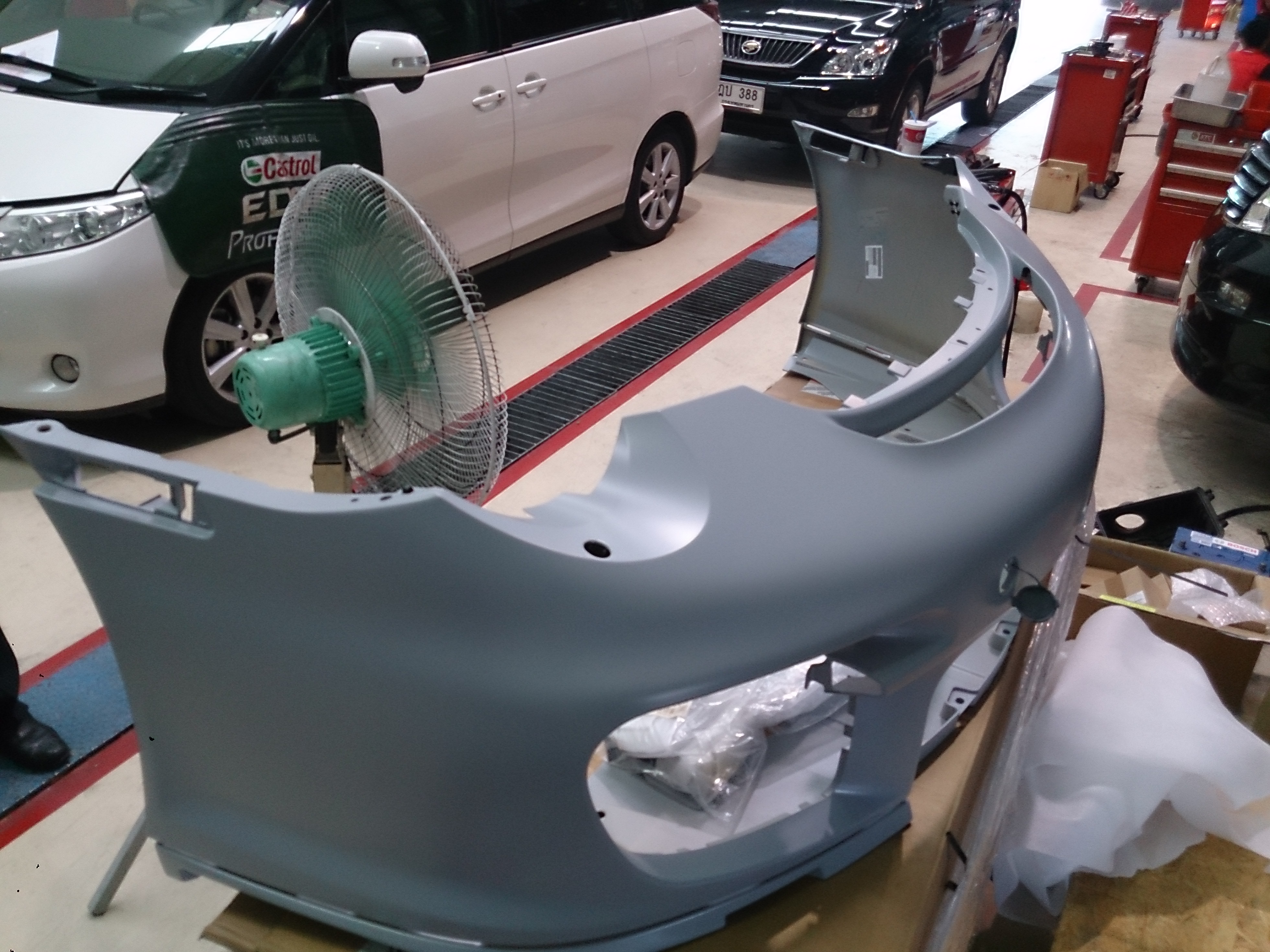

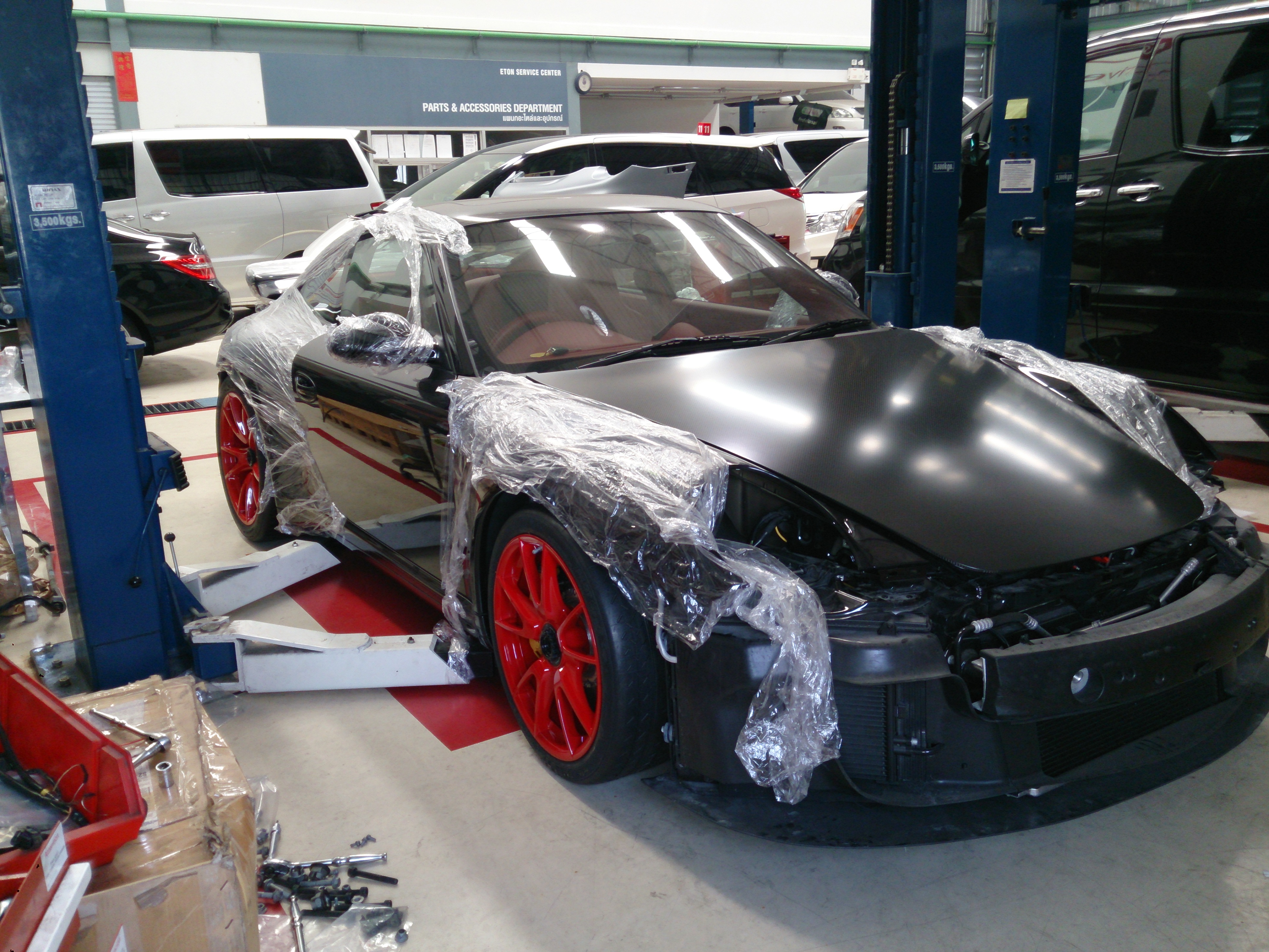

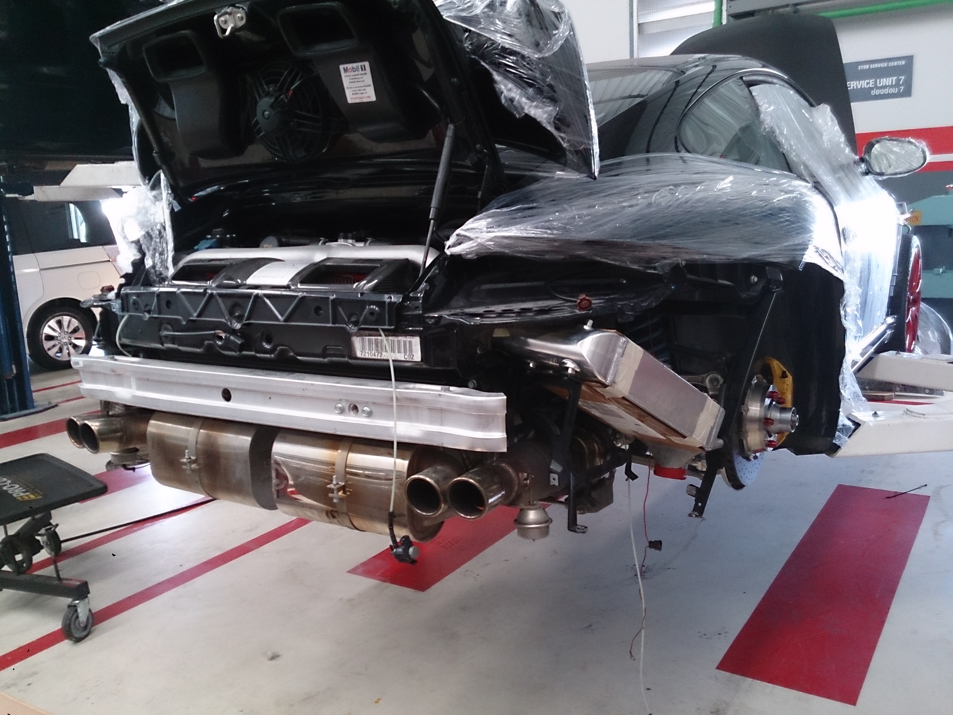

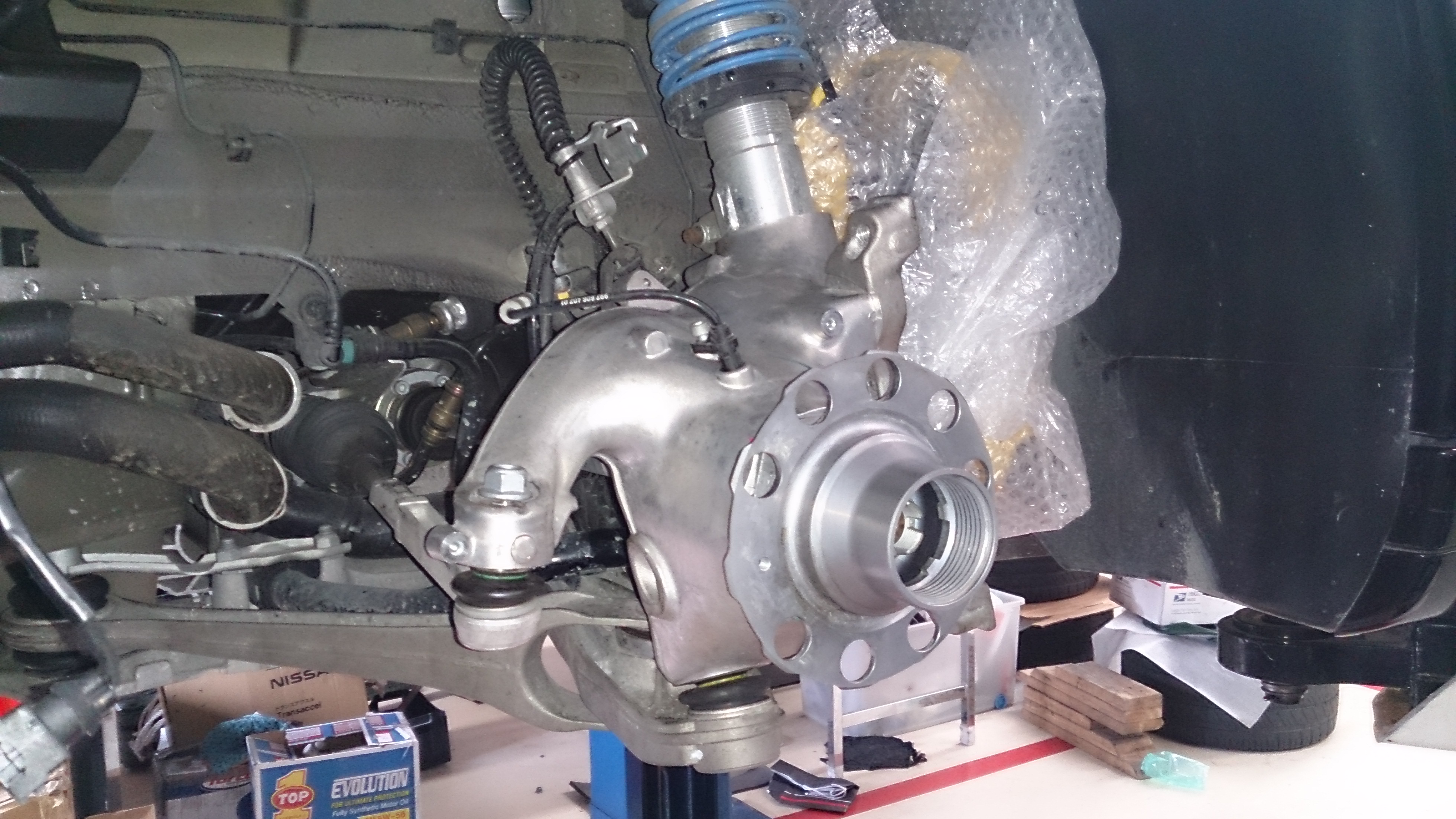

We begin with center lock conversion
Center locks completed

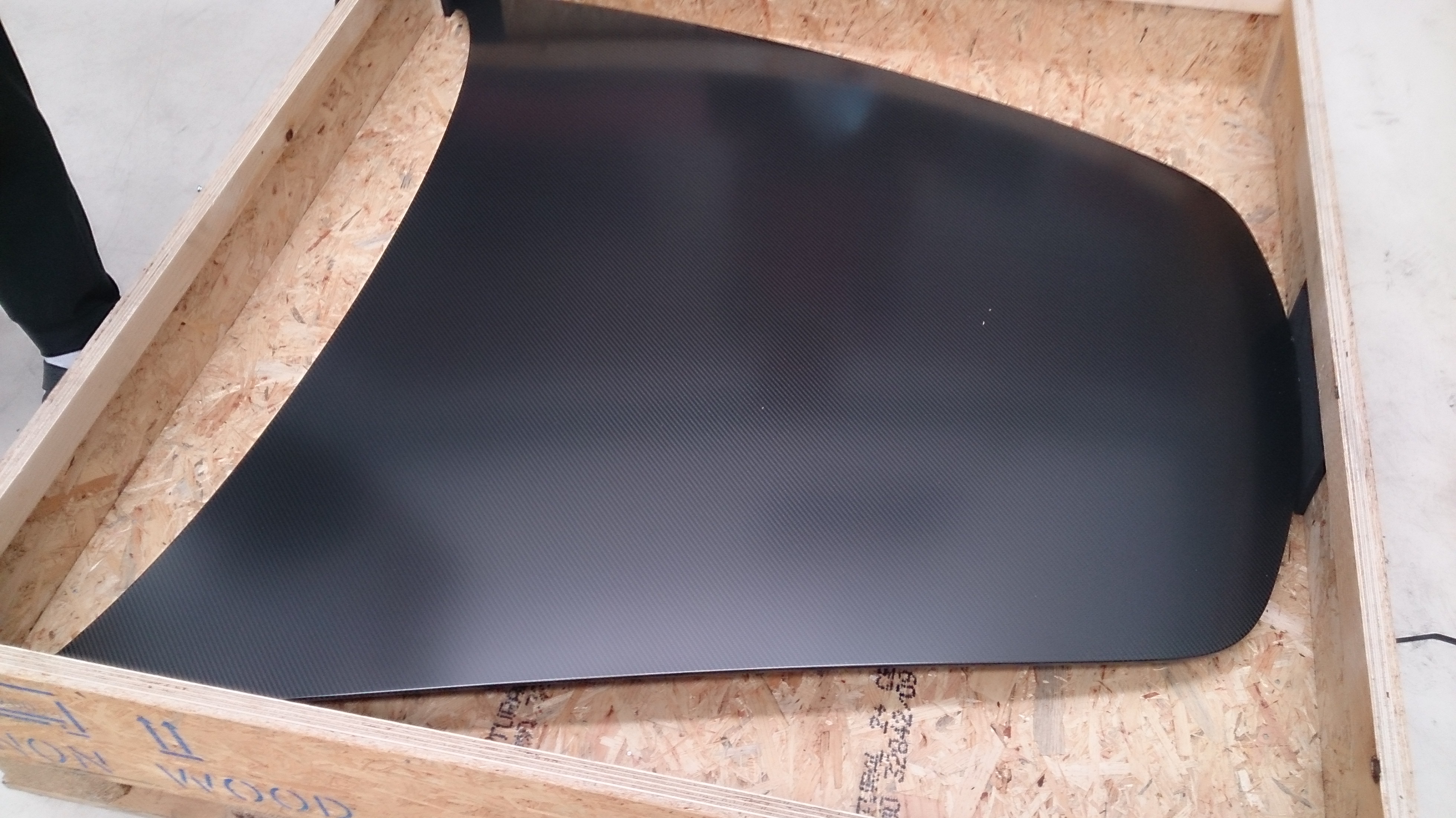

OEM GT2RS Conversion parts - Carbon Bonnet
Carbon Fenders
Front Bumper
Test fitting before sending to paint shop

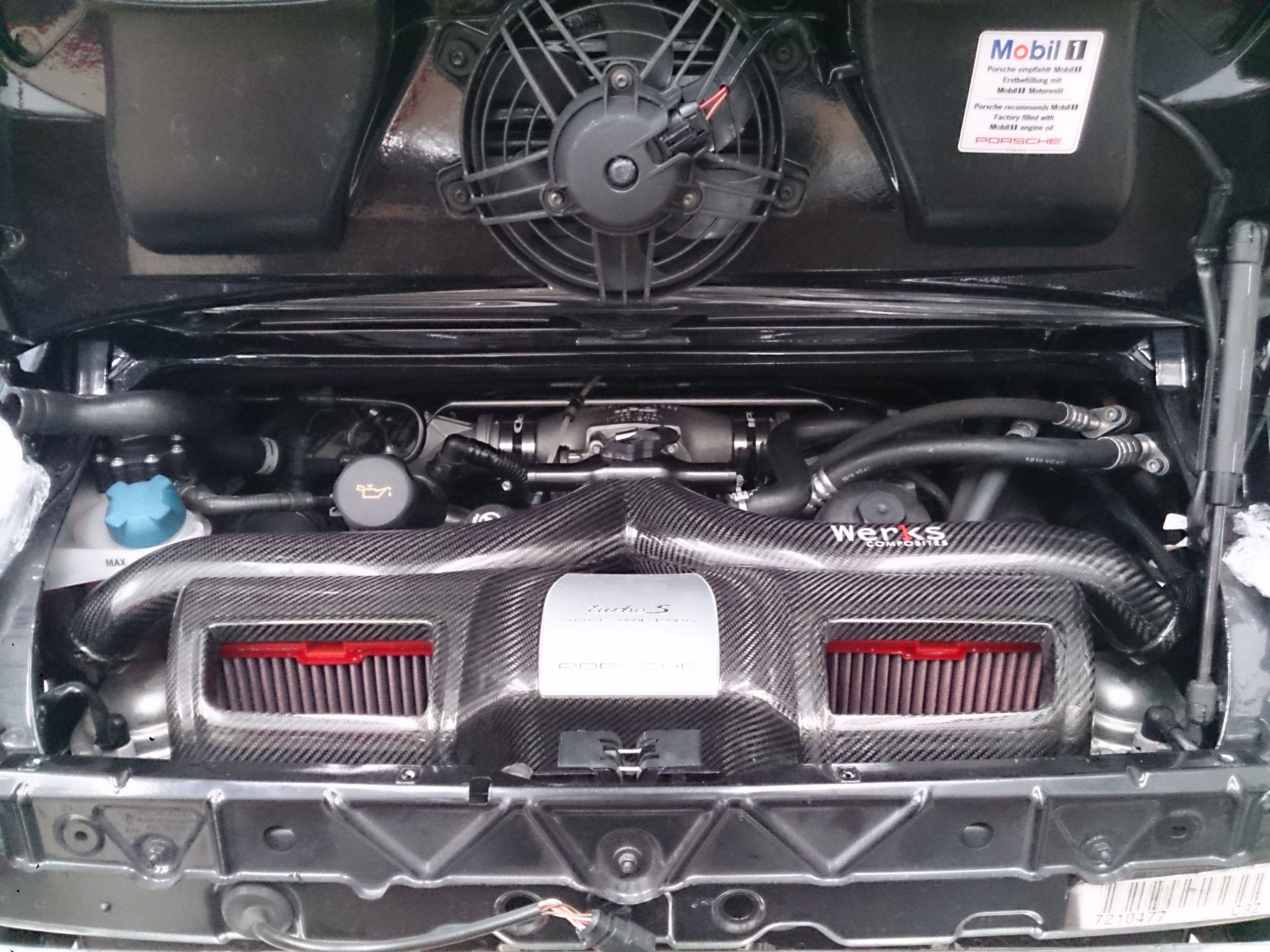

IPD Plenum
Werks Y Pipe
Champion IC - which i ditched due to its weight.. really heavy compared to OEM GT2RS IC
Rear GT2RS Outlet ducts
Nearly there! - Akrapovic exhaust to reduce 17kg over hang weight

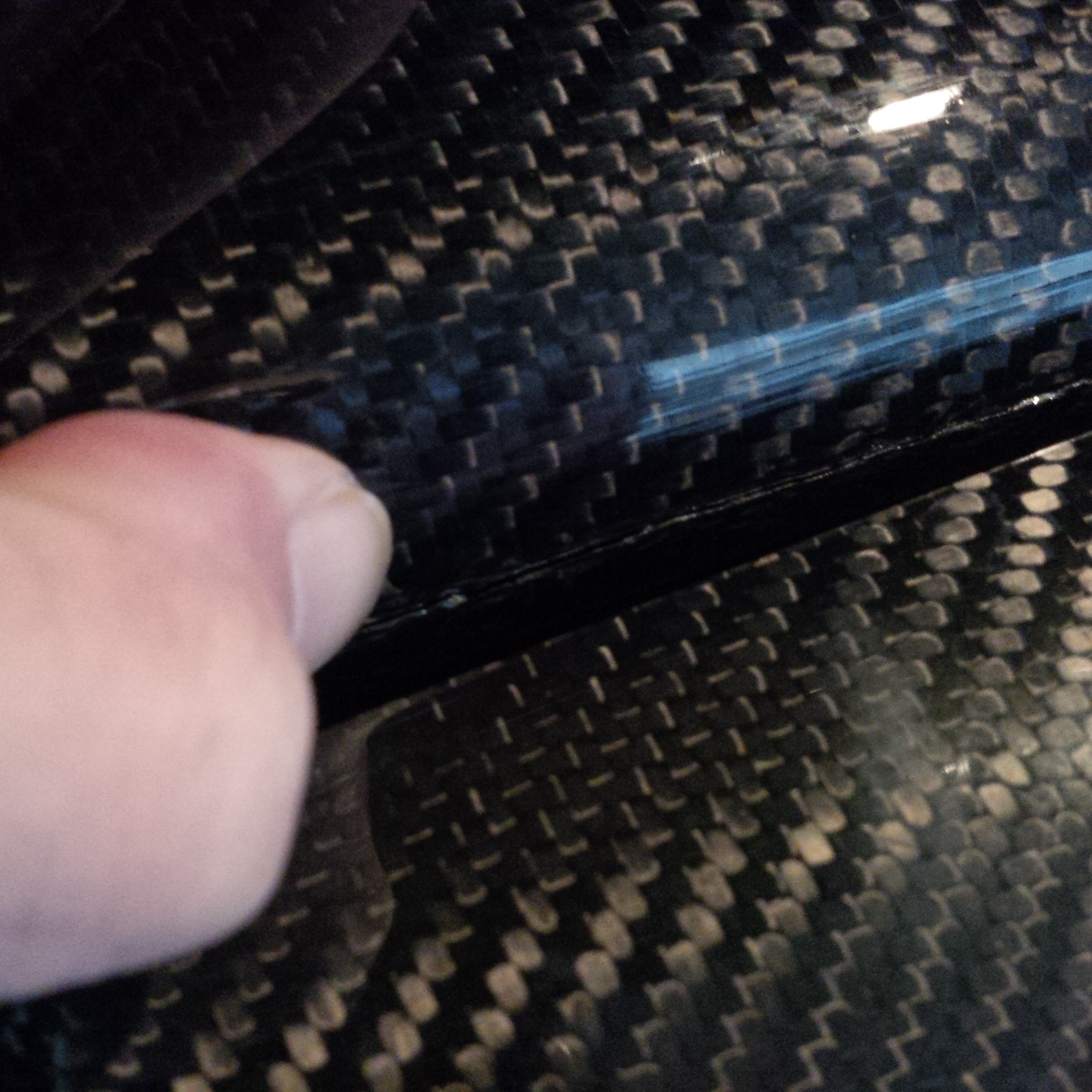

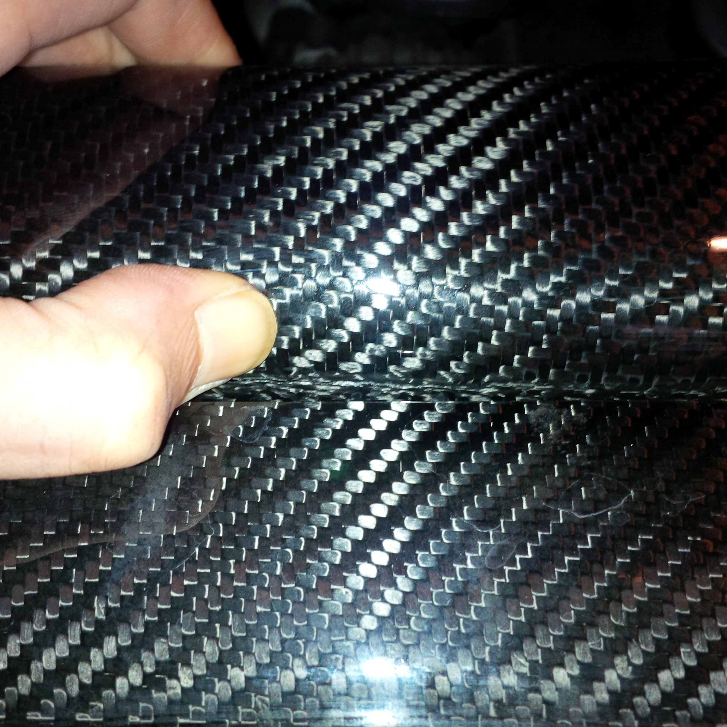

Well one sunday drive, and my carbon Werks Y pipe has split at the seams.. pathetic, waste of money and time. to be honest I had the feeling this is a weak part and I wasnt wrong. (moreover, the inner surface is hardly smooth)
fyi, clamps were torqued at 4.6nm.. boosting at 18-19psi
