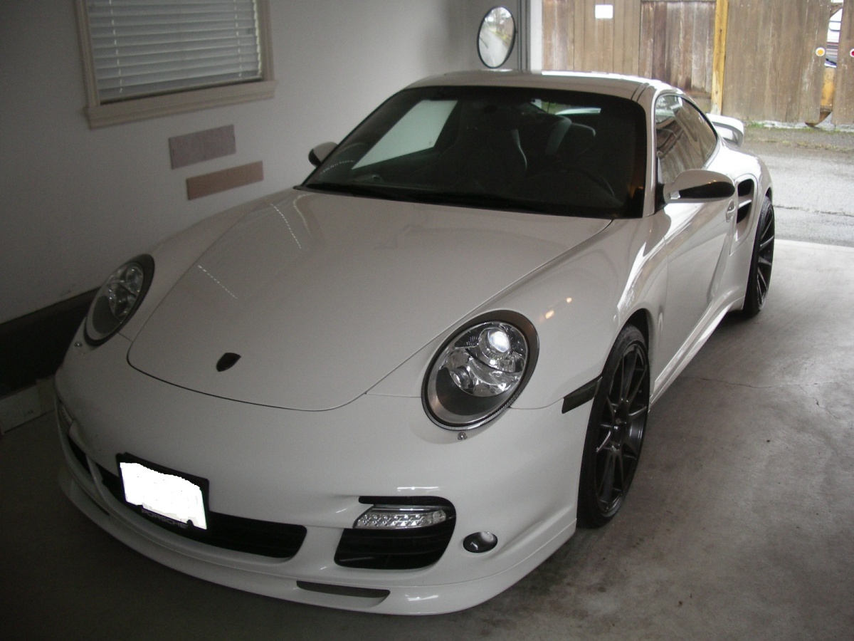

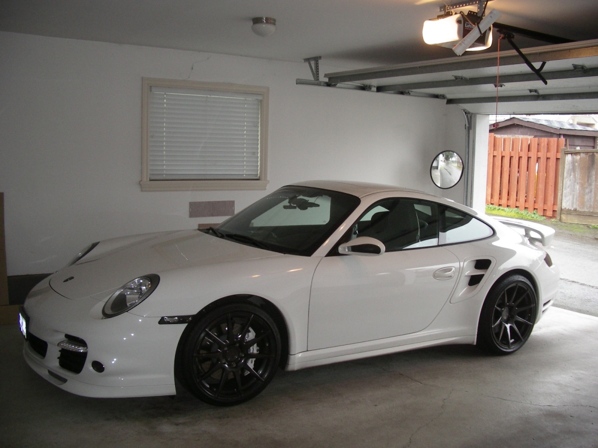

Hey guys, just had a set of GMG WC springs installed on to my 997.1 TT.
Stance looks great, and the car handles better
However, over certain bumps, I am getting a knocking noise from both the front and rear. This noise has never been here before until immediately after installing the GMG springs. Everything has been rechecked, and was/is installed properly.
Installer is Porsche trained technician with over 20 years at an authorised dealer, so his ability and equipment is not in question.
Any ideas? Car is still at dealer and they are looking into it
