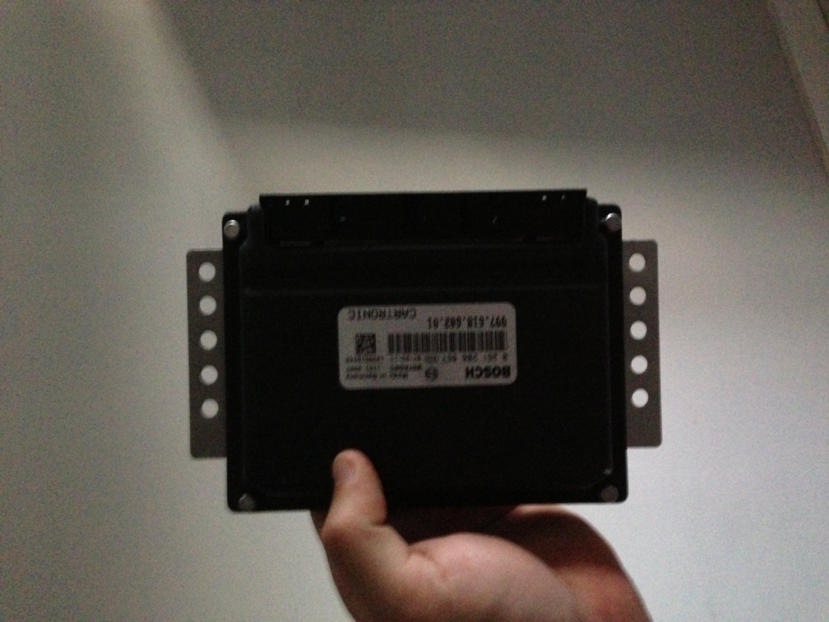

DME is out, i will send it to Scott on monday
Again Thank you Scott
