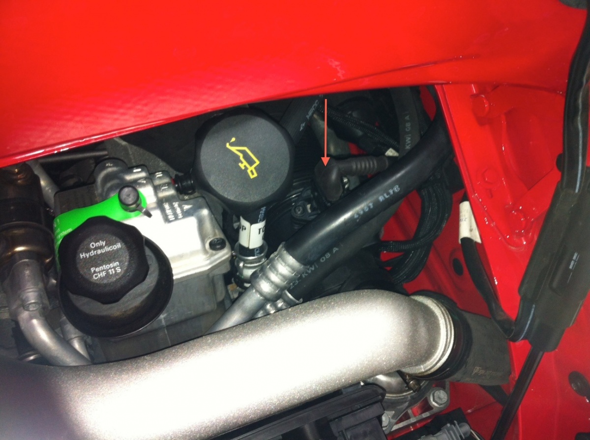

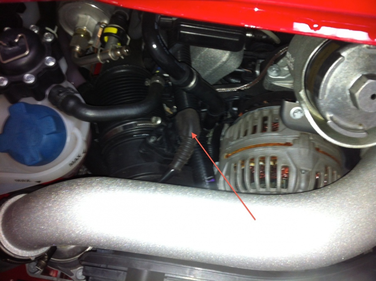

Locate MAF sensors. There are two.

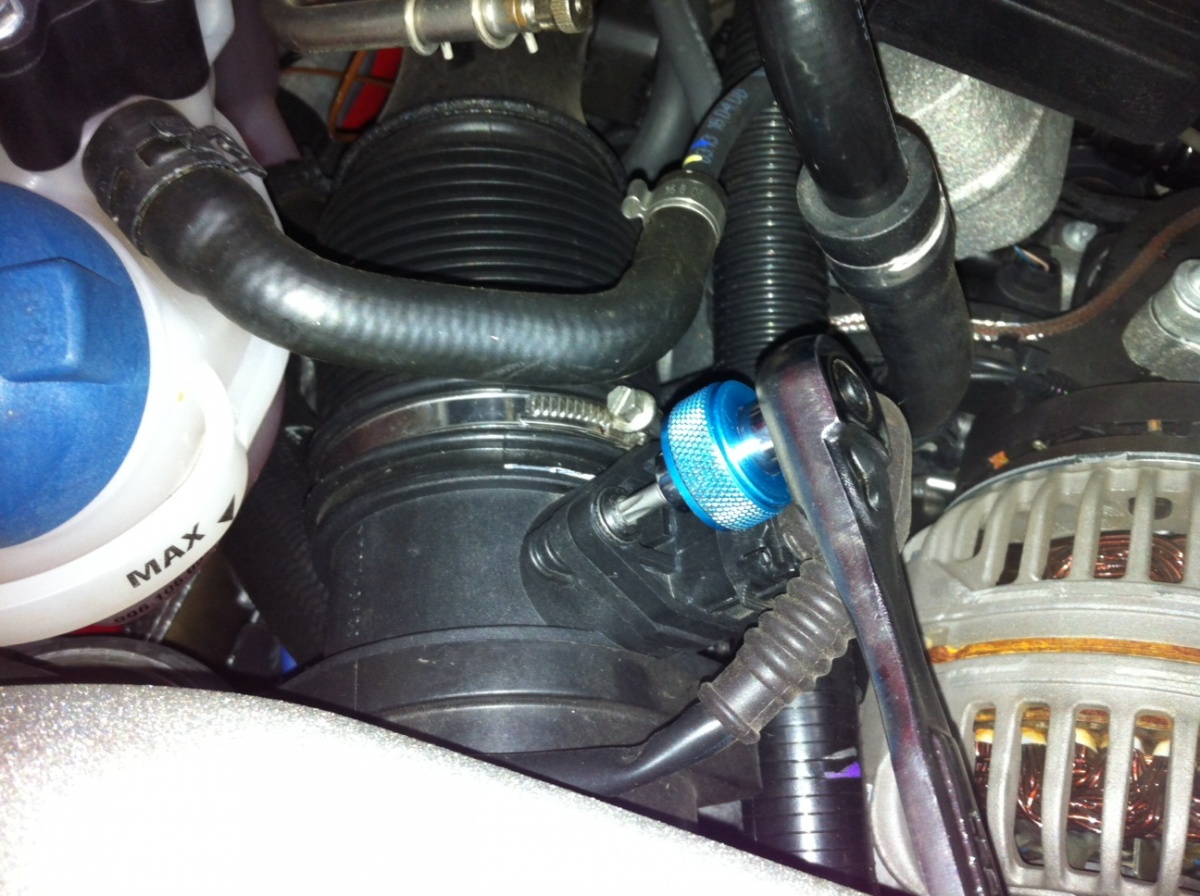

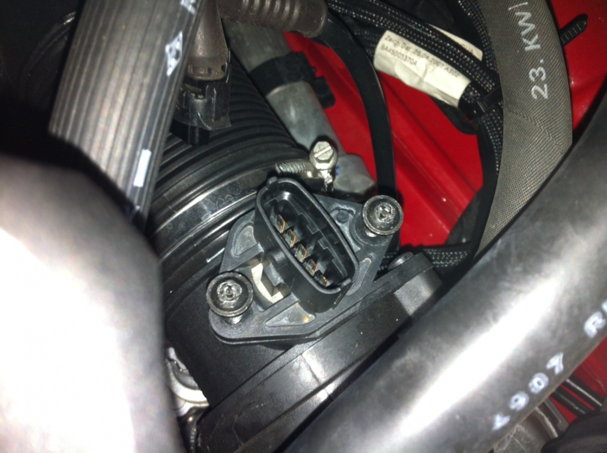

Disconnect the sensors from the harness, then unscrew the security torx plus bolts. The MAF sensor has a side clip that you push to release.

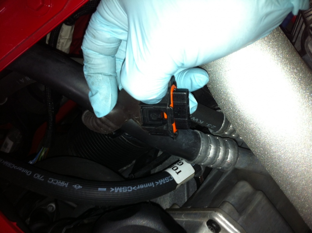

Once the MAF is removed, use the CRC spray to clean the wires. DO NOT TOUCH THEM WITH YOUR FINGERS.

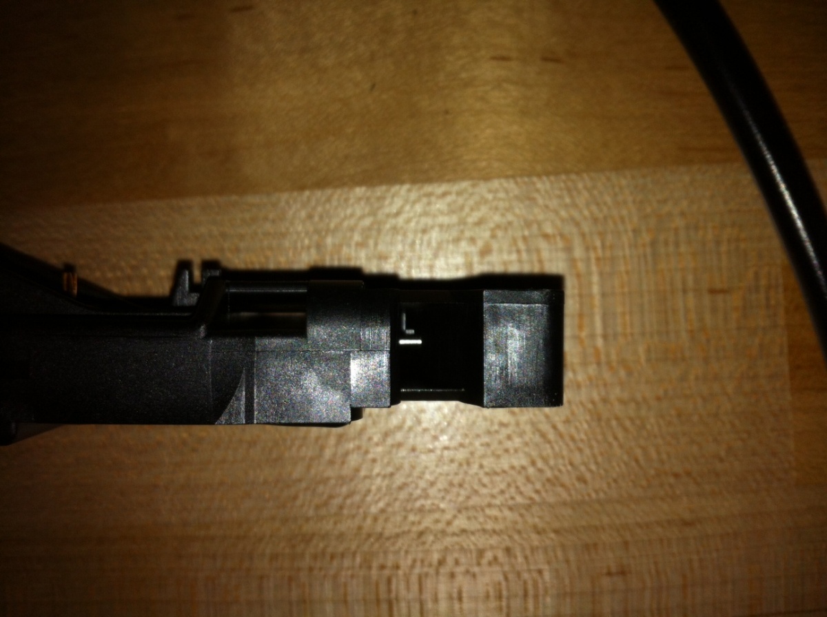

Reassemble. Note - the sensors will only fit correctly in one direction. If you flip it around, the holes for the screws will not line up. Reconnect the harness.

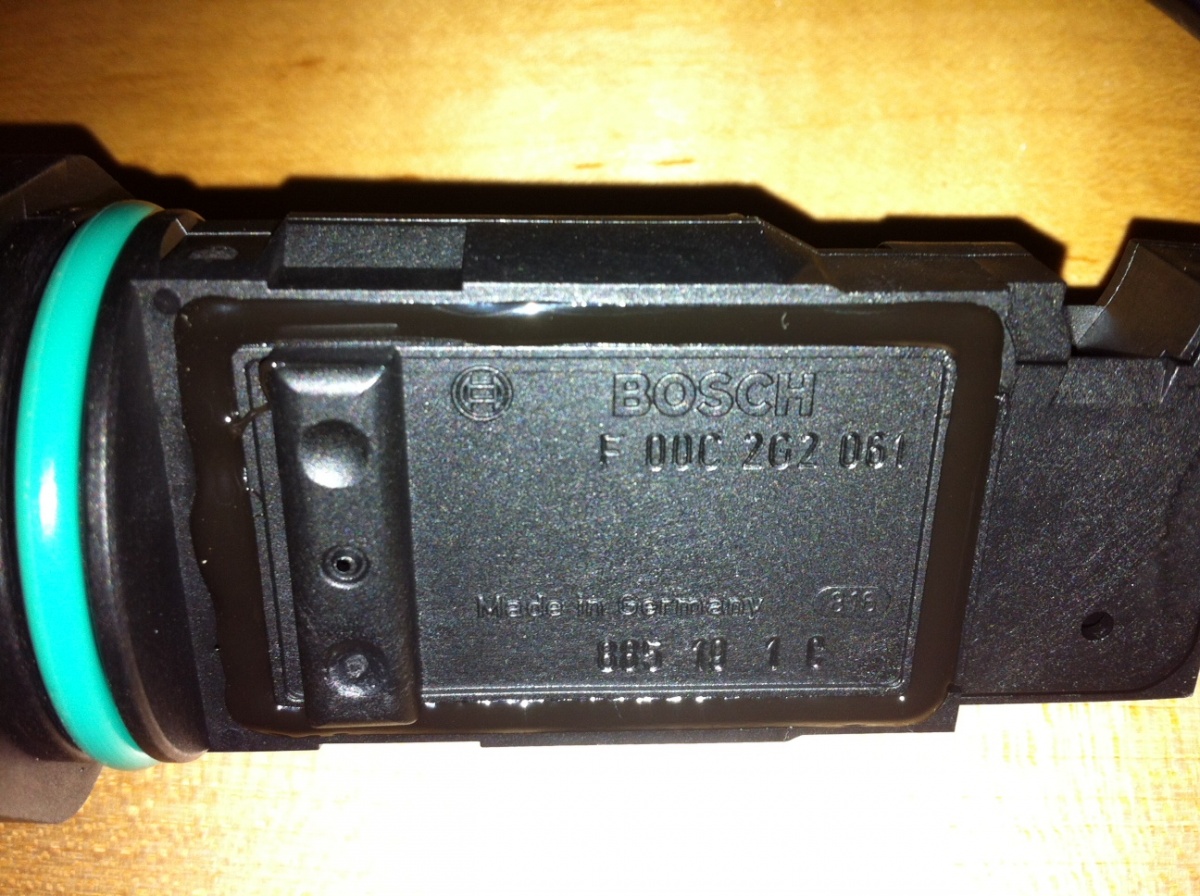

Originally Posted by Macster
The working surface of the MAF is inside the MAF, the passageway through the MAF.
Here is the working surface of a Bosch MAF, I think this is from a Boxster, but the design is the same.
