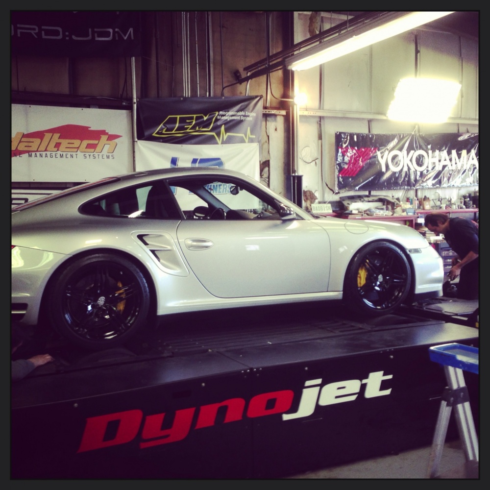

Had the Turbo Dyno'd today. Below are my specs and read outs. Car sounded insane, numbers looked good but need to tweak the tune a bit. Should be able to get another 40hp/tq more I think. Let me know what you guys think. Read out looks a little weird to me....not sure if the Dyno sensors were set correctly.
2008 Turbo with 17k miles
FVD race exhaust (catless)
BMC Filter
Werks CF plenum and GT3 TB
Headers
FVD Tune

Here is a pic

Something weird with that dyno, sensors aren't reading right.
A stock 997tt will put down about 380 at the wheels. You should be around 460-480 at the wheels, many variables. Dyno technician, improper placement, not using fans, etc.
If it was a very hot, humid day, engine hot, your numbers would look like that bc heat soak, knock sensors, ecu pulling timing etc.
I'd re dyno at another shop under ideal temp conditions.

It almost looks like traction control was kicking in. My mechanic said that a Turbo needs to be Dyno'd on a linked system because if the front drum is turning at a different rate than the rear, this is exactly the type of read out that one would expect. The other thing that was weird to me is that they pointed the fans at the intercoolers and not the intakes.
With a dynojet it absolutely has to be a linked setup, or else you will get issues w/the traction control and a not good/accurate reading. Your car should register in the 475-480+ whp mark w/your mods. Every 997/996 i've seen dynoed has the fans pointed at the IC's.

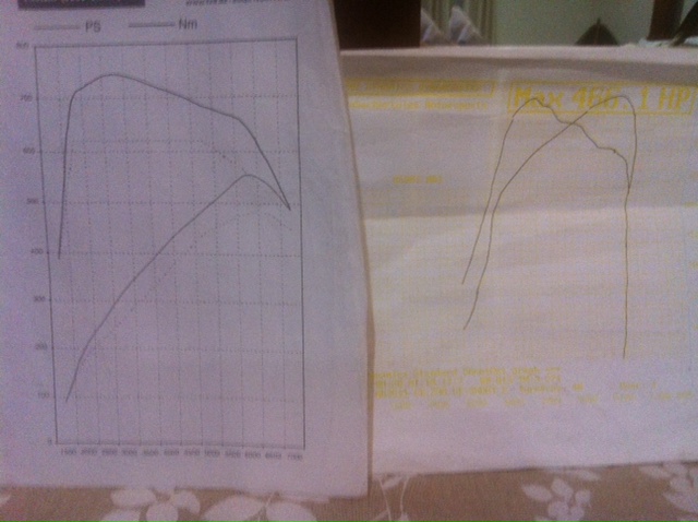

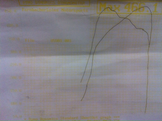

If I get a chance later, I'll post a scan of a dyno from my blue car with the exact same fvd 555hp package, dyno'd 477 at the wheels on a dynodynamics. Your problem isn't the tune I don't think.
(correction....466)

My graph from '09 with the same fvd tune as the op. This was done at farnbacher-loles on a dynodynamics dyno, just after the #87 cup car got off. (I think they know what they're doing...) Sorry for the yellow ink, I guess their printer ink was low. Peak wheel hp was 466, hot, humid day, corrects to about 560 crank.
Note the comparison to the fvd graph, very similar.
Hope this helps the op, I don't think it's the tune as this is the exact same one with just a tubi exhaust, car stock otherwise.
