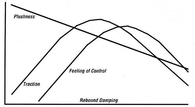

Part of the reason why I mentioned that damper setting is black art/black magic not to be taken lightly. Unfortunately I do not remember where I got this from but it's a good diagram for you to keep in mind as you adjust your suspension, the point being that the point of max traction may not coincide with the point of subjective control, nor the best comfort. Frequently you need both good tuners and very experienced driver to set it "perfect," and even then perfect is not absolute with all parameters.
Second chart is how damper's setting affects understeer/oversteer.
It is from these 2 charts that my opinion is best to start with manufacturer's recommendations, and unless you are very advanced driver with advanced tuner, do not stray too far from recommendations. Extreme settings (lowering, camber, damper, etc.) are almost never good in suspension tuning for *street* cars - moderation is the key IMHO.
I would probably go back to recommended settings, if you still have bobbing there, then it's problematic, because now it could be your replacement spring. Unfortunately, I would not ruling out going back to the Porsche suspension either if that handling is what you miss. This is for the same reason that I don't think GT3/GT2 suspension should be modded. In the Turbo, it's a luxury suspension and it's a simple matter to firm it up and improve it. In your car/GT2/GT3, Porsche has gone all out for handling and you are going to lose handling if you alter it for comfort.

You are so right in ref to Black Art.
I have been on a fierce learning curve with this over the last 12mnths and have definitely considered returning to the original suspension to recalibrate my intentions/memory after such a journey.
I understand the emotional perspective of this as well and wonder if im chasing something that ends up being my own myth .
Those charts are great thanks so much!
