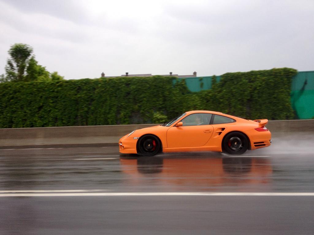

H&R here. Handling improved, ride quality didn't change. The flaps on the front wheel liners scraped over bumps so I cut them off. Car feels great:
