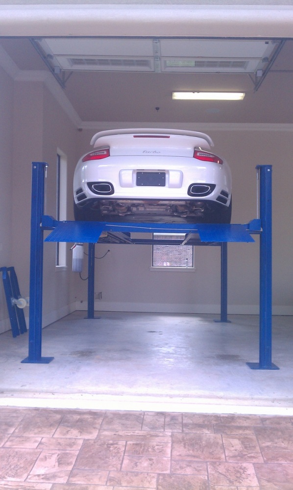

Size:  160.6 KBThanks guys for all of the input.....Im with you skandalais447 on the after the sale communication and service europipe (stef) provides ....I would of love to have watched them hand craft this masterpiece....Steve tt I have a lift in garage and I plan on lowering the car down on a workstand under exhaust then removing fasteners then raising the car the reversing the process installing the new system. I prob wont tune the computer or change plugs. Stef, thank you for clarifying today, I searched my box for chocolates, waffle mix and messages from Belgium women but found none :-( ** note that the car on the lift is the car I traded for my tts.

My studs were in really bad shape when I pulled my exhaust off. I should have replaced them but I just ran a die over them for the nuts and was able to re use them. I figured that the exhaust couldn't be too hard to replace but it was a pain in the **** on the ground without any help. With a lift, which I have now, it would have been alot easier. Any way make sure you have the tools you need on hand, have fun and take your time and it will come out just fine.

Thanks mattgarrett.....I will post pics soon of my install....Sorry to bore all of you with my exhaust saga....I'm just excited....I'm doing it myself because I take pride in things like this plus don't want anyone touching my baby, not to save money
