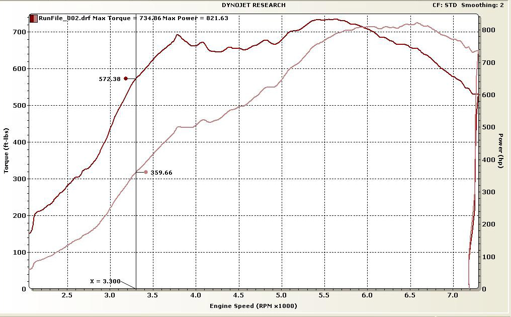

Originally Posted by yumaverick
Cannga,
VTG's are limited to around 700whp, after that you need to go with a GT/Alpha turbo. Boost does come in earlier on VTG's though.
Attached is a dyno sheet of a VTG car making well over 700whp....just sayin'
Originally Posted by Chkmgnt59
Proto does his own tuning and can give multiple maps. I have an e85 map and a pump map. Just need a laptop and 2minutes and I can switch. Switzer can do something with his stand alone, not sure about champion.
With the GIAC software we use, you get multiple programs and a handheld switcher that allows you to switch between them within a few second.

Tom, that car is on a built motor (3.8?) and running what boost?
Old Jul 26, 2013 | 09:32 AM
  #60
Tom@Champion's Avatar
Posts: 4,320
From: Pompano Beach, FL
Tom@Champion Is a GOD !Tom@Champion Is a GOD !Tom@Champion Is a GOD !Tom@Champion Is a GOD !Tom@Champion Is a GOD !Tom@Champion Is a GOD !Tom@Champion Is a GOD !Tom@Champion Is a GOD !Tom@Champion Is a GOD !Tom@Champion Is a GOD !Tom@Champion Is a GOD !
Yes, that's a 3.8L running 28psi.
But....still VTG's.
Our 3.6L TT hit 775 awhp on about the same boost, I'll try to find the sheet.
