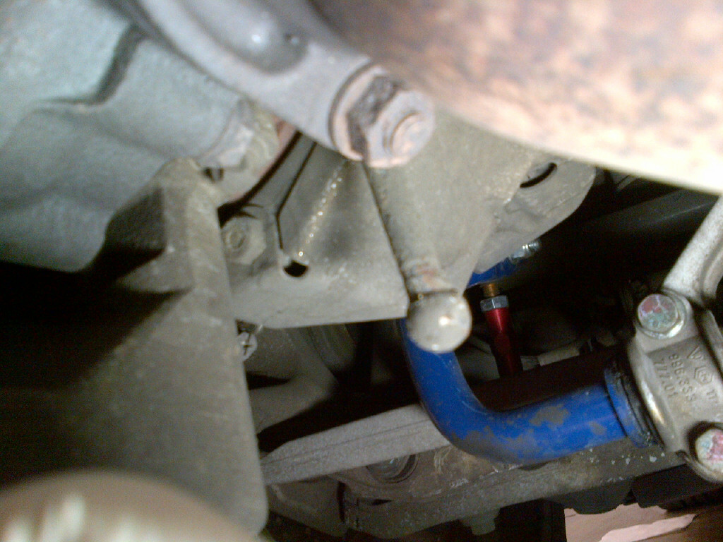

One of the actuator rods from the VTG is swinging free and not connected. I'll figure out who to blame later, but will try to reconnect. Anyone know how? Space looks tight.

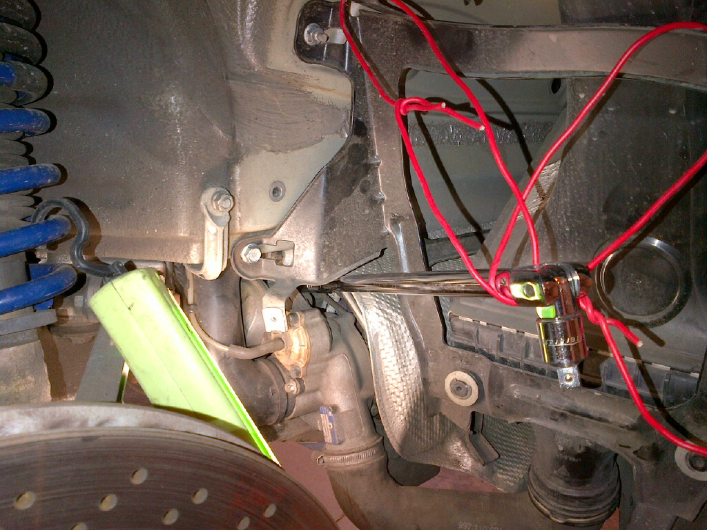

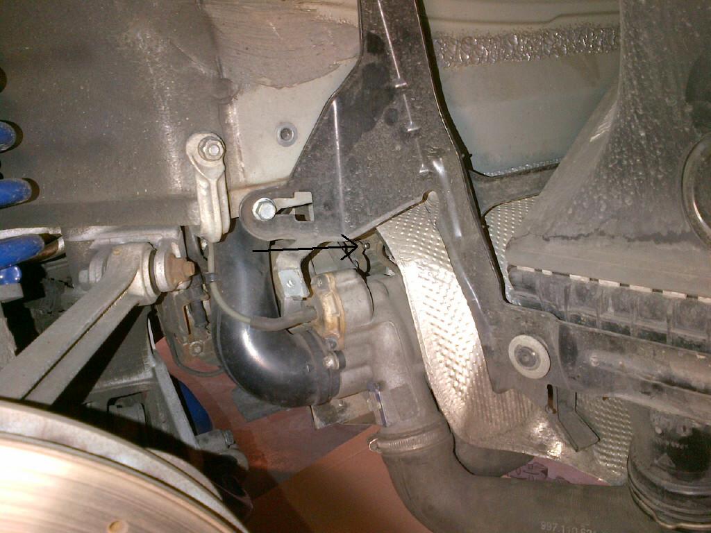

Problem Solved
I had my plugs changed at a high end indie. When I picked up the car after the install I immediately noticed a change in the exhaust sound from prior. Power felt different too. After I re-attached the actuator, exhaust went back to the “normal” sound I was accustomed to as well the power (via datalog) went back to stock normal. And no CEL. All my facts and findings seem to point that the indie didn’t re-attach the actuator.
Thanks to the forum for helping me get this sorted!
Pic 1 shows hanging DS actuator arm. Pic 2 w/ arrow shows access to the actuator after pulling off the DS wheel liner. Pic 3 shows a breaker bar pushing the ball end to be joined slightly down, so that the arm can be re-attached. When the ball end is unloaded, the actuator arm is not long enough to reach. When the ball end and the arm were positioned together, I used a long open wrench to apply some sideways leverage to pop the actuator arm back on to the ball end. For those that noticed, the red wire in pic3 is the wire supplied with the EP. I didn’t know what lube to use for the ball/actuator, so I used the ceramic grease provided with the EP. I hope it works ok. Cheers
