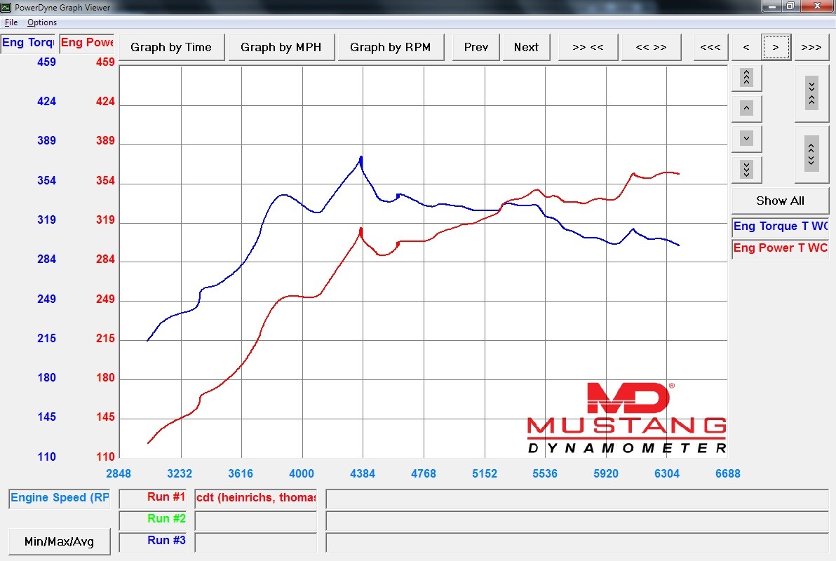

Car is vomiting.
Put on a mustang dynamometer and was told I should be 430-450 by evoms as they run the same Dyno. Stock turbo should be 380ish.
Mine ran 350/376. Sometimes it sounded good but the power wasn't shown. Other times it was a very gradual rpm run up like it wasn't in boost at all or was pulling massive timing. Evoms is looking at the data log and said the car is not happy at all. They want a smoother band and much more power. Doing smoke test on Monday at Porsche that did the install. Then upgrading to evoms silicone clamps/hose kit and another smoke test with Dyno run next Friday.
Had the left intake hose completely disconnected when we opened the trunk. The right intake plenum boot was on but the clamp completely off. Had 2 runs where the clamp on the y pipe to throttle body failed and popped under pressure too. This is why we are replacing them all. Not sure why porsche would install those on there if they were past their life.

blowing off ypipe and such is pretty common if you're using bad clamps or not tightening all the way. Should be an easy fix to keep it all together. But I'd be very unhappy with the porsche dealership that installed if they didn't bother to tighten the clamps properly...

As big of a PITA this was, count the blessings a bit as problems go with the car pulling timing and generally not being happy, this is one of the best ones and easily remedied :-)

The guy doing the Dyno seemed to be a bit new at testing them. What gear should you do the pulls in, and at what rpm should you floor it?
