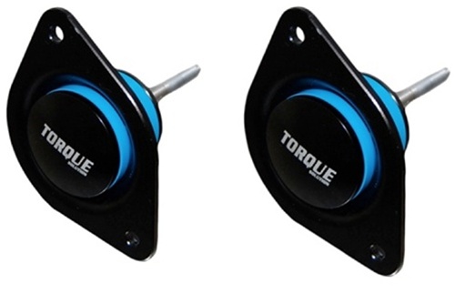

Originally Posted by Steve K ny
how do the rss mounts compare to these ?
I was interested in hearing if anyone had any experience with these Torque Solution mounts as well? Anyone??
DC
