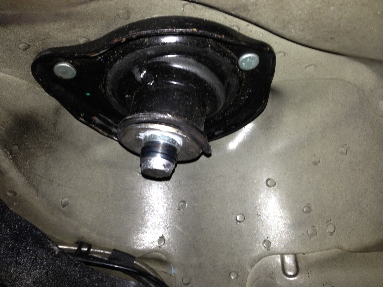

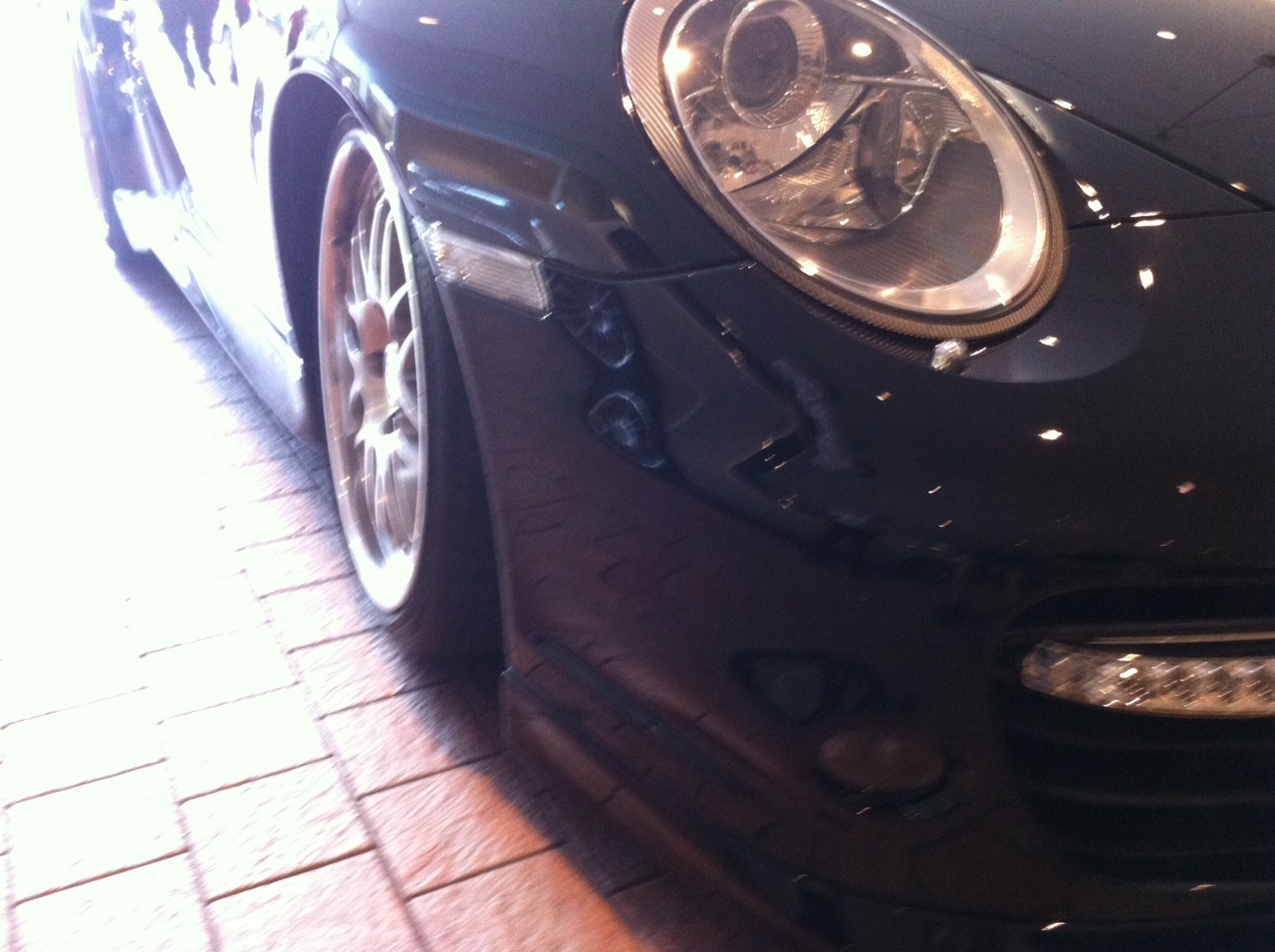

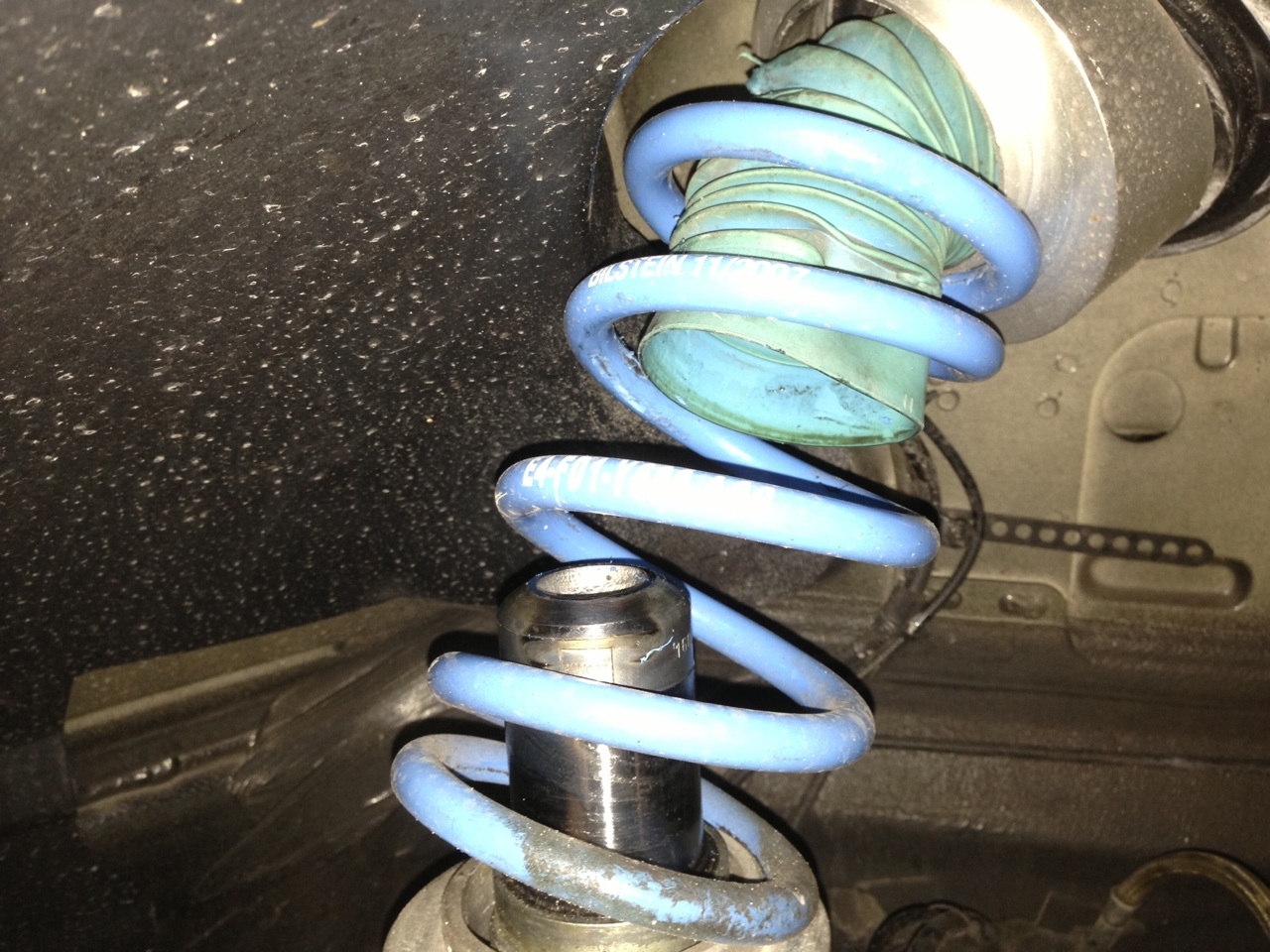

After 6 years and a several issues my car finally faced a major problem bad enough to shake my confidence . Previously a faulty sensor or wire snag was annoying but repairable. In fact even adding the corrected drop links was doable and i did it almost immediately after i read a post here by Sharky .
This new hurdle however is (in my opinion ) inexcusable . I do not track my car . I have never entered a drag race event . It is a modified car and I do occasionally enjoy a lively sprint but for the most part i feel like I pamper the car .
Last Friday I drove from my house to go swimming . I had not driven the car in a few days so I had an enjoyable brief drive . While pulling into the parking garage there was a very small speed bump . I drive over it often but on this day at only 5mph I heard a crunch noise . I thought it was a few plastic containers in the trunk . After my swim I backed out of the parking space only to hear major crunching , a PSM failure light , and was barely able to limp the car the 1 mile to the dealership .
This is the result . I was given many ideas and choices but I just feel this entire system is better off in the garbage and KW's with nose lift are going on the car . The entire ordeal was not expected or cheap but my feeling is I am glad it happened in a garage at low speed with no injury or damage (other than my wallet expense) .

Larry, glad you are safe. This looks to be suspiciously like the area of the well known cone washer at neck of front suspension, no?
If I am correct, your installer might have forgotten to install it, or install it backwards, or use wrong leverage during installation on the neck of the suspension, etc.
BTW, what I've noticed is that for the 4-5 or whatever number people who reported problems, the problems seem to repeat multiple times, even move from electronic to mechanical and vice versa! Off top of my head, Larry's, Derek (?) with cone washer, and pureporsche (?); as if you are cursed . Only thing I could think of is more errors with repeated removals and installs.
He has installed 100's of suspensions (very accomplished in his field) and even noted that Dereks was installed incorrectly when Derek posted years ago on that old thread. In fact he discussed the tricky cone washer with me at that time with regard to Dereks car .
He made it a point then to discuss that mine was followed precisely to spec plus he has a shop filled with technicians who have also followed the build on my car . They also looked at my car (as he was on vacation when I brought my car) and multiple opinions pointed to a defect .
The break area is not at the washer but within the strut itself after 6 years of use on the car . It was a sudden snap too with no real warning . This is far too dangerous for my comfort zone .
