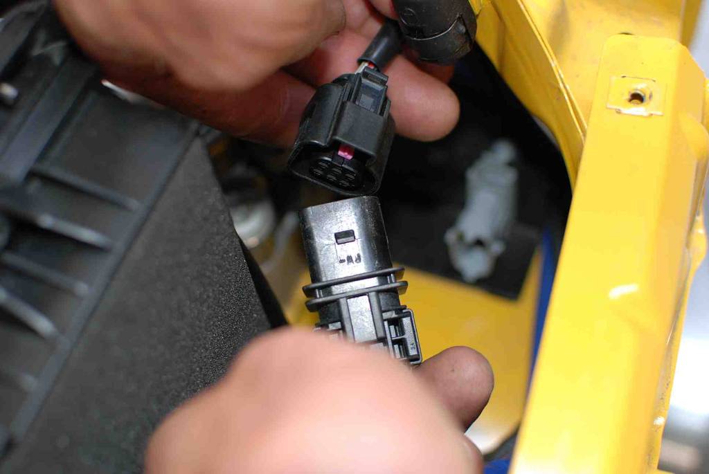

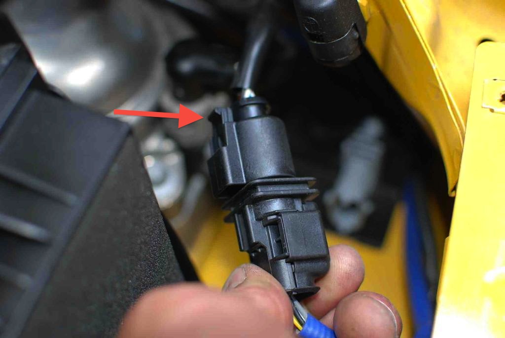

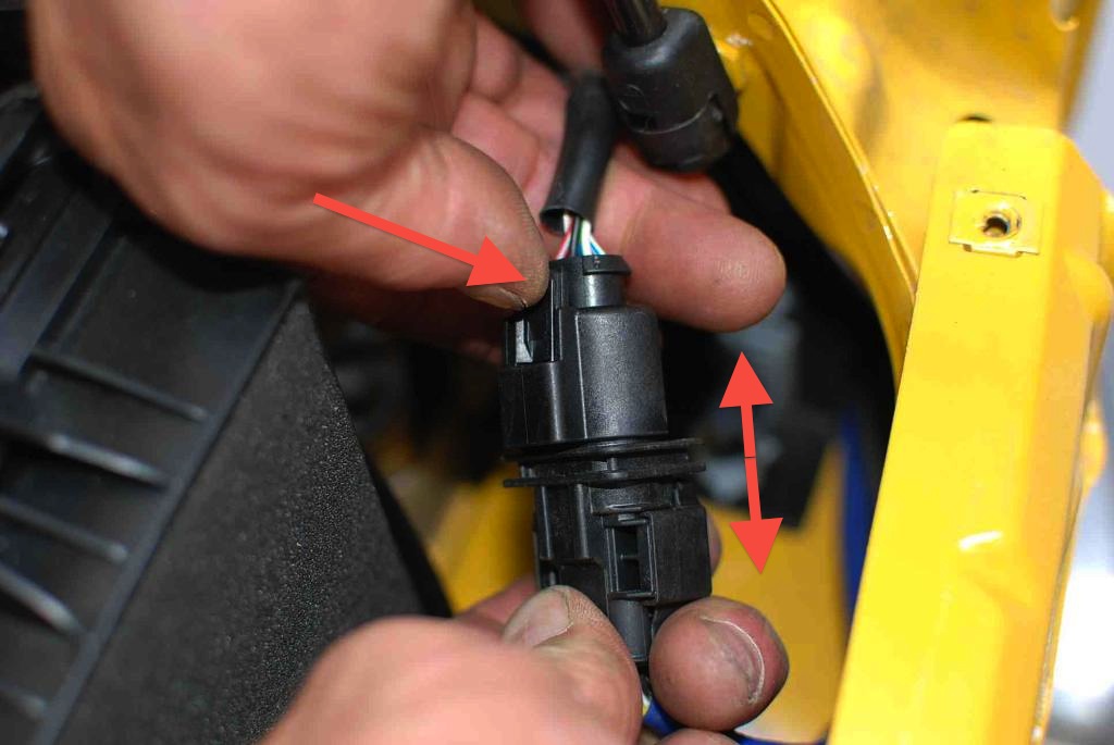

Just push that little lever as indicated. Usually you'll first hear a clicking sound, then just pull the connectors apart. Your connector might look somewhat different though as this one is from 997.2 TT but that's how it goes.
Good luck.

Thanks guys for the help! I got it. The issue was I thought it unplugged from the front.....After you pull it up and out of the holder, it looks like many other Porsche clips...Duh. Appreciate your help though!
