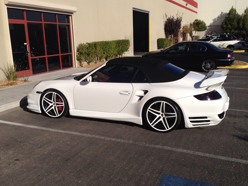

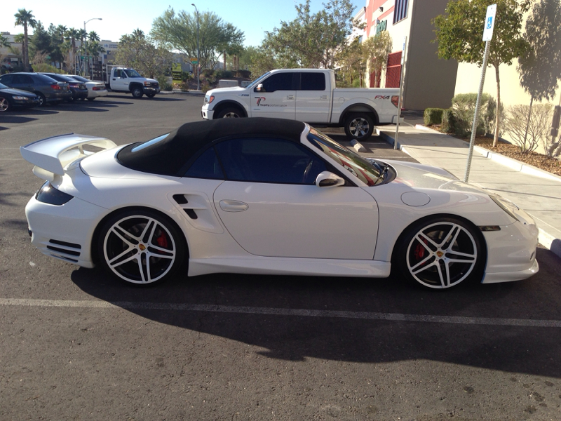

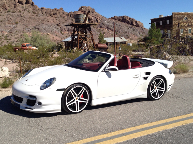

20" fronts are x8 rears x 11 and lowered on Techart springs
ID:	304969   Click image for larger version
ID:	304970   Click image for larger version

Good looking car. Any issues with rubbing? How much did your springs lower the car?

Thanks and no zero issues car actually rides better and yes it did lower

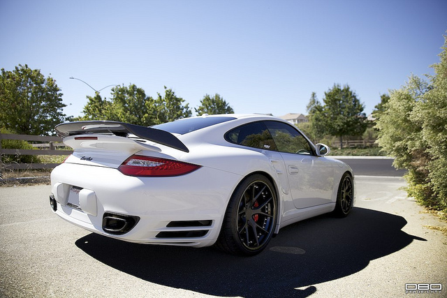

I know you asked about the 997.1 and you've already gotten a reply from dm620 running 13"s in the rear (wow!). But just as a datapoint (I think 997.2s should be the same?) I'm running 20x9 and 20x12, lowered, no rubbing.
