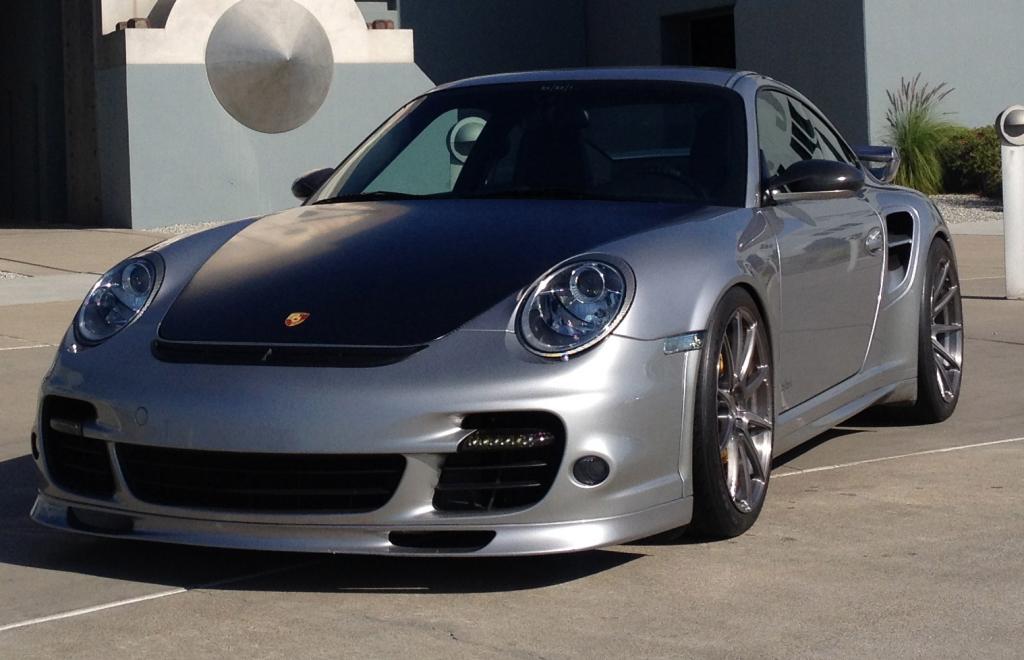

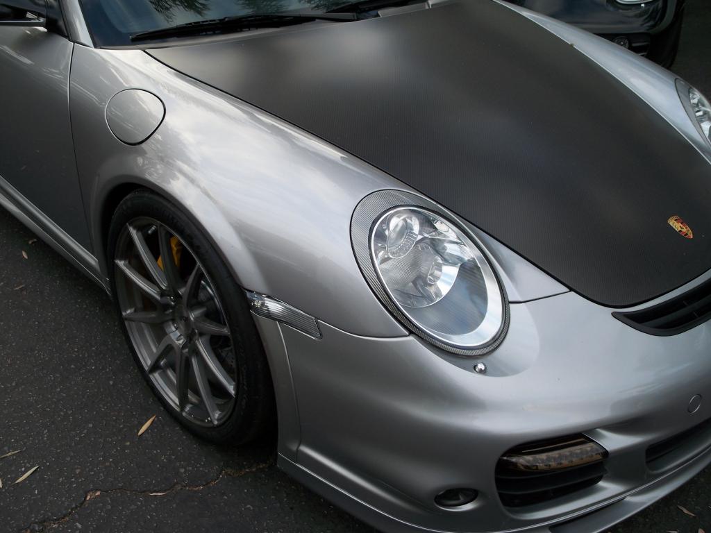

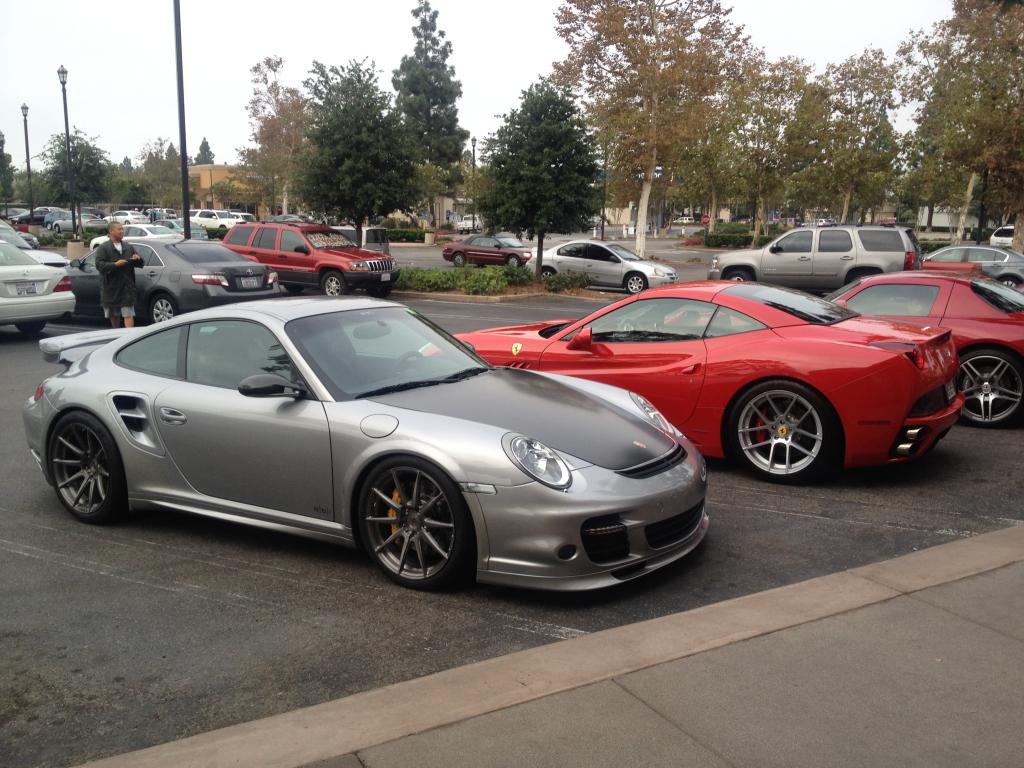

Like the other guys said a went for the full OEM GT2RS Cf fender & not the stick on flares, we still had to modify the small stick on GT2RS piece that fits on the bumper to make it fit the turbo bumper.The problem with the stick on flares is how the wheel doesn't look right afterwards imho & you can only do so much spacer wise ,because you don't actually gain any room because your fenders are still behind the stick on flares.With the Cf fenders you actually gain a lot of room in there & we had to get bigger offsets & longer control arms to get the stance just right with no spacers.But it was so worth it, it's very subtle but you definitely notice how wide it looks in person.

Thanks wheels are ADV's 10.1 SL's 19x12 & 19x8.5 offsets where same as GT2RS with cf flares specs which i'm positive where 47 & 48 tires are Mpsc 245 35 19 & 325 30 19 & no spacer's all suspension magic from Joey at BBI Motorsport in Huntington Beach CA.
I was lucky & had some patience & picked up all these parts over the last year here on 6speed the OEM GT2RS dry carbon hood the OEM Aero kit wing & the CF fenders (which where already painted factory GT silver when i got them)all for about 50 cents on the dollar from new prices & it still cost a fortuneNot to mention all the misc parts like side marker lights ,wheel well liners ,suspension goodies etc ,etc.
