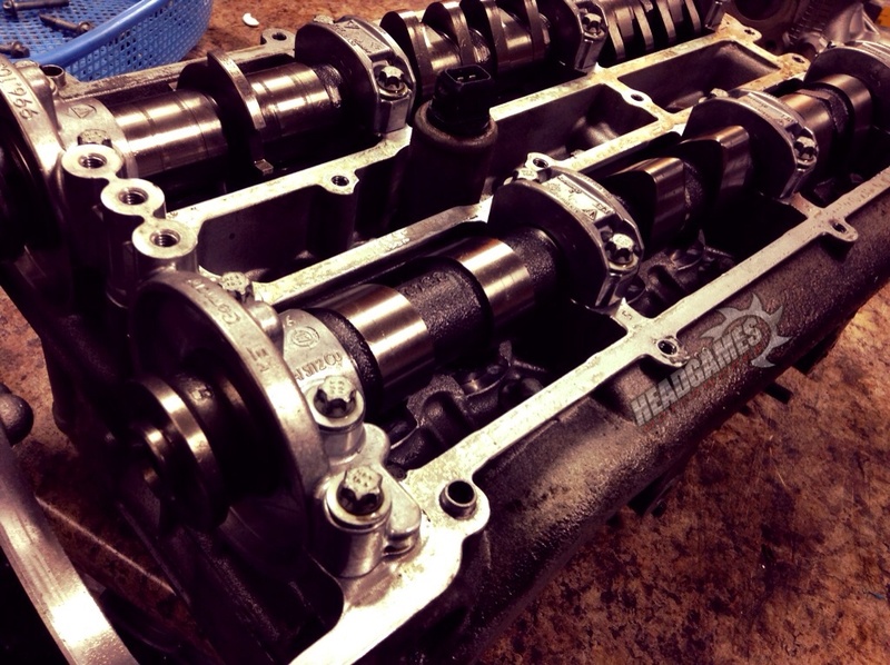

HeadGames has been doing 996/997 heads for some time now, doing them for various shops. Now, they are available to everyone! Follow this thread and see the process and learn how a head is built! This particular set will be sent off to our friends in Russia at Dragtimes.

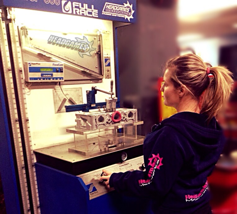

Flow testing is a integral part of cylinder head development, because of time constraints. We do not flow every head that leaves the shop, but extensive testing is done to get the valve job and port shape right where we want it before moving forward. Here HeadGames shop manager Tiffani is flowing the stock intake port of a 996 head we recently did on this forum. The 996 and 997 share the same cylinder head design.
Hope everyone enjoys this thread and follows along! Feel free to ask questions along the journey or ask to see a certain aspect of cylinder head machining you have always wanted to know!

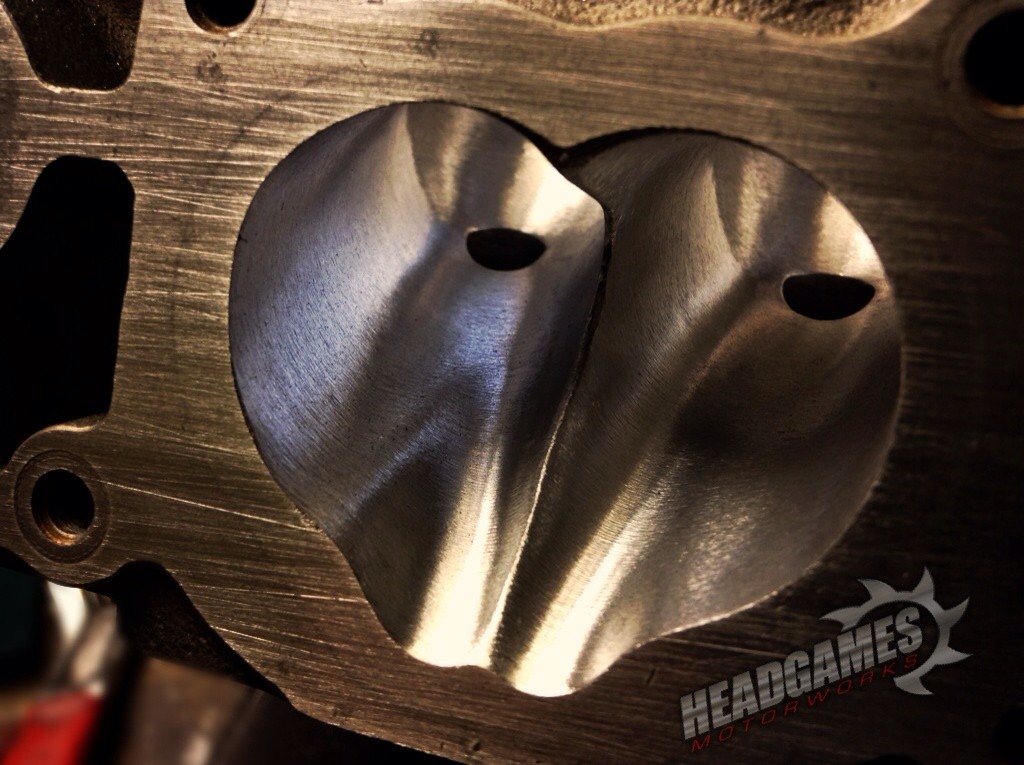

Haven't made a update in awhile. Roughing in the intake port

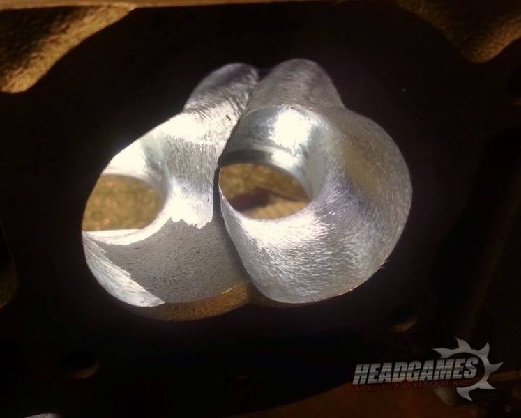

intake port ready for some HeadGames Motorworks valve guides.

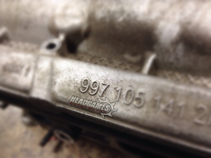

Work of beauty! Any chance on releasing the flow data?
Finally I cannot believe the 997 cams are cast so rough though.

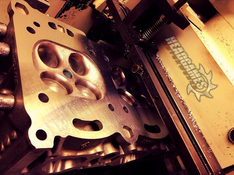

We have been super busy getting ready for TX2K and we are moving into a larger facility!
But, wanted to update the heads are done. This picture is the heads coming off our milling machine. Full update with a back-round of what was done coming soon!

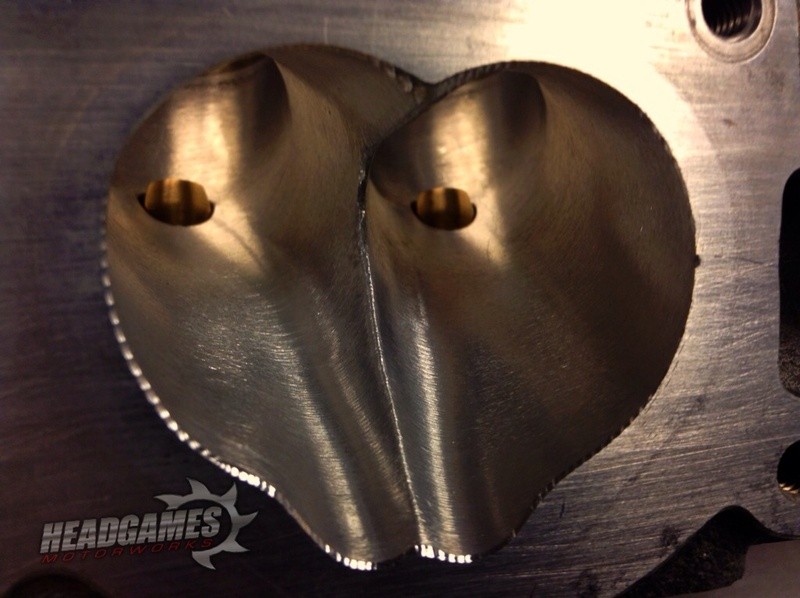

Intake port ready for assembly. That's our own bronze guides peaking through. More on that later...
