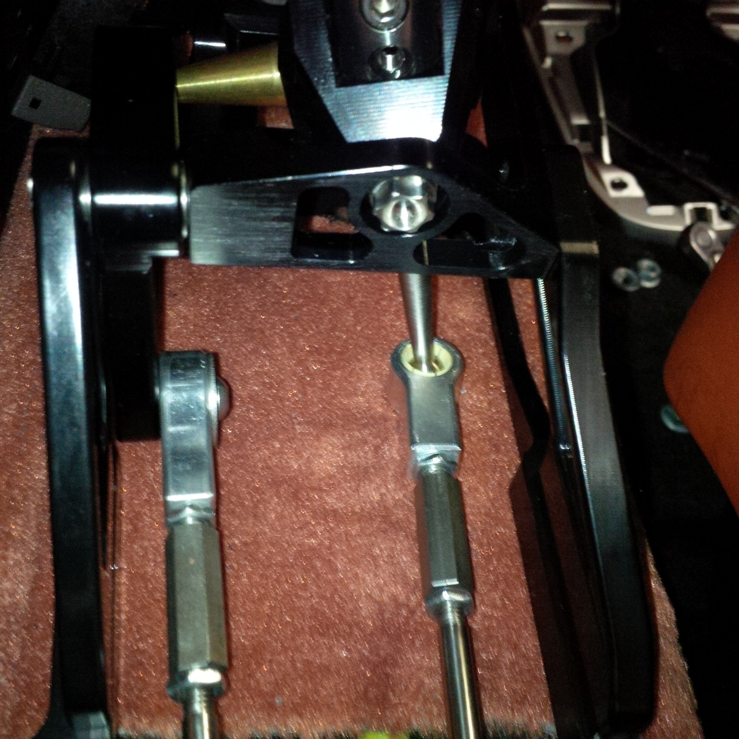

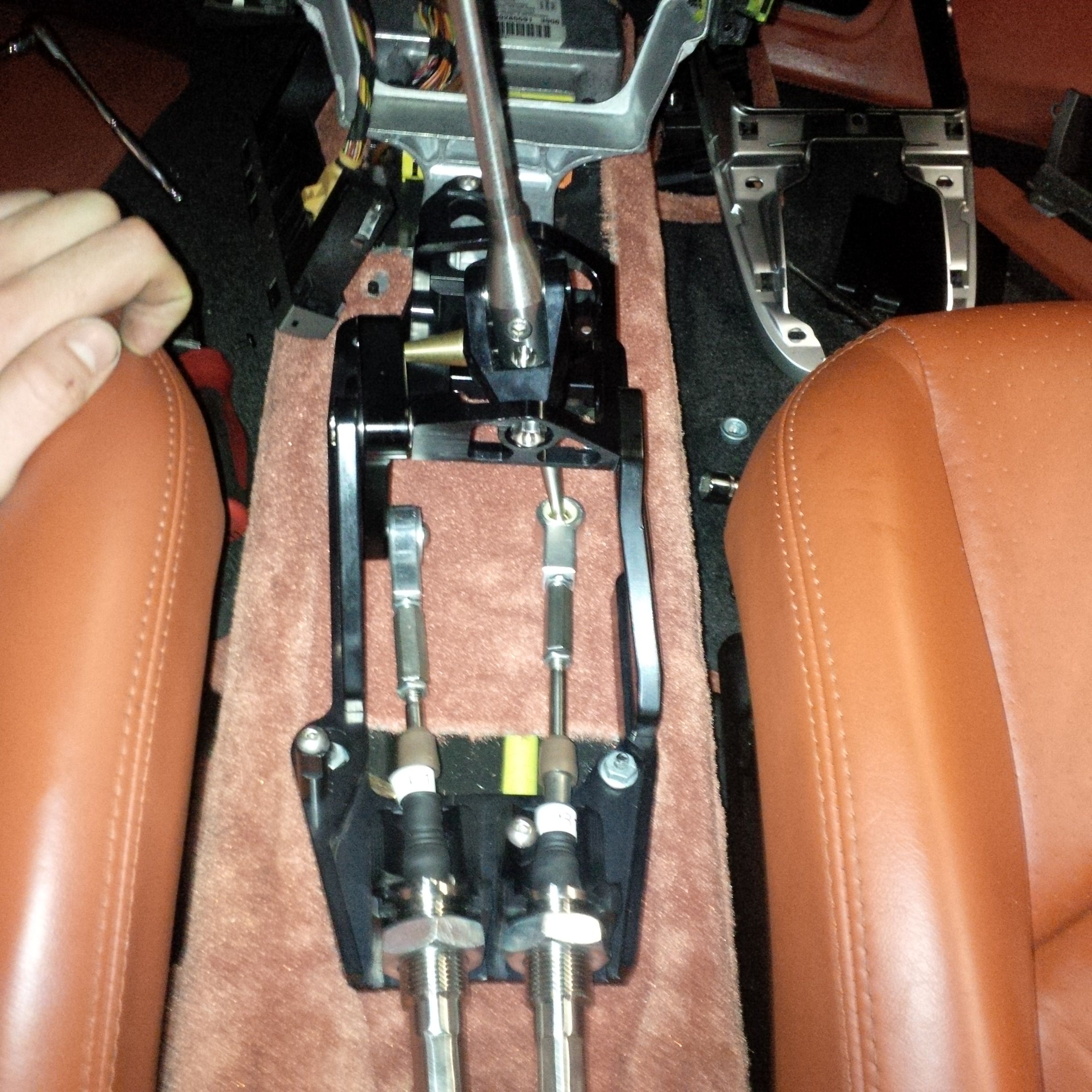

Fellas,
ive got a numeric racing shifter, cables, rss semisolid motor mounts on my car.
the cables FEEL amazing. perfect. the shifter takes effort to put in gear (in a good way. VERY solid, doesnt have that wiggle that fatory cables have). its kind of like a gt2 slave conversion but for the shifter (hope that makes sense).
anywho, theres quite a bit of chatter. very audible both on and off throttle.
i almost always have music playing so that i dont have to hear it but i dont want to deal with it anymore.
i want to have my cake and eat it too. what are my options ? sound deadening materials ? can i put rubber somewhere ? i was told if i went back to my gt3 ssk that the chatter would be significantly reduced.. but i love my shifter (i have it on the lowest setting and it feels amazing).
i know im not the only member thats experiencing this, so any help would be appreciated by a few of us.

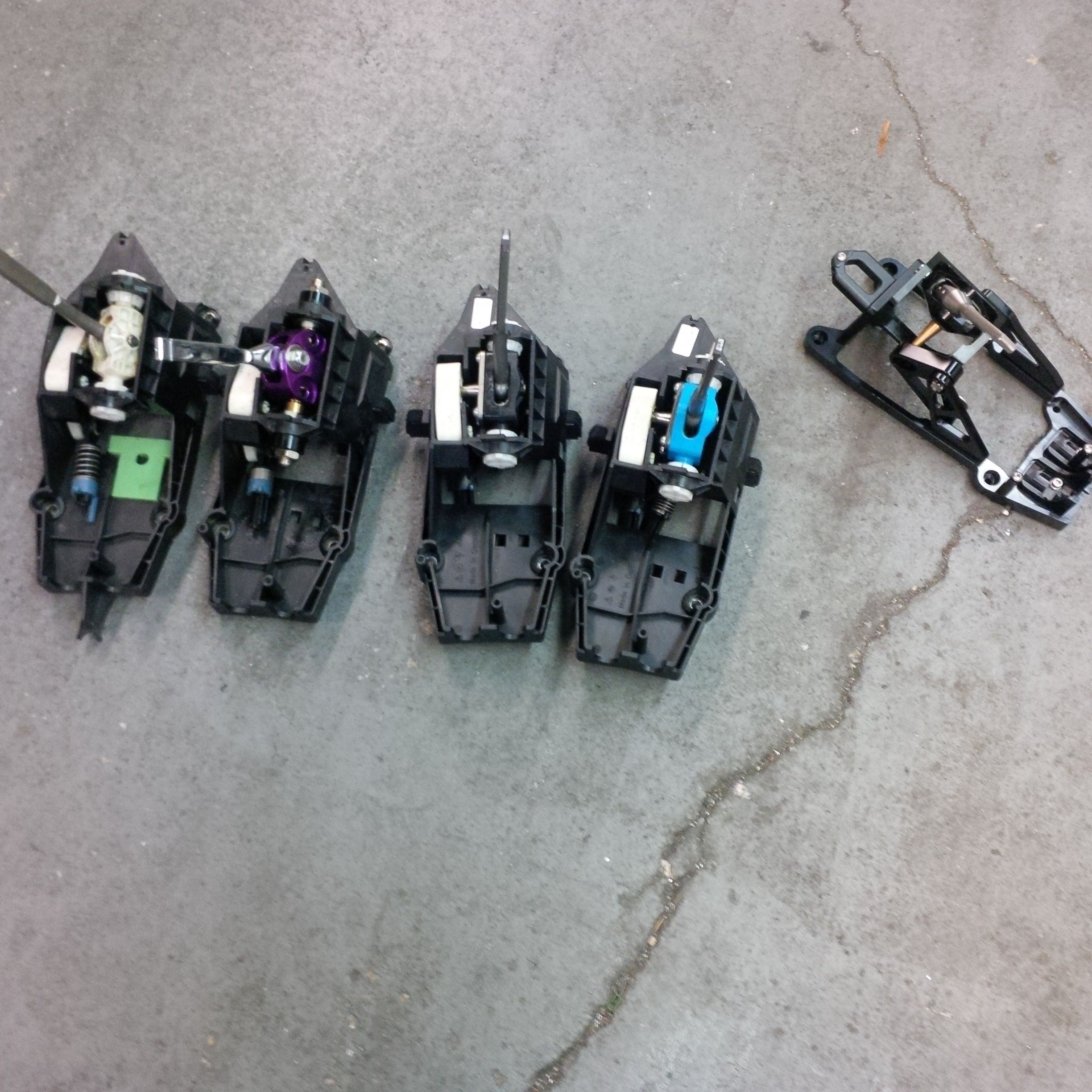

check out these pics. theres absolutely no play in the cables. there's gotta be a way to be eliminate or at least significantly reduce drivetrain noise.
(the pic of 3 sets of cables is cup car, numeric,and oem 996/997 cables)

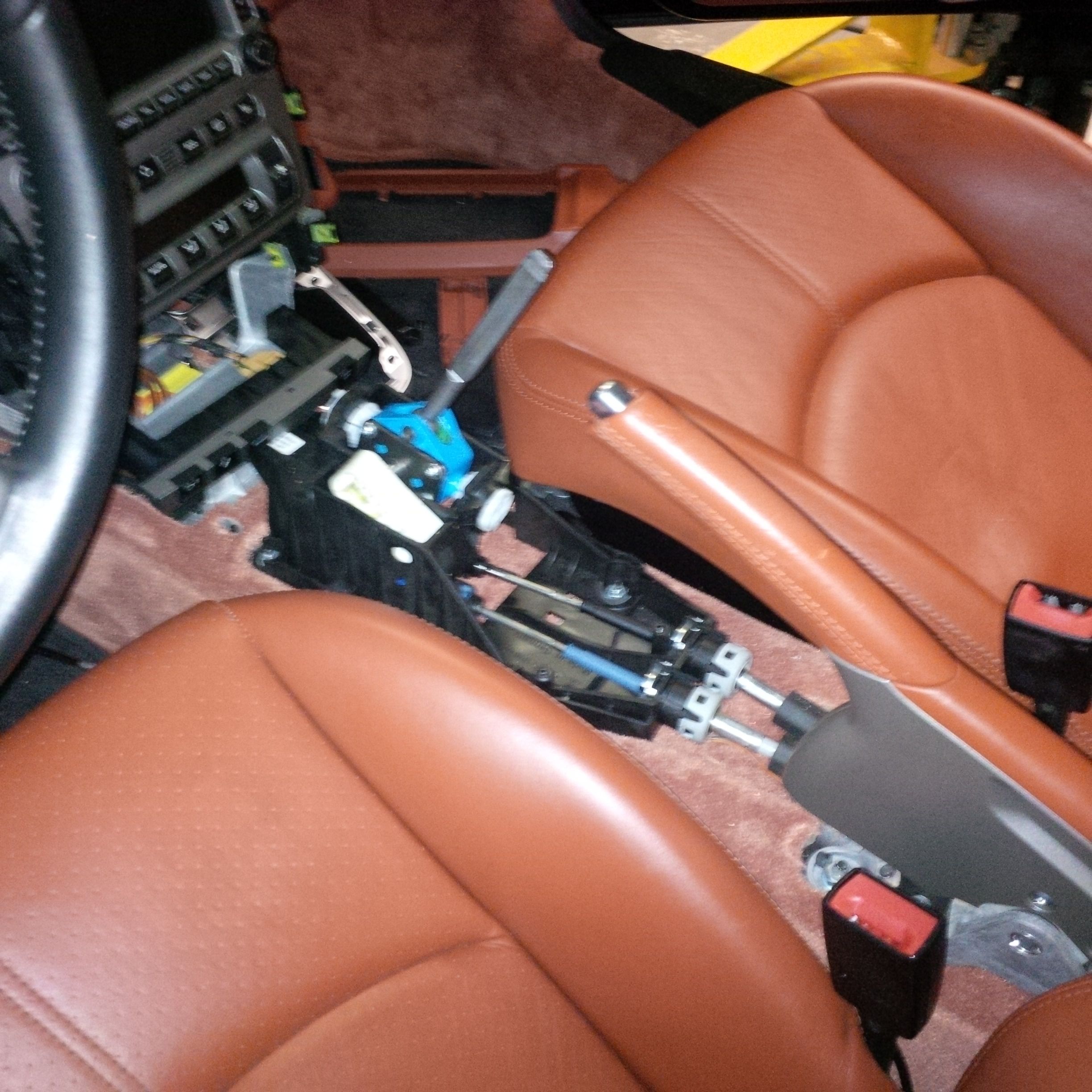

for comparision, look how much flex there is in the factory cables... you can see how theyre flexed even while stationary. the pic on the right his the numeric. look how straight and solid it looks.

theres virtually no chatter at idle.. its when driving... cruising... letting off throttle... the sound comes from the shifter area. the adjustments dont do anything to eliminate the sound.
im being told theres no fix and that the consequence of a precise shift with no play is chatter. im bummed. i tried to live with it but its just unacceptable for a DD. i took my friend for a ride and he thought my transmission was gonna explode.

Maybe that's the trade off with the sloppy, bendy, flexy cables vs the rigid larger, chunkier ones.
Or its amplifying a problem in the gearbox?
