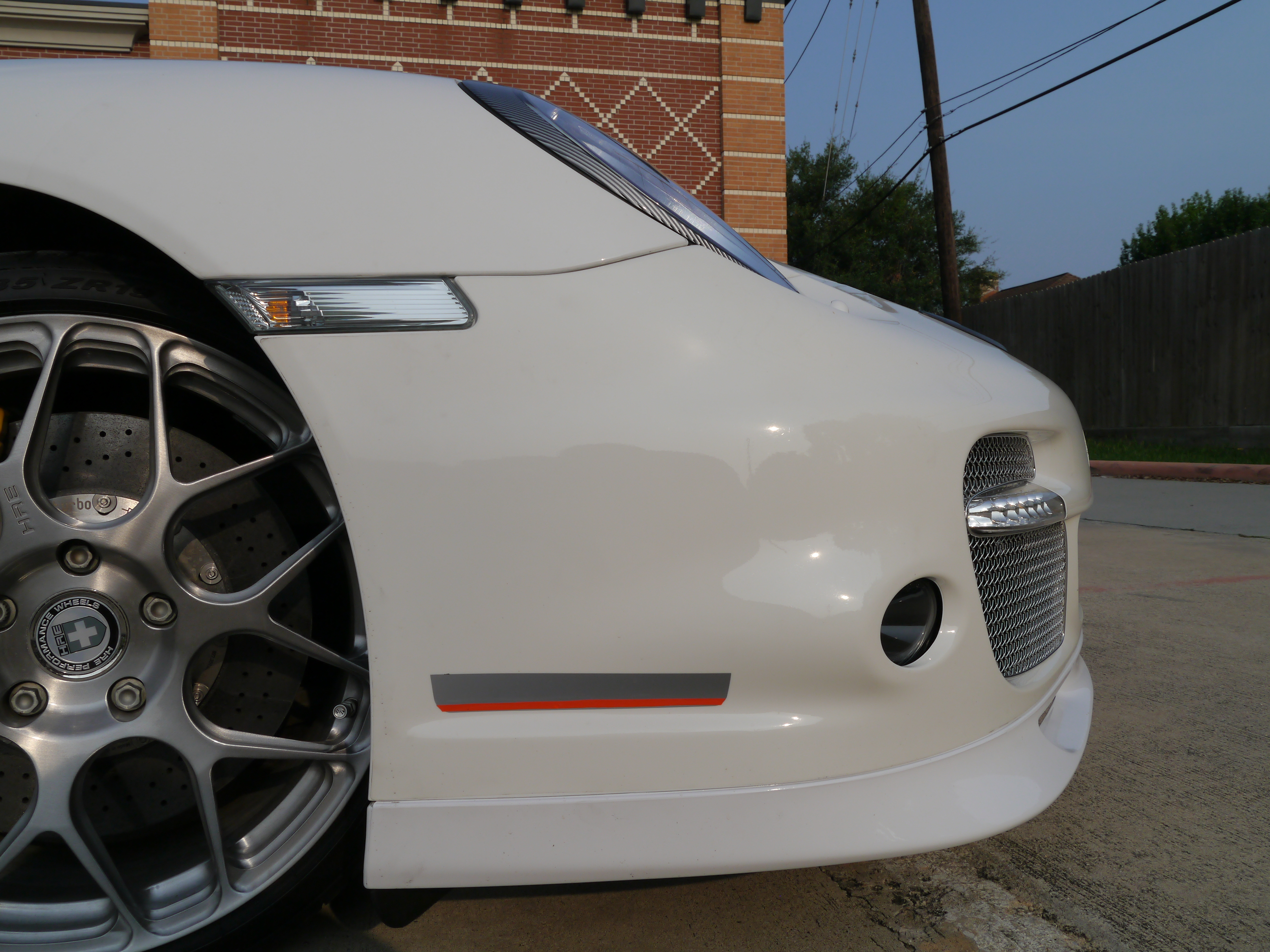

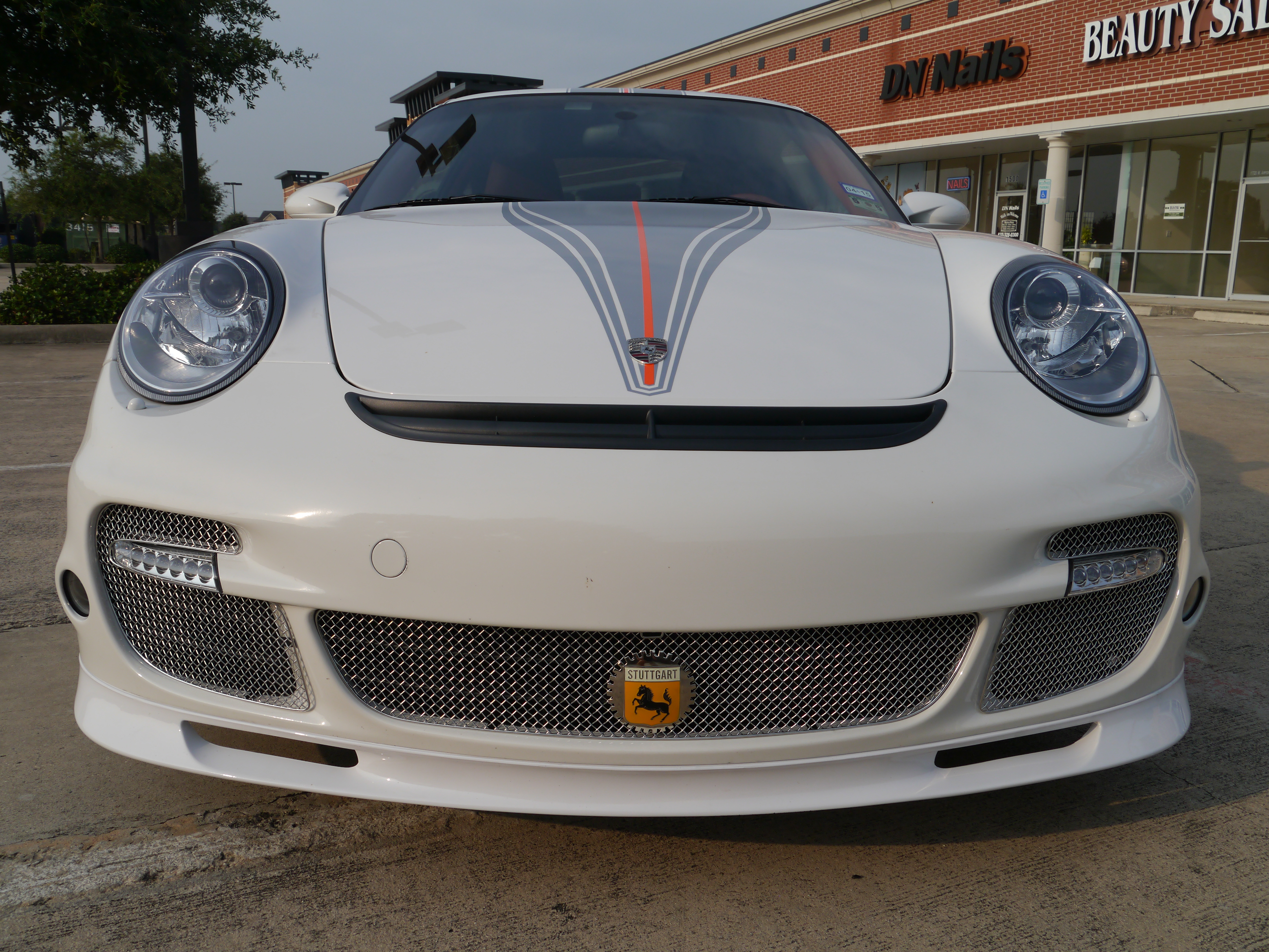

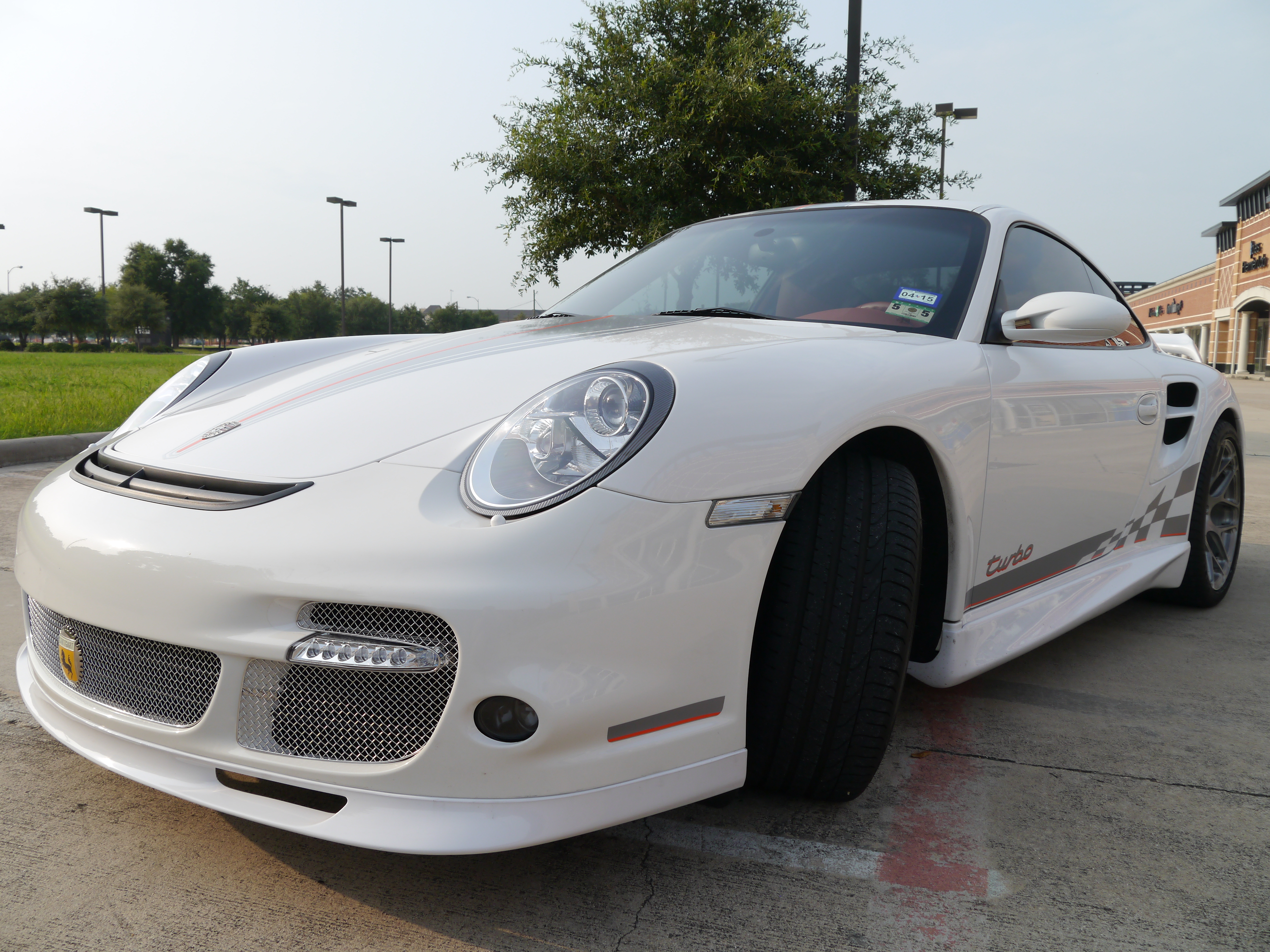

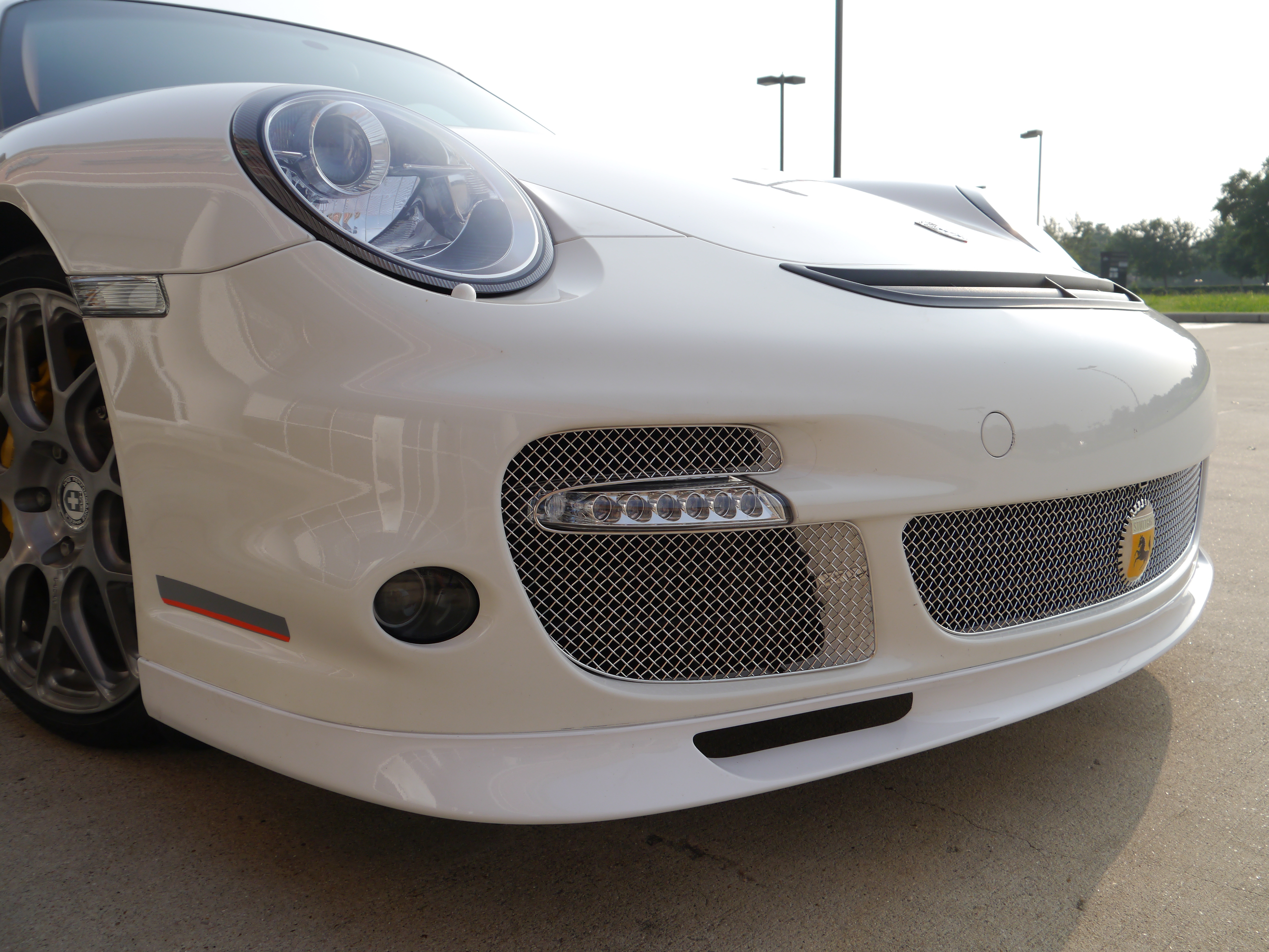

A few pics of the eBay GT2 style spoiler lip installed and painted white:
Attachment 396996
Attachment 396997
Attachment 396998
Attachment 396999
Attachment 397000
Your car looks great. Very nicely done. However paint color of your lip is noticeably off. I know white is hard to match but someone definately can do better than that. Also I don't like bumper grille crest. Looks cheap and 99% of people would think it's a Ferrari logo.

I was too cheap to have the yellowing clear bra removed from the bumper and replaced, hence the off color. Leave it to the discerning eyes of 6speed members to spot it right away.
The badge is one of those deals where you bought it and might as well put it on 'cause what else can you do with it?. If I get tired of it or more people tell me my car is not a Ferrari then I'll remove it, lol.

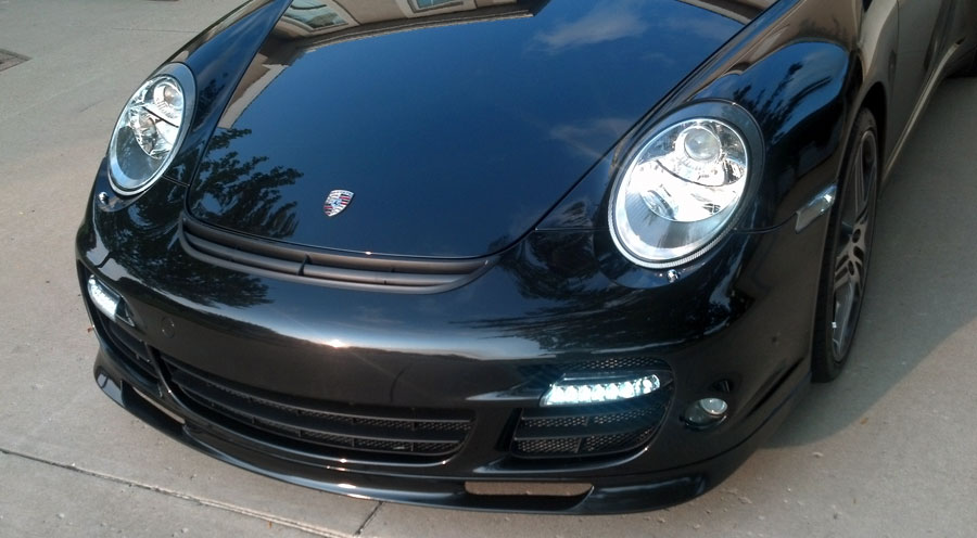

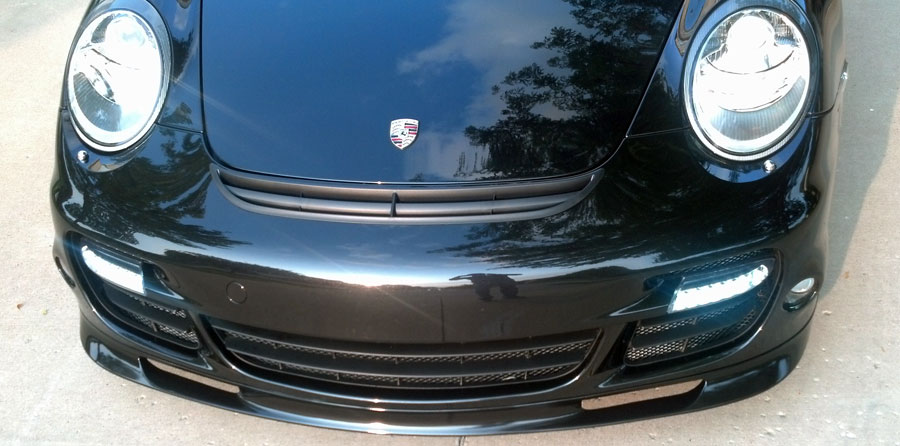

Got mine done yesterday and a couple pics. Process...Scuffed with 320-400 grit. 3 coats of Plastic Adhesion Promoter (wet coats..10 minutes between coats). 3 light coats of black Sand-able Primer. Scuffed wet with 600 grit. Wiped with Prep-all cleaner and tack cloth....Basalt Black Metallic base coat...One heavy coat covered due to black primer!...2 heavy wet (no runs! ) coats of clear....Came out pretty good IMO. The fit is good, but I plan on pulling bumper cover off soon to get it perfectly aligned and fitted where the spoiler meets bumper apron.
DC
ID:	397014   Click image for larger version
ID:	397015   Click image for larger version
