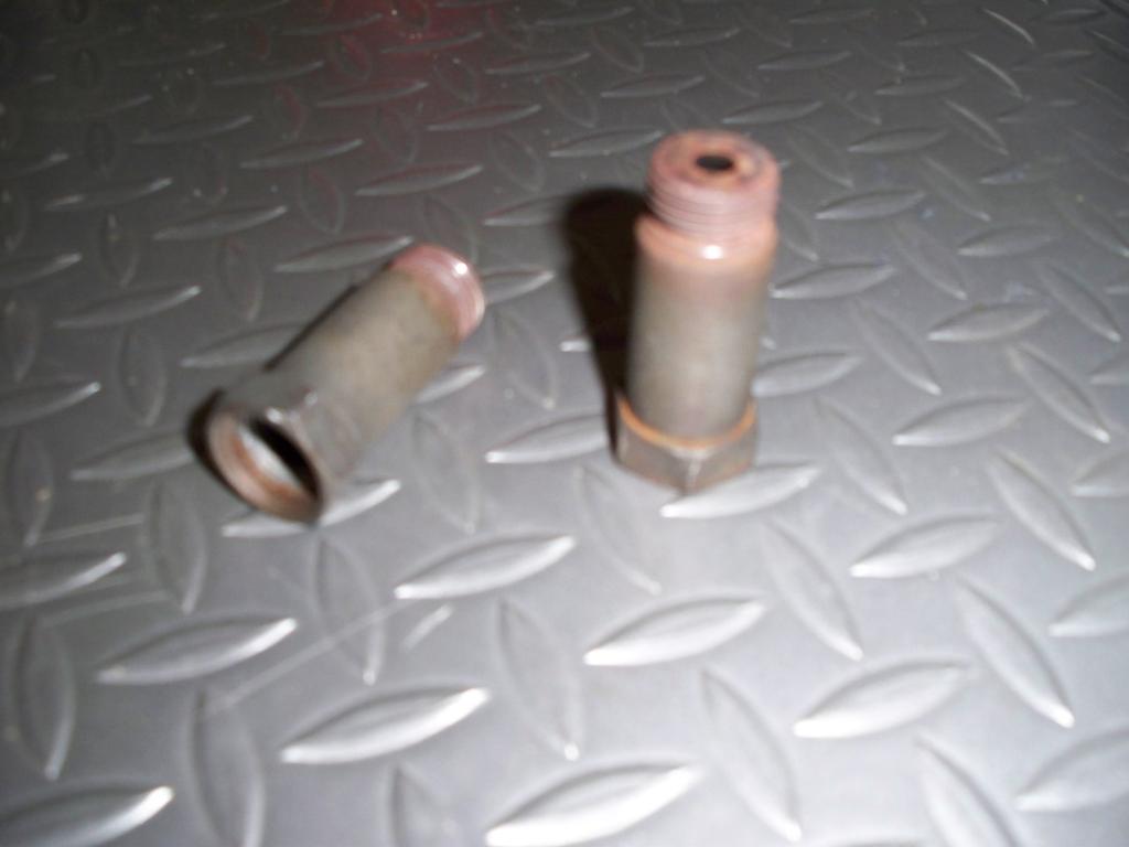

Just remembered these could help with the CEL.
It's a post cat O2 bung extension.
http://www.fvd.us/us/en/Porsche-0/99...r_Minicat.html
Ah yes bung hole extensions i have a couple of these laying around if you need them i'm not that far from you.
