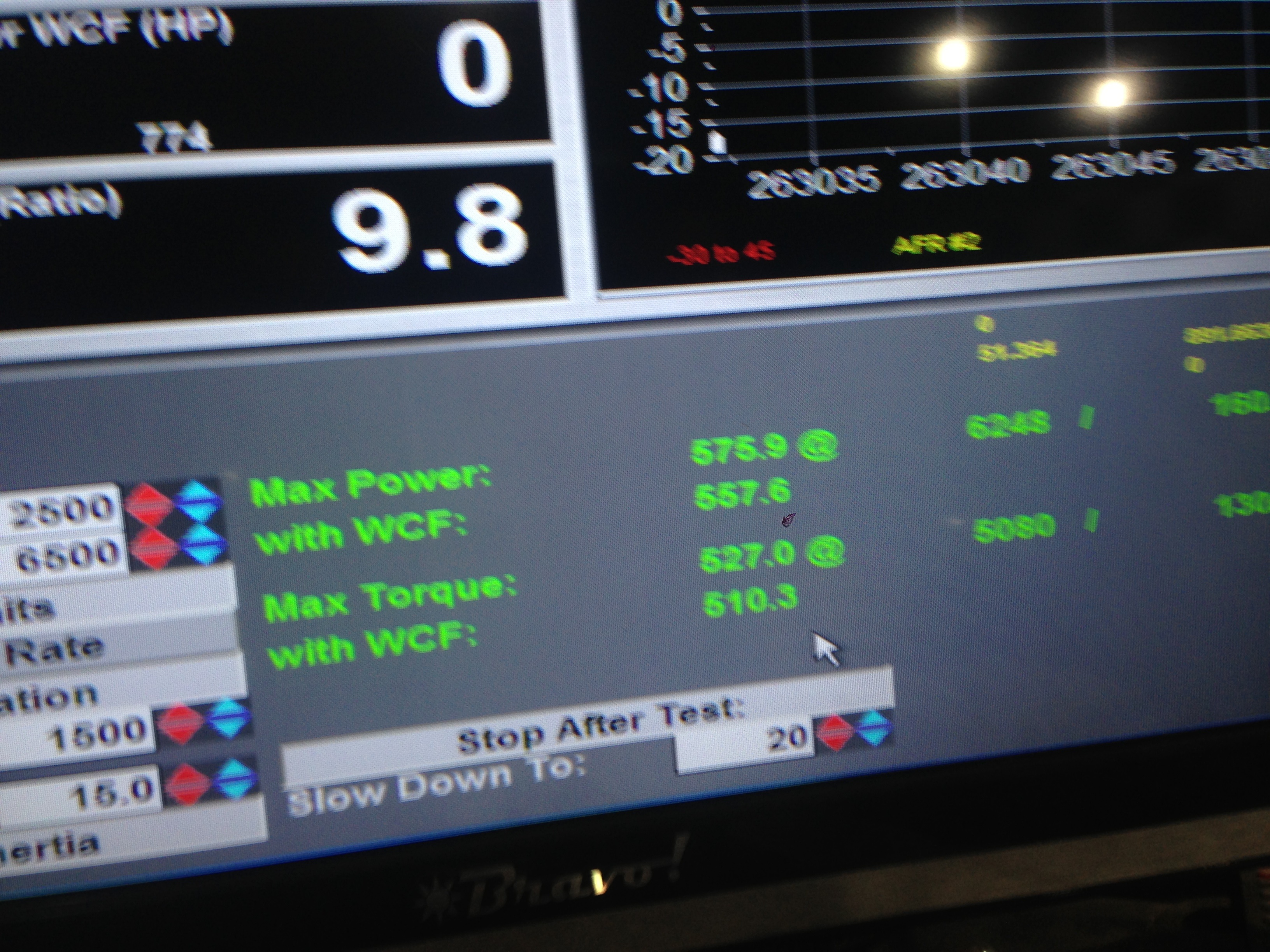

Photo of result

Something is wrong with that Dyno

Originally Posted by Najis997
What could be wrong ??
Don't know but it's not possible to produce so much power on your set up.
I would believe 575 bhp, not whp... it's weird that it gave 435?hp stock

Originally Posted by MegioN
Why so difference in spool? Seems like different turbos.
I have made on my second Porsche 497whp with flash and deleted catalics, 575 it's league of moded turbos or moded dyno
Looks like you need more information about reading dyno graphs.
If you look at the graph CAREFULLY you will see that the RPM's that they floor the throttle are different.
Bone stock turbochargers...
Same dyno, same settings, Yousef can chime in to give more information.

Hey brother I hate to break it to you but the numbers are 557whp and 510tq. You have to look at the WCF numbers that takes the weather correction into account. Still very impressive for VERY limited mods.
You cant use the non corrected numbers....if you do use non corrected numbers then I can make a 200hp car "read" 400+ hp on the dyno.
I would still be skeptical about the about the 557/510 numbers but hey maybe you got a freak car or EMRE has figured something out that other tuners haven't.....

Hello there , first of all special thanks to emre@esmotor for his magic building naji's car !! And congrats to the owner for his beast ,
As the dyno NUM , well i do not see or think its high because stock 997tt make (420-440whp) on the dyno , depend the weather temp , dyno temp etc etc .. ! But who care ??
All what i care is the change we did to the car and how much we gain , curve and smooth !!!!
