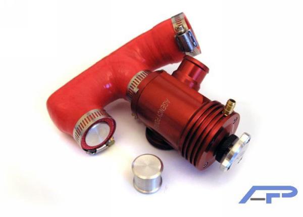

They are referred to and sold in aftermarket as BOV's, However they recirculate and technically are different then the in-turbo version on the 997TT.
996 Valve - Example only (NOT RECOMMENDING) - Listed as Porsche 996TT Billet Adjustable Blow Off Valve
