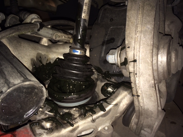

Zero mods, stock car. I think you're right on the torn outer axle boot though!
I went and jacked up the car in the parking lot, and spinning the wheel made a distinct clicking noise. Rotated the wheel to peak behind, and this is what I saw:
Is the boot the only thing that holds the CV in? It's completely loose, I am able to pull it away from the wheel.
How do I inspect it for damage and reassemble? Sadly, I don't own a lift. Just jacks and jack stands...
Also, is there anything I can do to secure the CV to drive it the 1.5 miles home to work on it in my garage? Any ideas how this could have happened?

If you are able to pull the axle, then it may be loose from the differential side. Its possible your inner axle boot it also torn. You cannot see this until you remove the cover on the underside.
As to why it happened, wear and tear! I am unsure about the drivability if there are other issues, but with torn axle joints, its ok for you to drive to the dealer. The grease looks very fresh.
Old Feb 10, 2014 | 01:53 AM
93ls1rx7's Avatar
Joined: Nov 2011
Posts: 800
From: Sumter, SC
Rep Power: 130
93ls1rx7 Is a GOD !93ls1rx7 Is a GOD !93ls1rx7 Is a GOD !93ls1rx7 Is a GOD !93ls1rx7 Is a GOD !93ls1rx7 Is a GOD !93ls1rx7 Is a GOD !93ls1rx7 Is a GOD !93ls1rx7 Is a GOD !93ls1rx7 Is a GOD !93ls1rx7 Is a GOD !
I was going to say your CV joint is out of grease and caused your CV joint to fail. You can drive it like it is for 1.5 miles, it isnt going to get any worse as long as you keep the speed low. The boot doesnt hold the joint together, just keeps the grease in and the dirt out.
If it has been torn for any amount of time you have gotten dust/dirt/grit inside the CV joint and it will need to be replaced. You could probably repack the CV joint and put a new boot on it but if it is popping/clicking when it is moving straight then the CV joint is most likely gone.
I would be worried that the mechanics didnt see that when they worked on it....obviously it wasnt torn that bad then but it still had to be torn....
