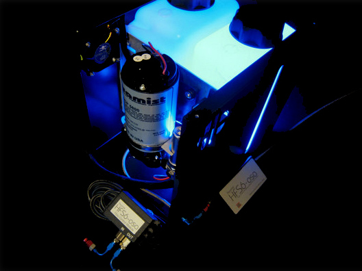

Failsafe and Flow Monitoring System
The DDS3 flow-monitoring safety system is the finest available in the water injection industry. It is capable of being fully integrated with any manufacturers injection system. The DDS3 uses the same flowsensor and gauge as the HFS-3 and GFS-4 systems. The unit is fully configurable for sensitivity of blockages and leaks. The control box has contacts for switching maps in the ECU(0-5v), actuating wastegate solenoids(NO/NC contacts rated at 1 amp), as well as other features.
This product includes the gauge/display, the flow sensor, level sensor and control box along with associated wiring.
For a little "bling" I like this also.........
It will light up the tank to see fluid level - tis also LED so no heat and will last a good long time.

Based on various opinions and I am sure, that of my tuner, I did some investigation and found this...................
Attachment 334385
