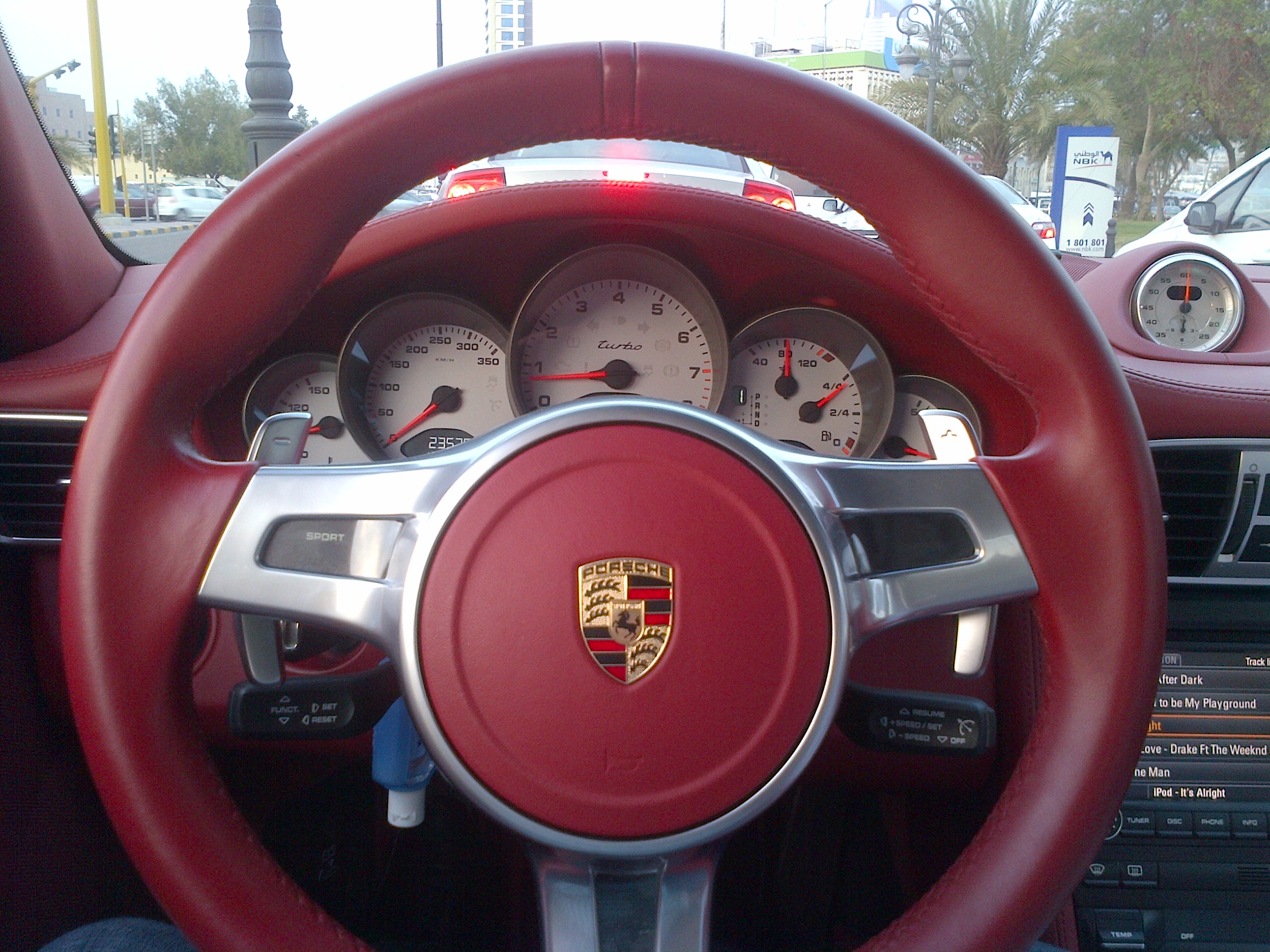

Well I went to the parts department and asked about my steering wheel, as the little screens which display (sport, sport plus, and launch control) seem to be damaged or fading (screens are not clear basically).
Can the silver trim be replaced by itself? Trim including the screens that is
Parts guy didn't know the answer

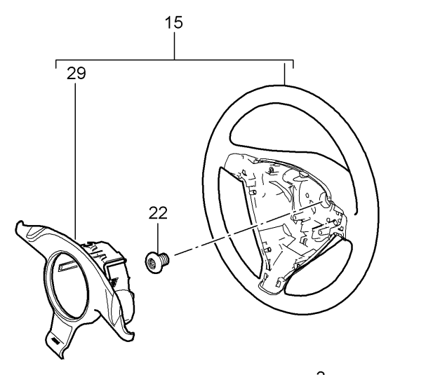

From the parts information available, it does not appear to be very servicable.
Looks like the center air bag cover in Car. Red is Part# 997 803 089 12 N14 and lists for $1083.24. The steering wheel has three separate components listed. The entire Steering wheel (various part# based on style and various prices), the center section as a module, and the bolt. No other parts or pieces shown and these all vary by yoru car with different part numbers and colors. Don't get hung up on the image...same image used for all styles.
So from what I can tell, just the button section would not be separate.
Hope that helps.and others may know different/more/better?

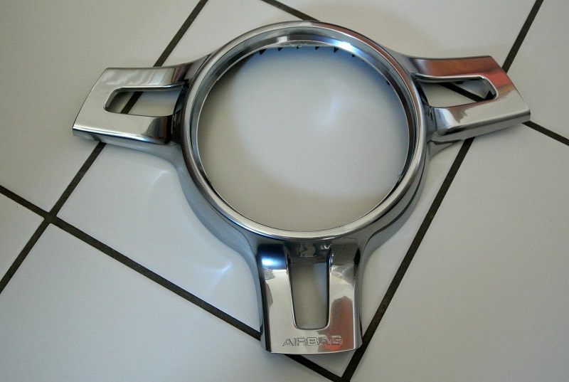

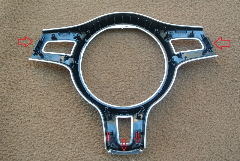

For some reason the piece you're talking about (and that is shown in the pics below) does not show up in any published PET diagrams from Porsche. On the sport wheel it's a trim piece that can be installed and removed without removing the wheel. The hub shown above in this thread is not what we have in our cars. I have attached a couple of pics that I resized. When I zoom in on the pic from behind I'm pretty sure the film (part that gets foggy) is attached, and it does not look like you can replace it. I got these from DB Carbon while trying to decide if I wanted to trade out the trim piece for a CF version--I do.
I think this is the answer--that you cannot just replace the clear film, but you have to replace the trim piece, but, what do I know?

I know members have changed it, at least some that have gone to the CF version. I sent an email to Daniel at DBCarbon about the film--whether or not it comes attached to this trim piece. My guess is that (1) if it's attached to the trim piece --part number still a mystery-- then you can replace the trim piece, or (2) it is NOT attached to the trim piece, and would explain why wheels seem to be getting replaced under warranty.
I will chime in later when I get a response. I spent a good amount of time a few weeks back trying to find a part number for this thing. I will let you know what I hear back.
