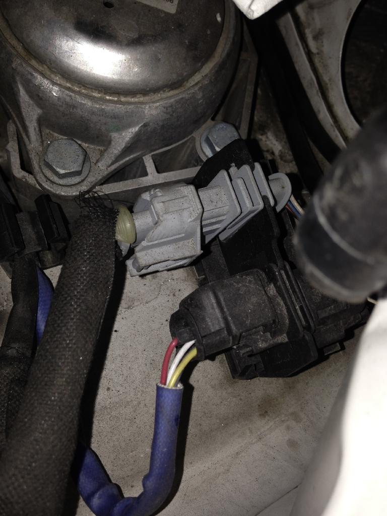

Is it any of those connectors?
The front O2 sensors came of quite easy.

Xbox yes those are the connectors you need to disconnect. There are a pair like that on each side.

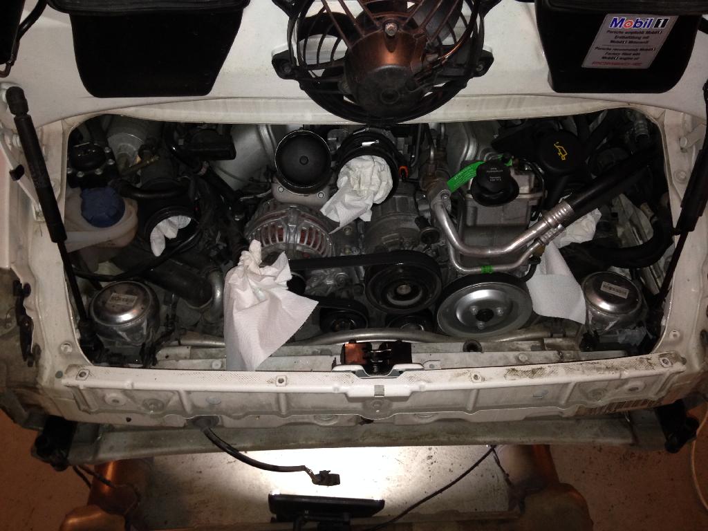

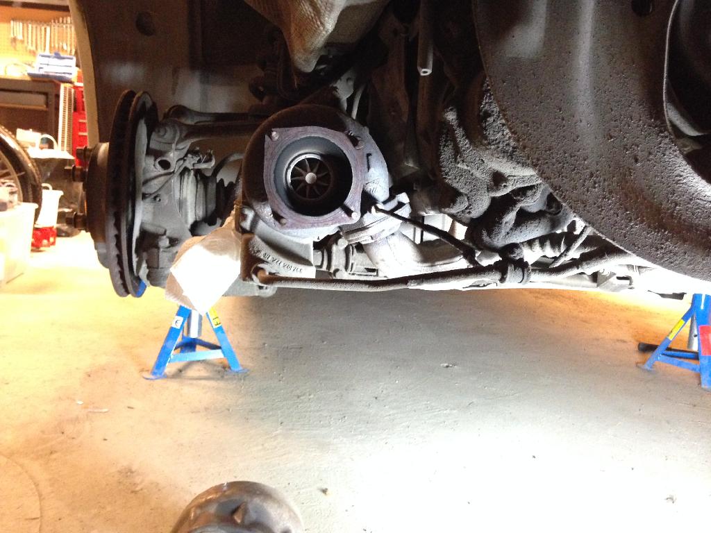

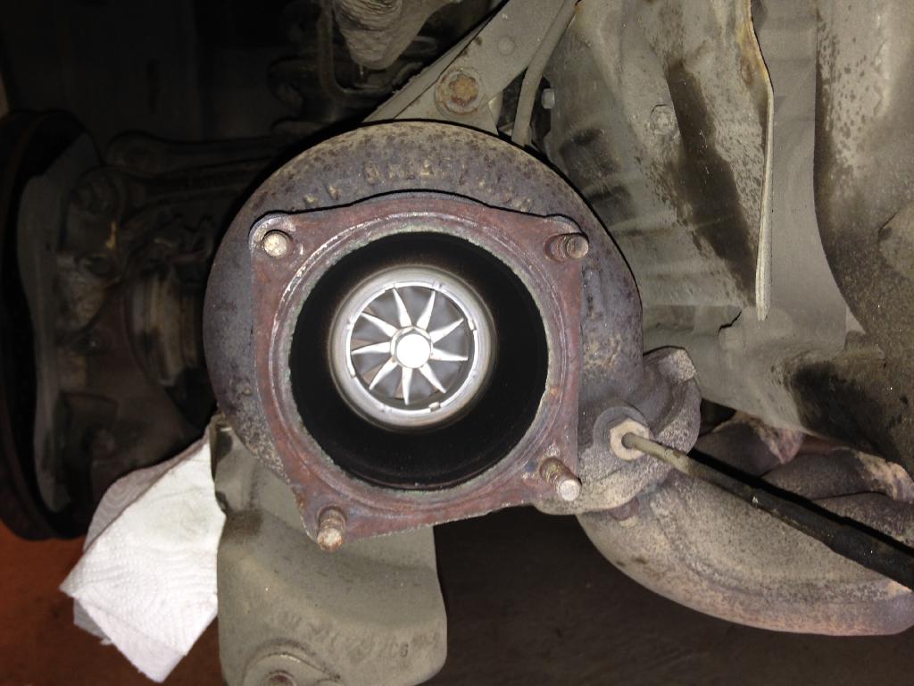

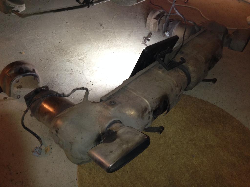

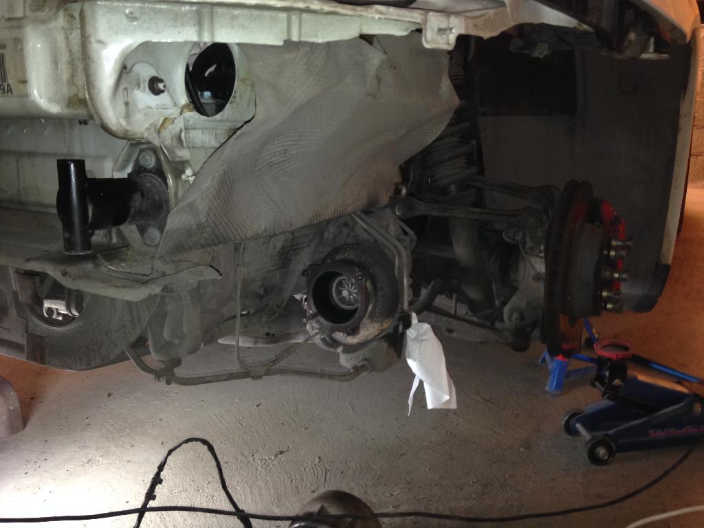

Good 1h session today, exhaust is off including removing y-pipe and airbox to get better access to o2 sensor cabels.
