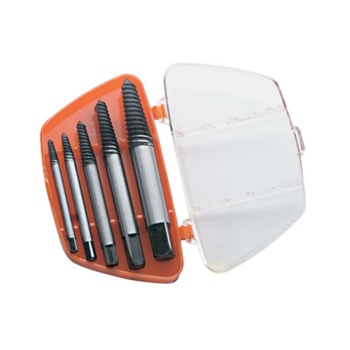

Originally Posted by tomb18
So how do you remove a broken stud when it is flush like that?
Typical process for this is you drill a slightly smaller hole in the stud remnant, and then use a tool called an easyout, which is reverse threaded...So as you turn it counterclockwise, it tightens and removes the broken bolt/stud. You would want to really soak it first with PB Blaster or similar penetrating oil.
If that fails, or seems ineffective, you may have to weld an extension to the stud and then back it out that way.
DC

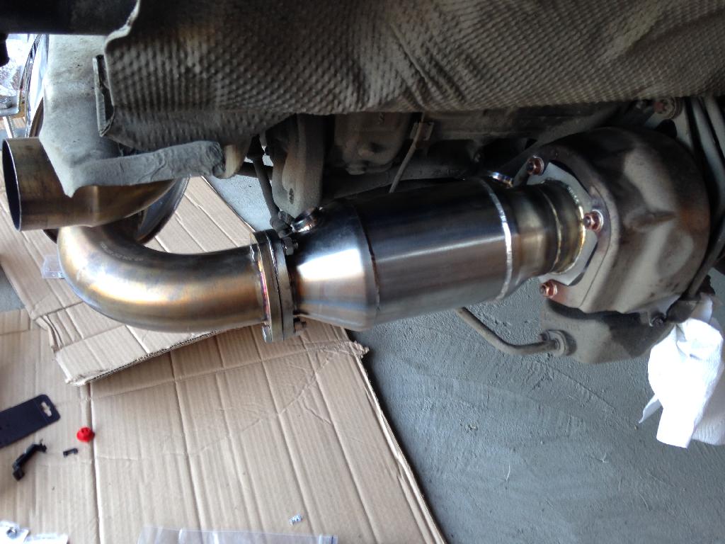

I ended up reusing the old studs, after cleaned up they looked just fine and install was very simple.

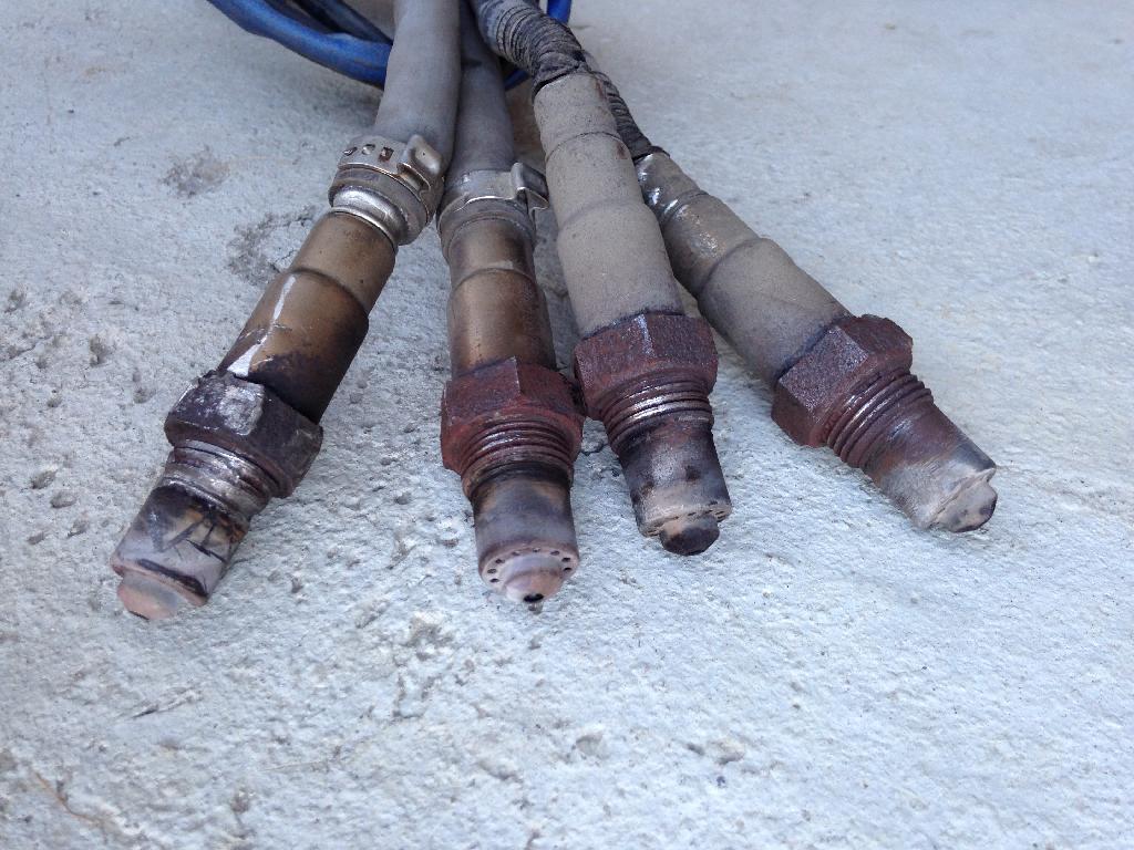

I am going to order new rear o2 sensors as well, the threads on them looks quite bad as well.
The Kline looks like this at moment, with bmw nuts

Posts: 115
From: USA
roybotnik is just really niceroybotnik is just really niceroybotnik is just really niceroybotnik is just really niceroybotnik is just really nice
Silly question but what size are the nuts? I went through a similar problem when I removed my stock exhaust, ended up paying $800+ for a shop to finally get it off. I have new porsche studs and nuts on the car but I would like to switch to nuts that aren't going to weld themselves to the car. Getting a different exhaust pretty soon. Those copper nuts look like a good idea.
Old Mar 28, 2014 | 09:25 AM
  #44
93ls1rx7's Avatar
Joined: Nov 2011
Posts: 800
From: Sumter, SC
Rep Power: 130
93ls1rx7 Is a GOD !93ls1rx7 Is a GOD !93ls1rx7 Is a GOD !93ls1rx7 Is a GOD !93ls1rx7 Is a GOD !93ls1rx7 Is a GOD !93ls1rx7 Is a GOD !93ls1rx7 Is a GOD !93ls1rx7 Is a GOD !93ls1rx7 Is a GOD !93ls1rx7 Is a GOD !
The nuts are M8 (1.25 thread pitch)
