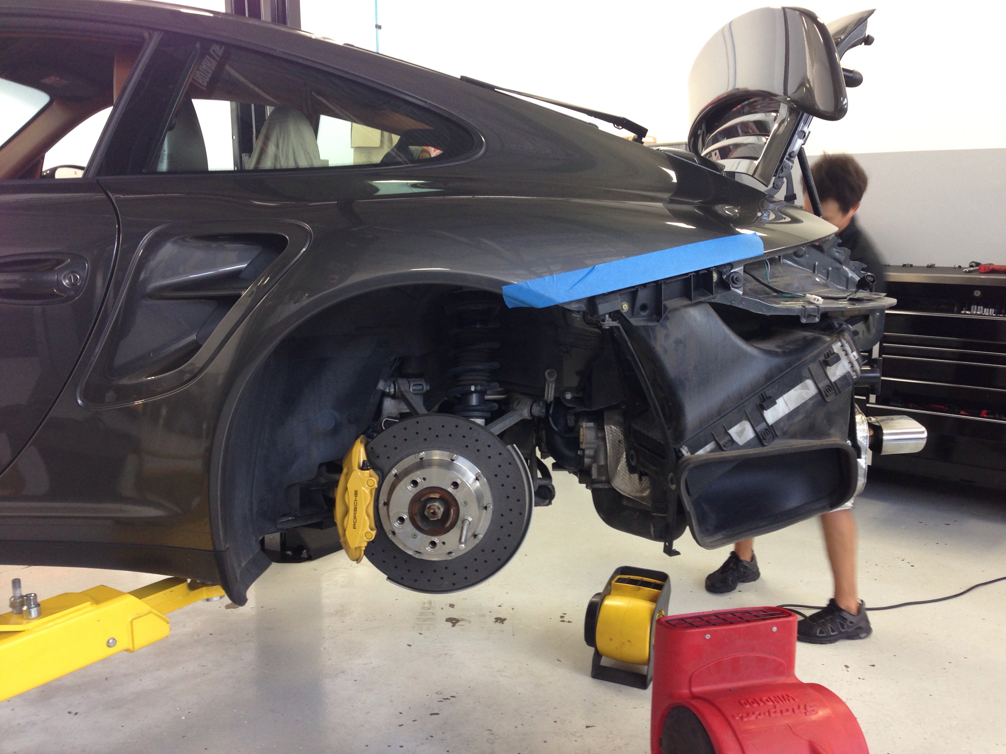

Cool
Unfortunately I think the intercoolers may have been removed. Can you tell from this photo if they're factory or aftermarket?
Either way, it's comforting to know I have a solid tune.

It LOOKs like plastic end caps to me...champion definitely doesn't have plastic end caps....so looks like someone swapped them out.
That would have been a MAJOR score!
