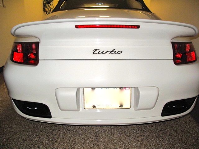

Now that I have missed my car for the past six months and finally having some semblance of spring I am ready to enjoy it again.
Having been inspired by some recent posts and pics I have been inspired to black out my tailpipe tips. I was never really fond of the chrome finish and found that it was very difficult to keep clean. Besides, I really think that there is a minimal need for chrome on these cars. I am very pleased with the results.

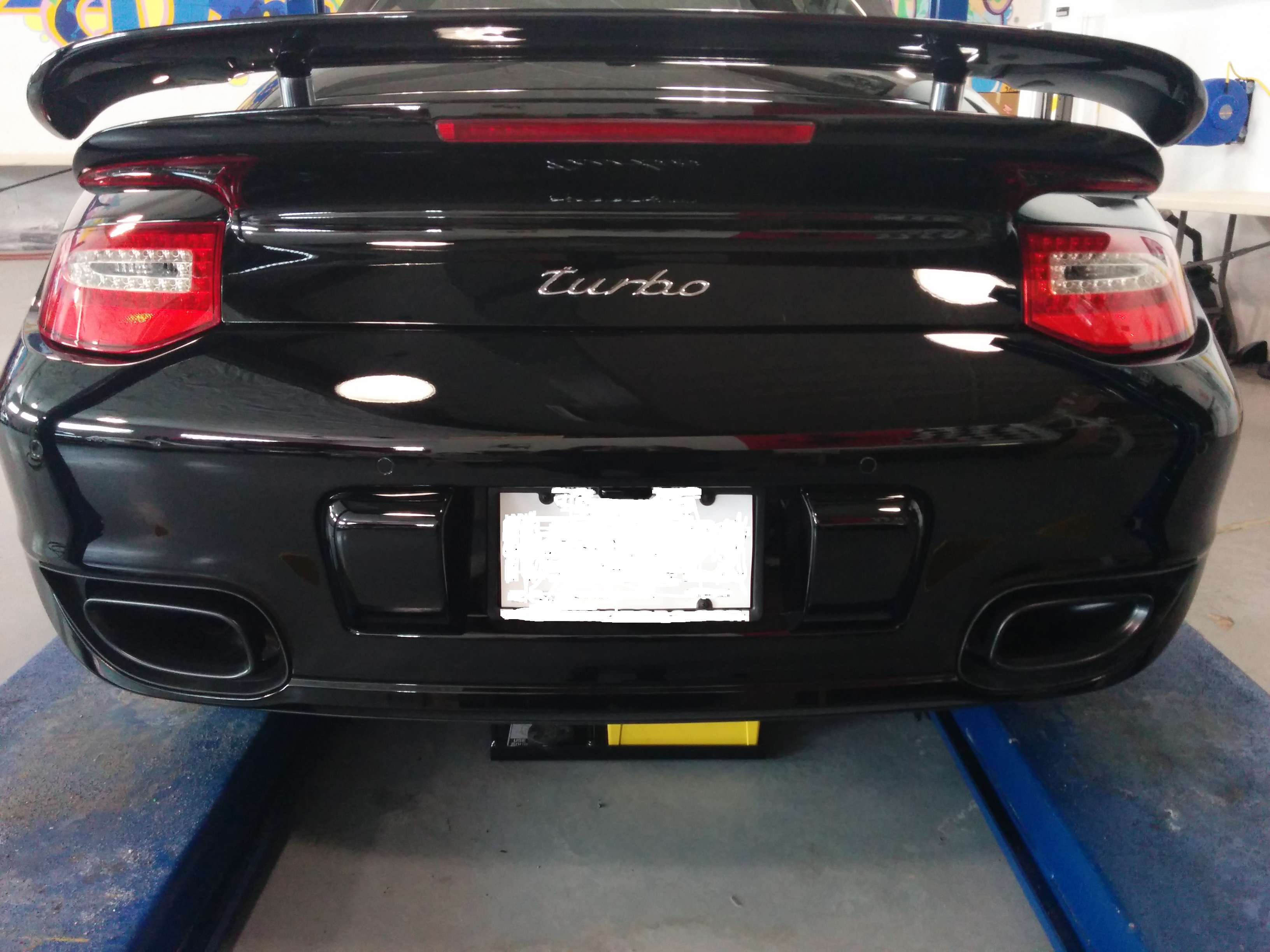

I ended up having it done for me because it was at a shop already for clear bra, radar/laser. I love the black tips. The chrome was dirty every time I drove it.

I used a high temperature paint (actually black caliper paint) from my local auto parts store. I think any brand will work just as well, don't imagine there's a difference between brands.
It looked like a flat black on the can cap.
Instructions required baking for 1 hour at 200F to cure. Once finished they appear to have a bit of a glossy shine to them.

My mistake. I just told Detailing Dynamics I wanted to tips painted black and wrongly assumed they were powder coated. I just emailed Eddie and in fact it is ceramic.

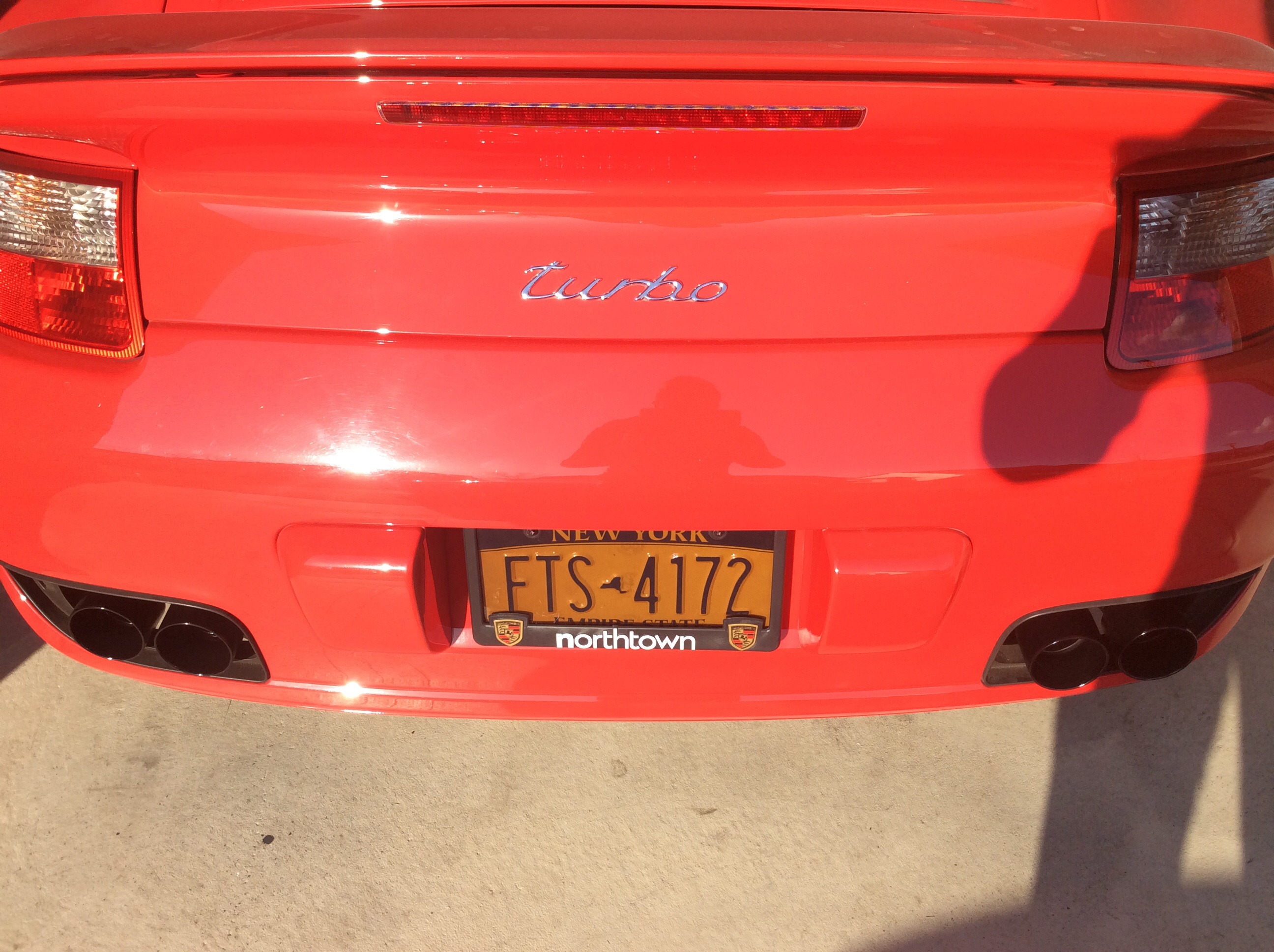

Finished my tips today!

Nice, but it'll look nicer with the turbo emblem painted the same way, just a personal thought...
