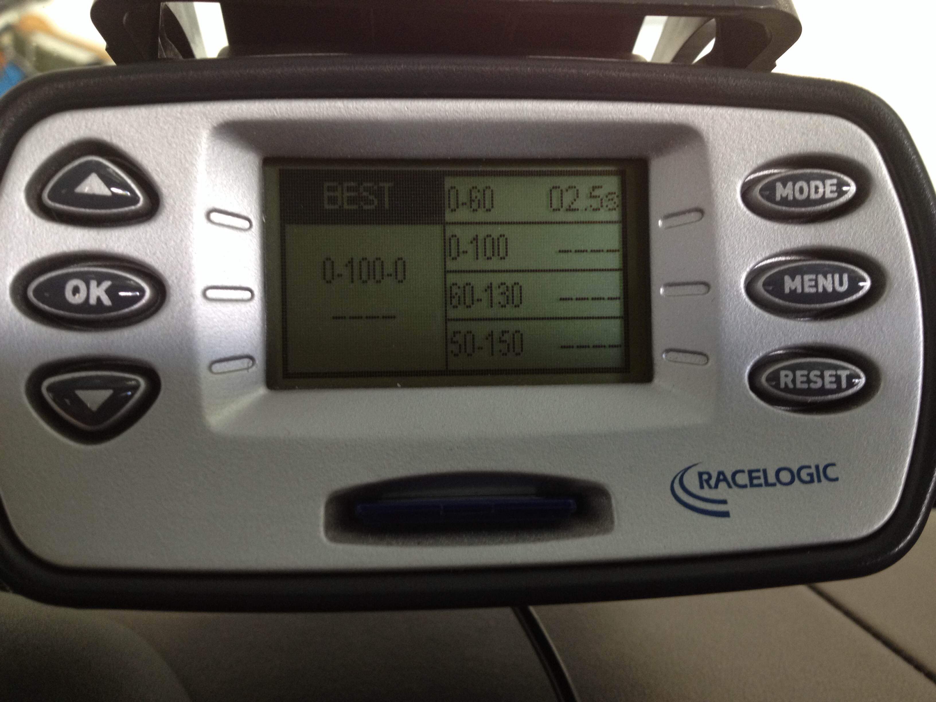

What's up guys. So after upgrading to the Champion/GIAC Stage 2 file on my 997.2, the stock tires (Michelin Pilot Super Sports) could no longer handle launch control. The PSS were spinning a lot from the increase in torque. Sometimes the car would even go sideways. At this point the best launches I could achieve from a dead stop were coming from simply flooring the car off idle. Even in poor conditions (dusty airstrip running over a partially-painted surface), I was able to cut 0-60mph in 2.7 seconds (racing a Stassis S/C v10 R8 and also doing a solo run). This was ok, but I was able to cut some 2.6's at the drag strip on the Stage 1 file with the PSS so I knew with better tires I could improve. (by the way, the 1-ft rollout was enabled on the vBox).
Given that I will eventually track my car and use it at events where optimizing the launch is necessary (Airstrip and Dragstrip events), I replaced the PSS with Toyo R888's (which I understand from a number of people are simply the best street tires for off-the-line traction, and they are also decent track tires as well).
After tire install and break-in, I did some 0-60mph vBox tests on some local uninhabited public roads. Despite the grip being much better, I was only cutting 2.9 to 3.1 second 0-60 runs as the transmission was getting "hung up" on the 1-2 shift. The best way I can explain this is that the shift would literally take half a second to complete and of course the nose would dive down and then back up as the shift completed. It seemed like traction control was on but it was off. I tried launching about 5 times and the same thing happened each time.
Some friends invited me to the drag strip last weekend and even though temps were 100+ degrees, I figured traction/launching should be better with a prepped surface and hot temps. Well, unfortunately the same thing happened....using Launch Control, the 1-2 shift kept getting hung up. Even my buddy who was watching was like WTF did you let off the gas or something? vBox was on and the results were 2.9 to 3.2 seconds on my three botched runs
I was kinda bummed, but knowing others have used Launch Control on the PDK, I made an assumption that maybe it just needs time and more launches to adapt. So I went out to my local uninhabited road and tried again.
Sport Plus, check, PSM off check. Brake on, Accelerator to the floor and BAM! Takes off like a rocket with some tire spin but the 1-2 shift is perfect. 0-60 result...2.5 seconds.
So there is it. Hopefully this wasn't a fluke and the PDK will continue adapting affording the car the ability to cut quicker and quicker launches. 2.5 is already in Veyron territory but I hope to get the times down to 2.3 or 2.4 and on a more consistent basis.
Anyway curious if anyone else has experienced adaptation in the PDK when increasing power/grip like I have?

Great run Longboarder, 2.5 secs (0-60mph) is simply amazing! Congrats.
I experienced something similar to what you described once (i.e., shift taking about half a second to complete and the nose diving down aggressively). This occurred the first time I really "floored" it from a standstill after uploading the FVD tune. Vehicle conditions were; car at idle, Sport mode on, PASM off "comfort setting" and PSM on...when I punched it, the 1st-to-2nd gear shift was so cluncky and uncharacteristically slow with the accompanying "front-end dip" that I let off the gas pedal (I thought I had broken something...)
I drove around in Normal mode for about a 1/4 mile and the PDK shifted normally so I came back around and tried a "Launch" (Sport+, PASM On, PSM off) and no issues! I was relieved. I did my test-runs immediately afterwards. I suspect the PDK needed some time to adjust its shift-points in response to the increased boost and TQ from the tune (it felt like the PDK had shifted prematurely and needed to hold 1st gear slightly longer given the raised rev limit). It only happened that one time, and never since, so I chalked it up to an adapting issue.

Hi Tom, interesting thanks. I guess I just need more seat time to figure out what the car likes best. By the way what is a PIWIS? Is that similar to the Durametric?
Ok thanks for the info. Bottom line is that both I and the PDK need more launches. Hopefully one of us will figure it out haha.
