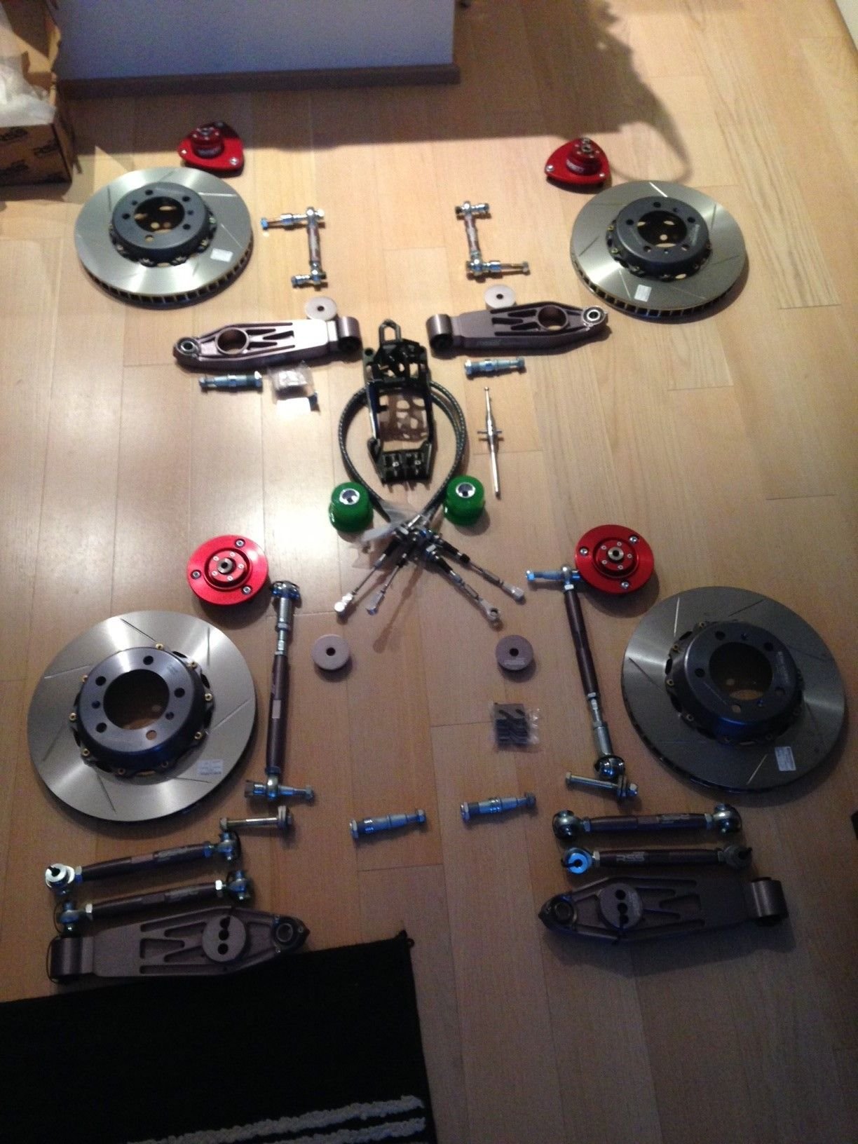

It's been a few months now that a strange creek has developed from the front of the car, and progressively becoming worse (after spirited driving or any prolonged drive on a hot day). Going consensus is that it is the front Control Arm.
I figured, if I'm replacing that, I might as well replace some other suspension parts.
Currently my suspension setup:
1) RSS Sway bars (front and rear)
2) RSS Rear drop links
3) RSS Solid engine mounts (best bang for the buck upgrade money can buy IMO)
Bilstein B16 Damptronic (had serious problems with these and wouldn't go this route again - but that's another story).
Just those little changes (above) have dramatically increased driver feedback and dynamics over stock.
As for new components...
These are going in on Monday:
1) GiroDisk rotors (mine are pretty much toast, so thought I might just do them at the same time - and they are lighter than OEM, and have received substantially better reviews over OEM)
2) RSS Lower Control Arms (Front and Rear)
3) RSS Adjustable Rear link kit (Dog Bones)
4) RSS Rear Adjustable Toe Steer Kit
5) Rear toe locking plates
6) RSS Front Adjustable sway bar droplinks (to get rid of those laughable bilstein B16 toothpicks )
7) RSS Dustboots, not included in pic, but great little add on to preserve the life of the joints for a daily driver.
8) Tarett front and rear camber plates.
9) Numeric Racing Performance shifter
10) Numeric Racing cup cables
11) Numeric Racing solid transmission mounts (road)
And...
12) Front windscreen - Not included in pic, but the thing took a rock big chip a few months ago.
I'd like to thank a few guys that helped me with the order:
-Dan at Numeric Racing, thanks for details on transmission mounts, setup, and other info.
-Mike at RSS, who was incredibly helpful in helping me understand exactly what components are absolutely a must, and the perfect performance handling setup.
...and Finally Ilker at SportsCarBoutique (RSS, GiroDisc) who sourced 90% of the components and shipped them to me. It took a while to get everything in, however the service and prices just couldn't be beat anywhere else (I'm in Canada).
Thanks All - and I'll keep you updated once everything is fitted.

Quick update: got the car back yesterday, and holly crap does it feel better. Substantially more planted, just feels more- for a better word "solid". I have 100,000 km on it now and had a few squeaks developing, all of those are gone!
We made a few adjustments to the above mentioned alignment, but core was still -2.5 and -2. With those setting there won't be more perceived tire ware (I had -2 / -1.5 previously) - so I wouldn't put any weight behind those that say otherwise.
The biggest difference is in the Numeric shifter, cables and T-mounts.
Shifting felt so precise and, well perfect, I had a bit of a giggle.
My recommendation - if you like rowing through manual gears, enjoy a proper heel and toe, GET THIS MOD! Seriously it blew my mind how much better shifting feels and how it changes the driving experience for the better.
Will post pics soon.

My crap-steins (Bilsteins) are failing again. No errors but there is a cluncking noise coming out of the drivers side, after 30 min or more of hard use. This is the third fail, and I may just replace all four. The decision is a tough one as I have been hearing fantastic things about the TPC module - but that requires PASM compatible shocks. Everything else worth even a consideration does away with PASM.
Regarding the other components...
Honestly it's perfect. The difference between stock and my setup is night and day. Turn in is super crisp! Even thrashing it through a tight slalom feels very comfortable and responsive. The big difference are the solid mounts (engine and transmission). Every imput is respected immediately - its amazing the diference in controll and feedback.
The cons:
There is some transmission noise in the cabin, it takes some time getting use to. Keep in mind I have solid transmission mounts and cup cables (no rubber). These feed some resonance back into the cabin. In 5th and 6th gear, when you get off the throttle one can hear a slight gear whine feed back into the cabin. Mid corner or just post, shifts (although rare, when required) are scalple sharp and they feel sharper and allow you to pull them off much faster/easier with substantially lower probability of missing a shift.
Overall I would highly recommend these updates.
Contrary to other statements, other than the transmission noise (from the cup cables and solid mounts), there is no cluncking or other noise coming from such a set up.
...other than the Bilsteins that are crapping out on me again.
The only other issue I have is a vbration at over 240kph.
This is probably just a ballancing issue I need to take care of
The only other update to this setup was adding 15mm spacers in the front, extending the front track by 30 mm.
