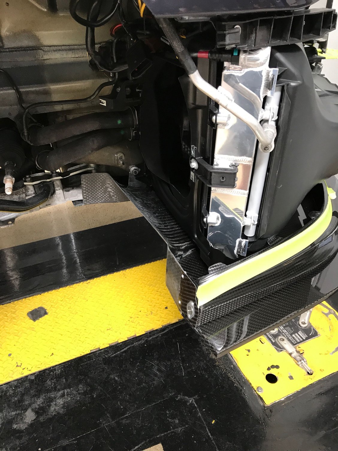

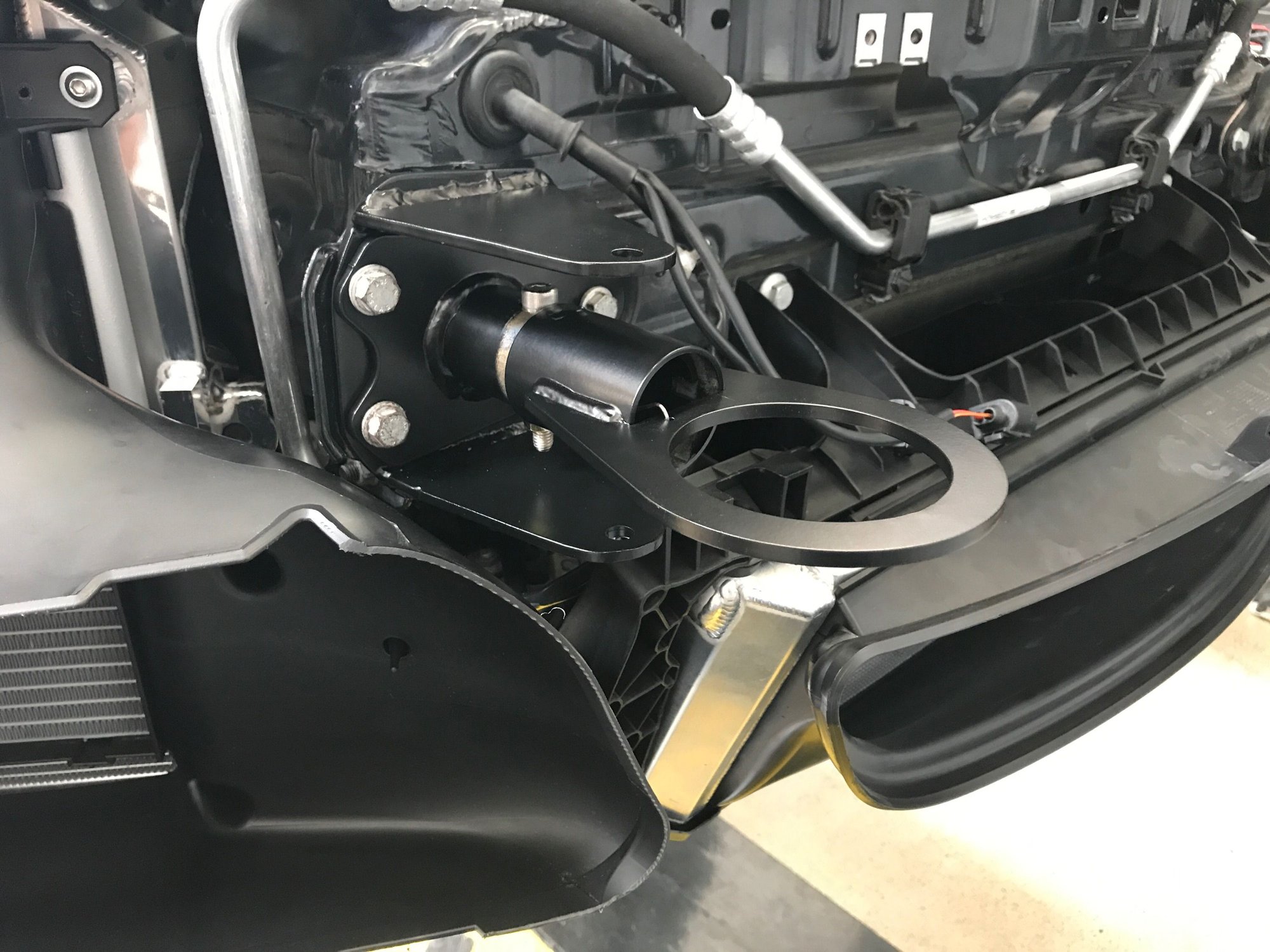

Old Jul 29, 2017 | 02:03 AM
  #72
VID997's Avatar
Joined: Mar 2010
Posts: 2,273
From: San Jose, CA
Rep Power: 193
VID997 Is a GOD !VID997 Is a GOD !VID997 Is a GOD !VID997 Is a GOD !VID997 Is a GOD !VID997 Is a GOD !VID997 Is a GOD !VID997 Is a GOD !VID997 Is a GOD !VID997 Is a GOD !VID997 Is a GOD !
Freshly powder coated tow hook and all new CUP shrouding with PWR 55mm IMSA spec radiators.

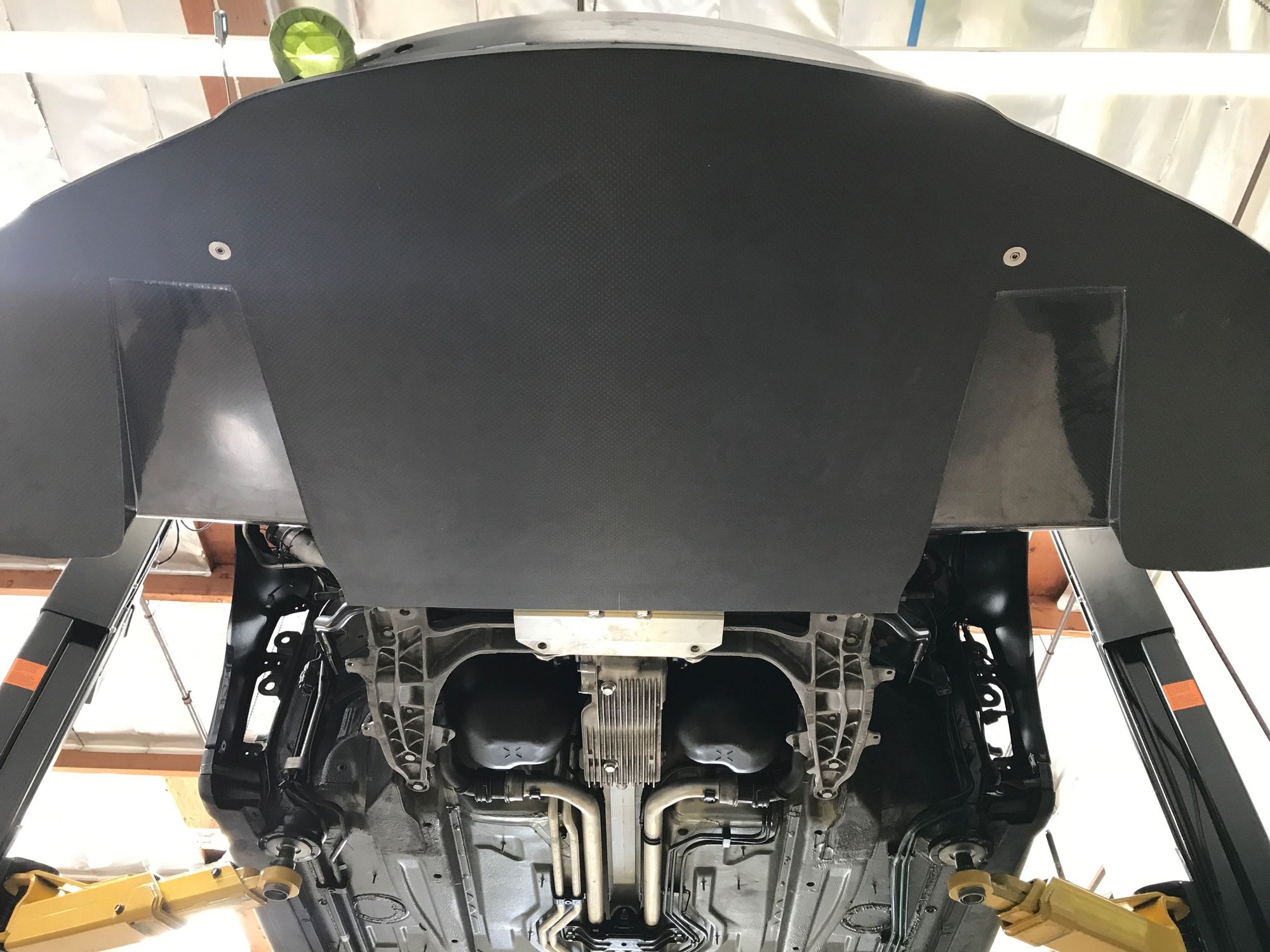

Old Aug 7, 2017 | 02:09 PM
  #73
VID997's Avatar
Joined: Mar 2010
Posts: 2,273
From: San Jose, CA
Rep Power: 193
Front splitter getting fitted....
