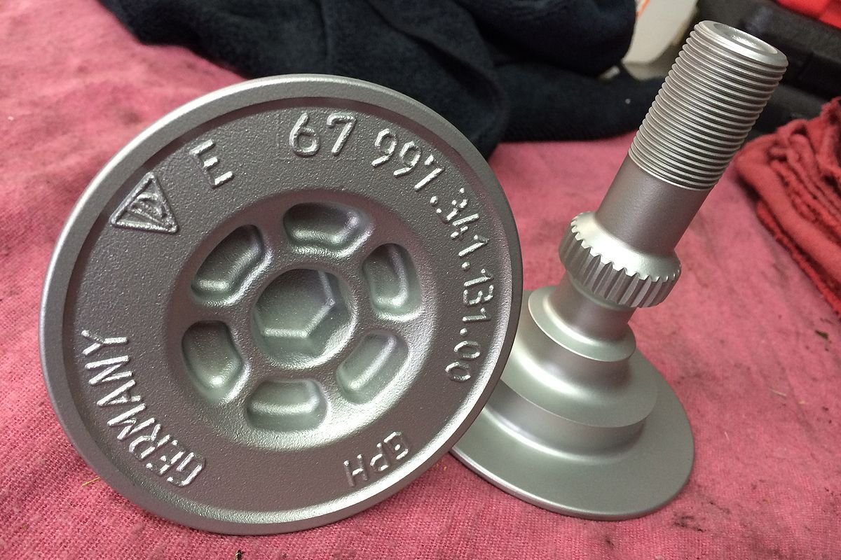

UPDATE:
Well, the new fuel cell arrived earlier today as did the GT2RS Axle Stubs!
Out with the driveshaft, left & right front axles, and then the differential!
Hopefully all will go smoothly. The vehicle should be ready for pickup Monday evening!

Are you changing out your front uprights also to the proper GT2/3 units? The reason I ask is that the GT2/3 tension bolts (aka axle stubs) are NOT compatible with the AWD front uprights. At least on a 996 they are not but I don't know about the 997. It's a bit of a moot point as you really wanna change the uprights to correct the front geometry and you're probably doing that anyway. Just curious.
