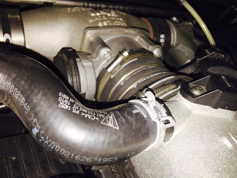

Can you pls post pic of the jubilee clip you're using to hold it in position? I'm using IPD 84mm plenum with High flow y pipe and GT3 throttle body and mines slipped off a few times with the OEM J clip which is too thin and doesn't clamp on properly - it needs something a bit wider.

Yes I have the 997.2 version of the plenum and Y pipe and like Chris says, I believe there are no choices, just one size.
Let me know if you still need me to take a pic of the clamps for you.

I had the clamp blow off also when I pressure tested the system. Replaced it with a high torque clamp. The stock is too thin for the silicone hose.

cheers guys can you post pics of the type of high torque clamps you're using on the car pls? OEM ones do not work.

Here you go

Thanks Longboarder. Those clips look OEM and your Y Pipe and Plenum are are held on nicely by them as they're smaller. If anyone with the same issue with 84mm Plenum can post pick much appreciated.

bump any pics of the stronger clamps used on the IPD 82mm plenum pls?

          Perfect. Did you use two and which size pls as there are quite a few to choose from? Thanks!

          I used them wherever I could. Boost hoses, Y pipe and throttle body. I couldn't get them on the plenum but I'm going to try to find some thinner ones for that also. The Size I'm not sure of because I got them from work and I just had a bunch of different sizes, sorry. We use them on boost hoses for diesel engines. You could Just measure the stock clamp and order that size. If you don't want to remove it to measure just wrap a string around and measure that. You can find them with google under high torque clamp. There about 5 bucks a piece. EBay may sell them also.

          Are you sure they'll work on the 82 mm plenum? Thats the only place I have an issue.

          I'm getting confused. The pic from longboarder showed the throttle body to y pipe and I thought that's what you were talking about . You can see in his pic he has wider clamps on the plenum to intake manifold hoses. I'm also guessing you have a .2 not a .1. I have a .1 and a slightly different set up. Either way it looks like those clamps will fit the .2. Mine may be a bit tighter and that is why I had a hard time. I will try again the next time I lower the engine. Sorry if I was misleading in my post.

          Sorry no I have a 997.1 running trick GT2 hybrids running more power so the hose keeps blowing off the Plenum to Y Pipe. You cannot have the larger 82mm plenum on the 997.2

          So we have the same set up. You are saying plenum to y pipe but its the throttle body that connects to the y pipe. That is why I'm getting confused. So yes the clamps will work. You have to play with the positioning of them and the one on the throttle body is a b**ch but you can work it on. Just use a 1/4" ratchet and extension with a shallow socket. Also clean any and all oil or grease from the hose and y pipe.
