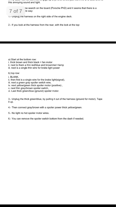

Just got the EBWERKS adjustable wing kit and they gave instructions on how to disable the wing button without programming. Basically jumping wires. But my question is has anyone done this? And does anyone have pics of the wires not sure which wires they are.

I just have the same system but still can't figure where is the wires? Anyone did this can shine some lights? Thanks..

Did u remove the air ducts on the engine lid to get the plastic piece off?

Sorry for the late reply, no I didn't remove that. Do I need to so I can see the wiring that needed to deactivate the switch?

No but when unscrewed the 4 bolts in the instructions the piece still didn't come out. How did u take urs out?
Take the fan off (4 bolts).
