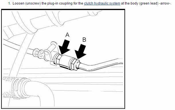

So before going down the route of changing parts I went ahead and double checked everything to make sure nothing was leaking. I looked under the car at the coupling between slave and engine reservoir and found that it was leaking again. This is most likely where it's losing pressure causing the pedal to drop.
The o-ring that was used was not an oem o-ring and my guess is that the pentosin is causing this o-ring to fail.
Does anyone know what the part number is for the o-ring that goes inside that coupling?
-Jose

So finally some resolution to this saga. I went ahead and used a power bleeder (motiv) using the instructions from porsche and that took care of the problem. It seems manually bleeding these cars is a ***** and requires a ****load of time so definitely the motiv bleeder is a godsend for clutch bleed as well. Some people had issues with reusing their motiv but the fact is that pentosin is water soluble so washing it off with water, soap and then alcohol removes all traces. I guess if you're that paranoid you can buy another one just for the clutch. They're relatively cheap for the hassle and time they save.
Thanks everyone for their input!
The moral of this is to always diagnose and not just replace parts on a whim.
-Jose
