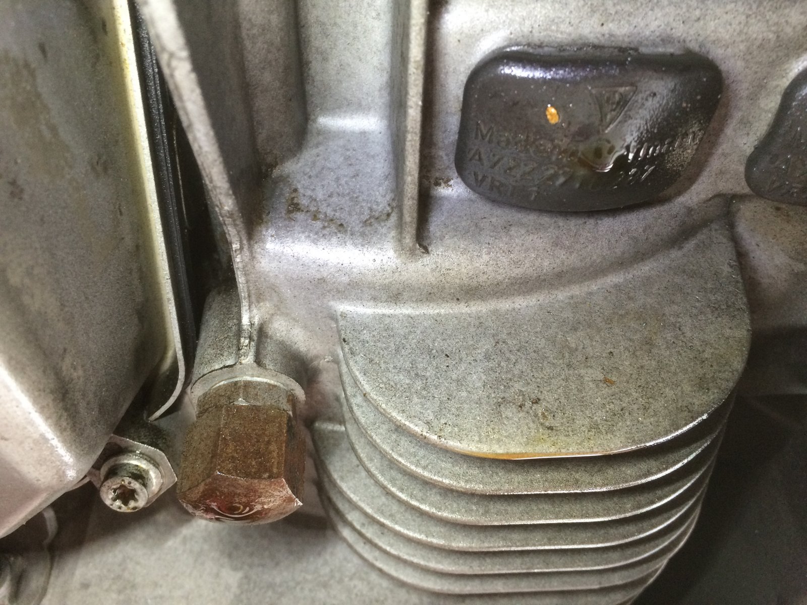

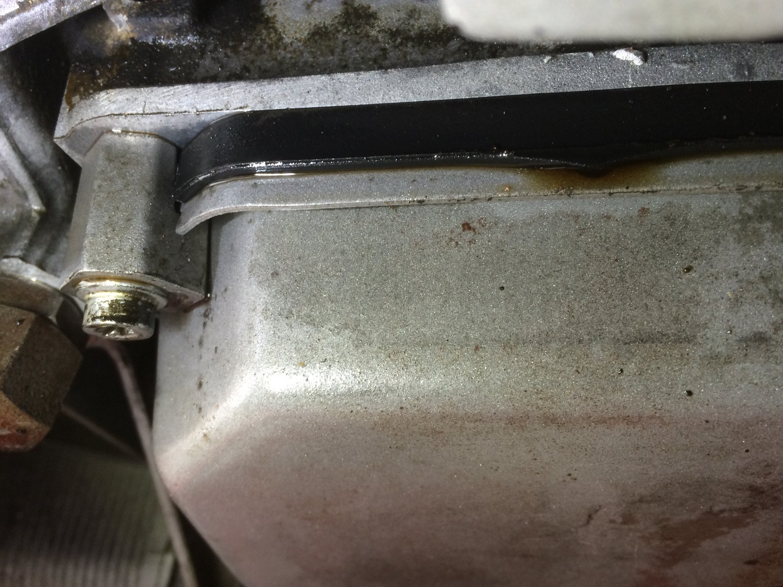

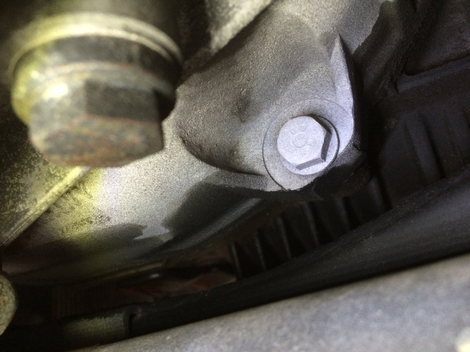

Tiptronic Gearbox, Oil Leak - 997 Turbo
My 997.1 Tip gearbox has developed an oil leak that my local Porsche service centre can't seem to plug.
They've replaced the sump gasket twice, but as you can see in the photos the oil is still finding its way out. I also suspect there's a minor leak between the trans and the torque converter.
My car is well out of warranty, so I'll be fronting the bill. The general consensus seems to be to get the box rebuilt, which then gives the options of upgrading clutch packs etc, although I don't plan on any major increases in power.
Would appreciate any guidance in this area.

Hi,
The tip box in the 997 turbo is actually a mercedes gearbox, 722.6.
I think there is no reason it needs to be replaced unless you find copper coloured metal in the fluid.
The leak could be from the plug adapter for the cable to the TCU. Other than that look online for mercedes with the same issue and you'll probably find tons more information regarding the leak. As i said the gear box code is 722.6.

Car is back in my hands. 5 hours of labour and $50 in parts, and the leak is no more. It was the connector as suspected. Thanks for the guidance!! Recommendation from Porsche was to drop the trans and potentially rebuild, which wouldn't have solved the issue and cost a ton. So glad I had a transmission specialist check it out. Appreciate everyone's help!
To anyone in Auckland NZ; if you have this issue, or any other with a tiptronic box, go to AutoTrans on New North Road. Highly recommended.
