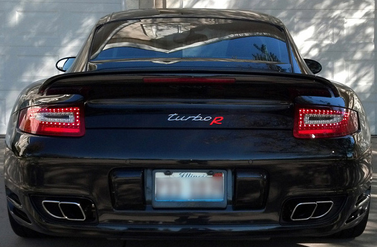

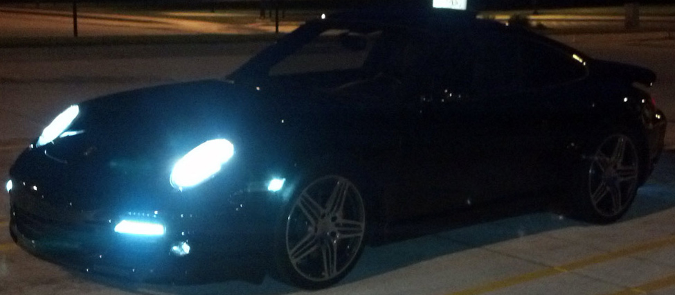

I have been pretty lucky with mine on LED's. I have replaced every bulb in the car with LED, except the HID Hlamps (I did change them to 6000K to match the bright white LED color). My Tails are the Depo/Dectane version.
Here are the rear tails and other LED's on mine. Yours definitely looks better with the amber removed...

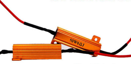

You can just swap out the bulbs, but need to get the non error CANBUS type, or install the resistors across each bulb wire...Like in the attached diagrams for you.
One thing to note though, is that white LED under the red lens will look pink, so there you should use red LEDs...
DC
I really like the look of the rear LEDs on your car. I seem to waver back and forth between getting them and not so until i make up my mind one way or the other this should work...
I've swapped out all the bulbs for LEDs inside/out - i love the full LEDs on the front lights instead of just the city light - i may go that route in the future as well
Thanks. I have been happy with them all so far. And I also did all interior and engine bay, and bonnet, and license plate! Not one Halogen bulb left on the car Good luck with your decisions...I think it really gives the car an upgraded, contemporary look.

For those who have replaced the stock turn signal with LEDs:
Can you recommend a supplier/part number?
I just bought a pair of "can bus" orange LED's from SuperBrightLEDs.com and they blink at the correct speed **BUT** I still get the dash error and the turn indicator on the dash blinks really fast (annoying).
The canbus was supposed to solve this issue. All other LED's I bought from them work just fine.

See my post above. You will have to use the resistors if you do not want the error message. Canbus or not.

Thanks for the reply! Can you recommend a supply/part number, please? I'm not big on cutting my factory wire so I'd want to make sure the resistors are REALLY going to work.
I bought a set of very highly rated (and expensive $50/pair) of can bus LED's off amazon and had the same issue as the superBrightLEDs.com.

For the splicing....Most unobtrusive approach is Posi-Taps. See here
Any of these resistors should work 50 W 6 Ohm(Car thinks it has a bulb with lumens causing resistance) . See Here

Thanks, DC! I can turn my own wrenches but things that spark aren't my forte. :-)
I appreciate it!
