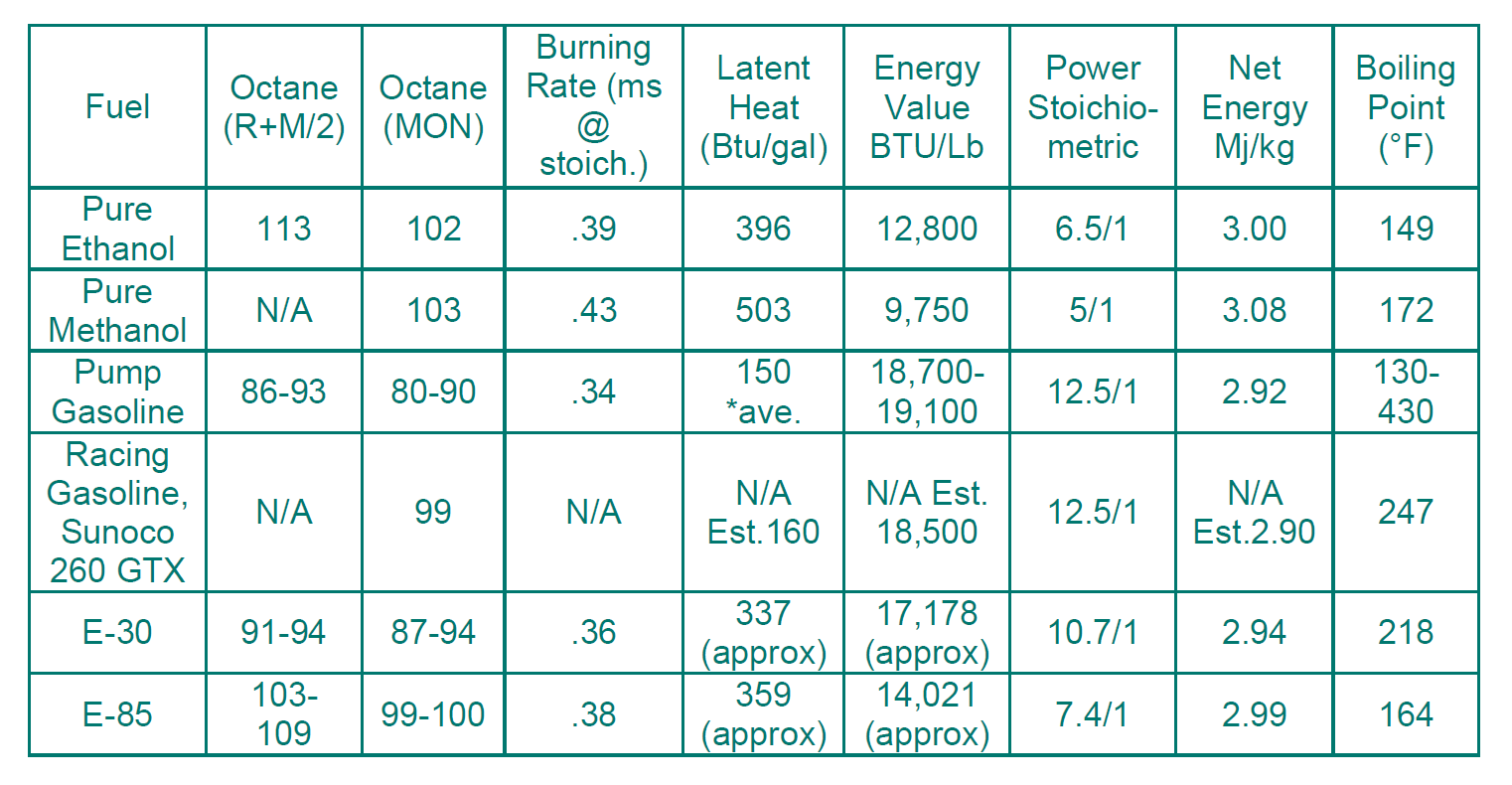

Tailwag, you may want to take the other posts in for advice. I'm still trying to figure this one out.
Comparing the performance rating of E70 compared to E90 just doesn't stand up to each other for me if you don't change your tune.
In my situation, I wasn't driving down the road with the eventually "floor the gas pedal," I was at the track with the pedal to the floor 70%+ of the time during a 30 min session.
Chart below may help with some reference. Cars tune will really dictate your E70 experience. I cant speak from a tuners stance though.
Freak, you may have more insight on this topic.
Name:	etho chart.png

If you've been tuned for a lower ethanol percentage say E60 you shouldn't really make a drastic change and go with E98 blindly without datalogging and looking over your fuel trims and fuel targets or reviewing your fuel pressure (if you've got a way to log it).
Depending on power levels and if your fuel system isn't built to supply the required volume/pressure you might end up with fuel starvation issues due to pumps being unable to supply enough volume to going leaner than target as fuel trims max out due to injectors not being set properly for your fuel.
