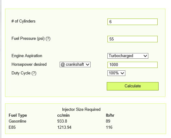

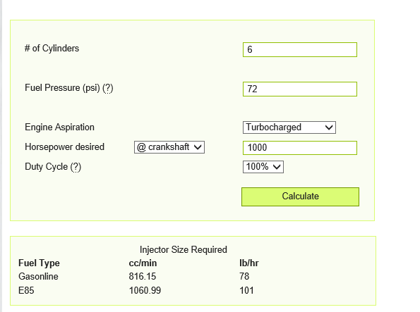

There has been Injector Talk on the forum lately. This specifically relates to E85 injector CC size.
I made the choice to install 1000cc injectors assuming that I keep the car below 1000 Crank HP. I recently came across a calculator that helps with this approximation. It may be wrong as it doesn't relate to a real life Porsche situation but,
Maybe a 5bar regulator is all you need to still be within range of your setup?
Thoughts on this? I don't know what capacity the stock pumps flow rate are rated at..
I posted this response today in this thread, please take a read:
https://www.6speedonline.com/forums/...0-130-a-6.html
In your calculations, you NEVER want to calculate 100% duty cycle (again read my post for the explanation), but for safety at 80% and if you are pushing it 90%.
BELOW #'S based on E85
STOCK 3.8 BAR FPR:
90% INJECTOR DUTY= 750-760BHP
80% INJECTOR DUTY= 660BHP
UPGRADED 5.0BAR FBR:
90% INJECTOR DUTY= 850-860BHP
80% INJECTOR DUTY= 750-760BHP
Old Jan 22, 2016 | 05:54 PM
STOCK 3.8 BAR FPR:
Good information Bobby!
Not sure why I thought 100% was max in this case for duty cycle. Guess I was in octane and intercooler mode at that time with a brain fart.
So can I just swap out the stock 3.8FPR for a 5.0 FPR and expect 80% injector cycle to delivery 750BHP?
