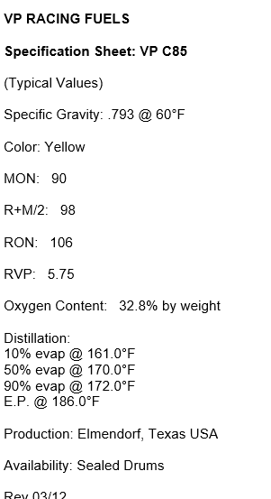

Originally Posted by LQQK
Be careful of vp c85 as it has MBTE in it. If your injectors are t stainless it can cause the injector seal to swell and you lose 30% plus flow
Methyl Tert Butyl Ether?
Where?

Originally Posted by elite1
Great post Rix!
Is there a standard with anything anymore?
Yes, there is a standard. The standard profit margin for the business selling you the fuel. Cold starts on E85 in cooler temperatures can be pretty tricky though. When it gets near freezing you need ~300% extra fuel to get it to light off. That's why they increase the gasoline in the mix in the colder months. I just take my trusty test tube with me and check it for fun at the gas station. I have had all kinds of strange interactions with people while doing this.
For example, there was the Porschephile who came running across the parking lot yelling at me to take the (yellow) E85 nozzle out of the car. It was horribly corrosive, and my car not being a flex fuel vehicle could not use it. Shame on me for trying to save money, didn't I know that you get much worse gas mileage with it anyway?
Then there was the guy who thought I was a terrorist and trying to set the pumps on fire because I put some fuel in my test tube and was looking at it funny. I guess he thought water + E85 = detonator.
At any rate, if you read all of that you deserve some information. YES C85 does have MTBE. *MOST* modern injectors are MTBE safe. ID1000, ID1300, ID1700, etc. are all MTBE safe. The only one you have to watch out for is the ID2000 which was originally a natural gas injector design (I think?) which is not MTBE compatible. An earlier post mentions something about "stainless internals" being necessary for MTBE compatibility - that's not actually true. It's the orings/seals in the injector that swell when exposed to MTBE that are the problem. All of the aforementioned sizes of Injector Dynamics (1000/1300/1700) are MTBE safe and not a problem. Since they are based on Bosch EV14 injectors, those are safe too.
Last edited by rix; Jan 23, 2016 at 01:41 AM. Reason: Added some useful info to my bantering.

Rix is correct on the injectors (id2000) and the bosche 160lbs that proto use don't like MBTE.
I learnt the lesson the hard way with c85 and 160lbs injectors. Now running the 1300cc injectors on e85 with no issues.
https://m.facebook.com/InjectorDynamics/posts/565285696856709
