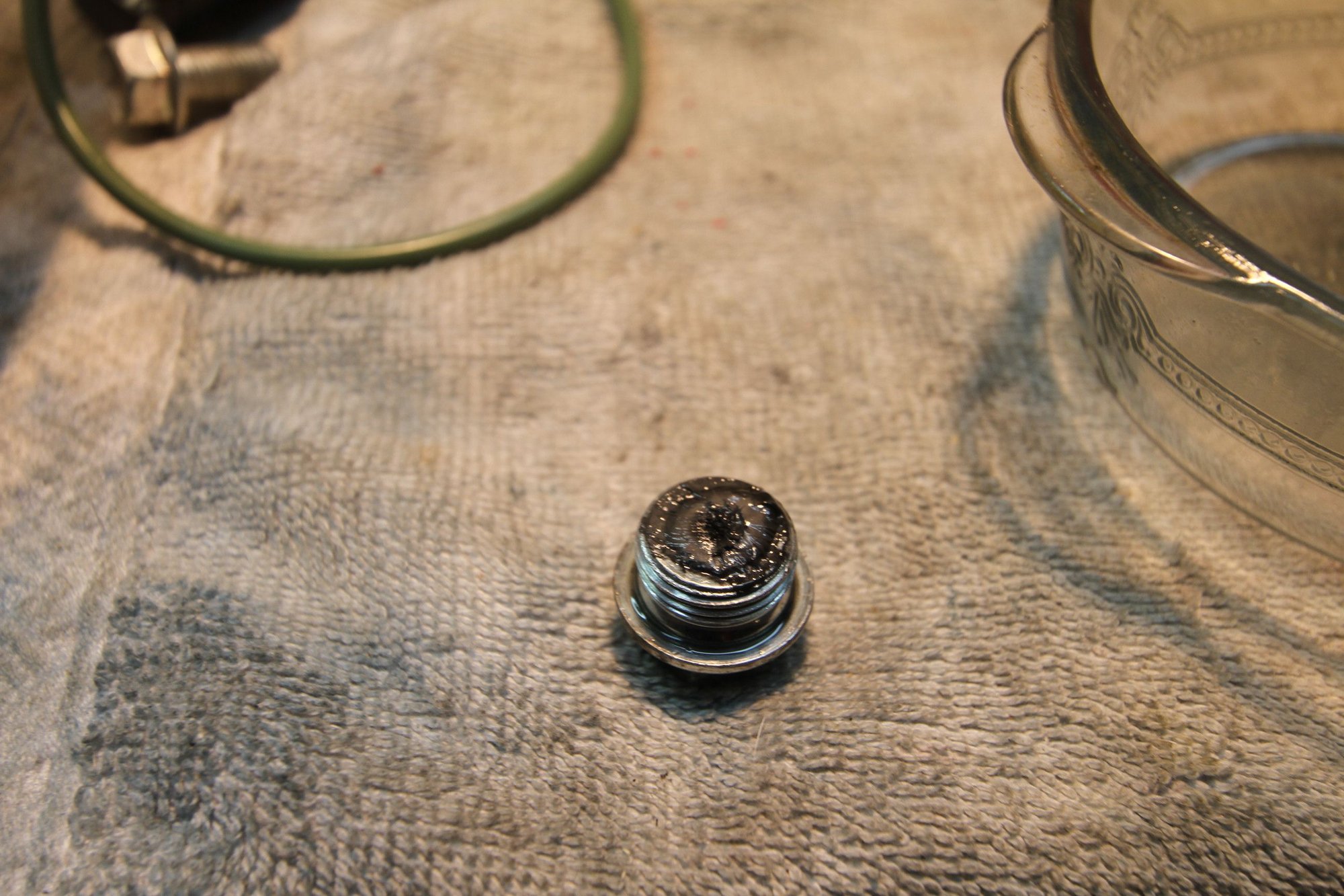

Both these bolts had not been removed since new and were very tight. Neither use crush washers. This is the drain plug from by front diff, not too bad I guess.

If you cant get this one loose, I would not worry about it. My oil came out clean as a whistle. The front one was much worse. No crush washers on these either and were very tight from the factory.

The front diff has two compartments, sone say the fluid is shared, I believe they are totally separate. I say this because the forward compartment fluid came out dark and nasty looking with a fare amount of metal on the drain magnet. The rear compartment was just like new with no sign of any metal on the plug. A post on this maintenance on the 997.1 referenced a photo cutaway showing the two compartments and referred to the aft on as a "wet clutch" housing. Either way, they both use the same 75w90 oil so, when doing one, might as well do the other. Use the money saved by doing the work yourself for tires I agree with the other post also, does seam to shift better. Cheers
