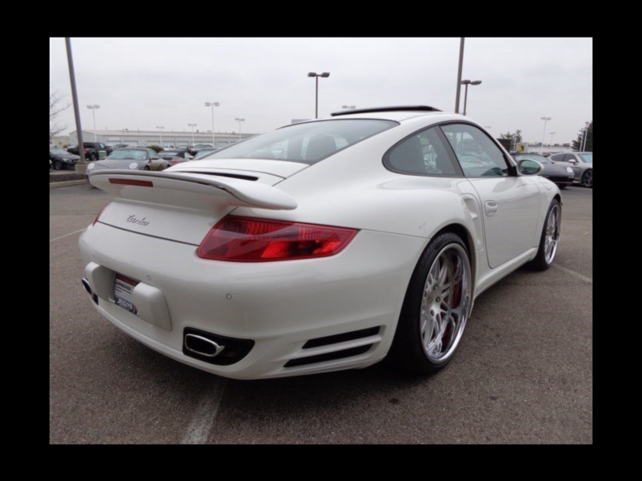

Found a few. I believe they are Klass wheels. They were measured from the ground with a tool for measuring. Discount also gave me those widths because I was not certain.

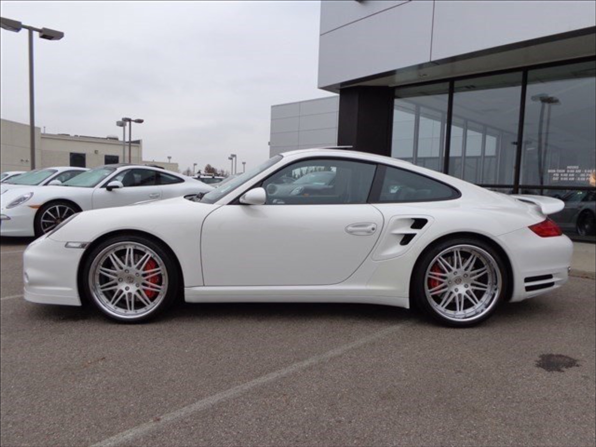

And another..
