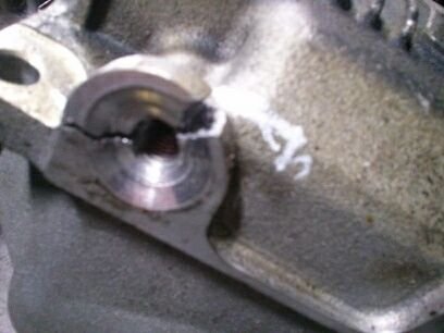

Well it's Day 2 and no real good news.
The used Diff that arrived, and once unpackaged has been shipped damaged.
As you can see the mounting point experienced some sheering, probably from a front end collision.
The part itself seems to function OK. It doesn't have the excessive play that my original part has, but we will only know for sure once it's in and tested.
I've decided to take it to a welding specialist shop and have them weld it up - for a whopping $400! Clearly welders make more then brain surgeons. Oh and there's no guarantee on the weld. The parts distributor has agreed to refund 250 US, which made the decision easier, as opposed to shipping it back and paying duties again (I'm in Canada).

Hmmm...not sure how strong the weld can hold. It seems a lot of stress into those mounting holes. I wouldn't take a chance but good luck if you have to.

So got it back and just went for a quick spin - everything seems ok.
Will thrash it around a bit harder tomorrow. So far so good.
Final result for repairing the mounting holes was just under 500. Crazy expensive. I'm guessing after the weld they had to re-drill and thread the hole, who knows!?
