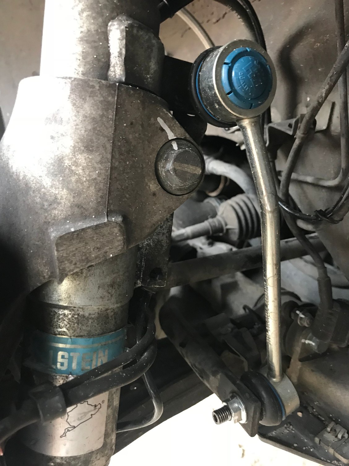

Hi Guys, sorry to bother you with this old thread... but i ve just installed B16 coilover damptronic pss10 , and i ve got some trouble with the Bilstein drop links.
My AD did the installation this way ( see pic2) using the instruction (pic1).
it seems to be different from what i ve seen overhere.
the problem is , i have clunking noise, once the car is Warm and au low speed ... it drives me crazy.
please help me !
