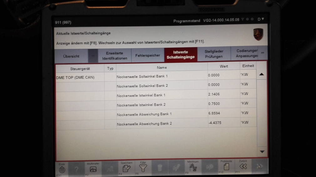

We made a log and got these datas:
Can anybody help me what this means?

The angle will vary as your rpms etc. fluctuate. What you would look for is that Bank1 and Bank2 are relatively in sync. That is, if Bank 1 angle is X, you would expect Bank 2
to be close to X.
From your PIWIS pic (I cannot understand German) the angles look way off, so definitely one cam is adjusting very differently.
